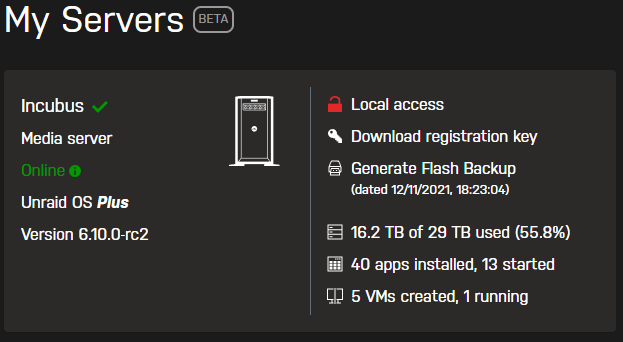

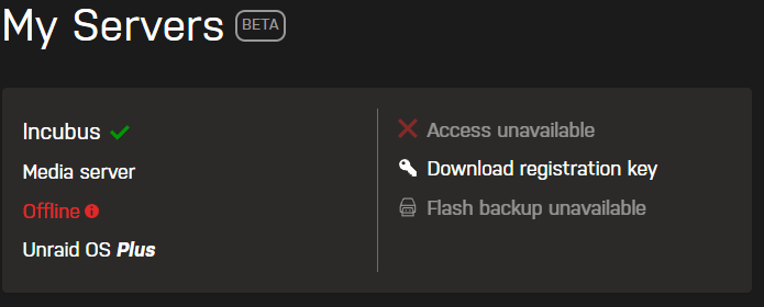

November 1, 20214 yr Same here today. FIrst Unraid told me the flash drive was damaged. Reboot, it went into Parity check. Cancelled it, now: And: Config is ok. Puzzled. EDIT: now it went online by itself after some minutes. EDIT2: reboot, same problem. It seems it takes age to be recognized by My Servers (or to say "hey, i'm alive"). Edited November 1, 20214 yr by dhstsw

November 2, 20214 yr Well, don't really know what's wrong. Every time i reboot i get: Then it *may* become avaiable, *if* it will after a lot of time. But that's not always the case. Also, aftere every reboot, all the setting for My Server are reset to default, so: I turn "Allow Remote Access" to Yes, apply, and after a reboot everything goes back to "No". I already tried to uninstall/reinstall. I was hoping that maybe after updating to Unraid RC2 thing would have fixed by themselves but that's not the case. I'm basically always like that: :(
November 12, 20214 yr So, today my WebUI tells me to sign in: I do so: And then it asks me again to sign in. And keeps going on like that. My Servers seems to work tho: EDIT: an unraid-api restart seems to have solved it. Edited November 12, 20214 yr by dhstsw
