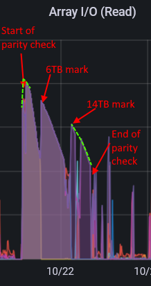

The speed on my last check were like that (18TB parity and one Data drive, several 14TB and two 6TB):
Ignore the drops, I was probably writing stuff on the Array. I showed in green, the theoretical behavior without me messing things up.
13 minutes ago, ChatNoir said:
As JonathanM mentioned, it should.
Sweet graph.  is that a plugin?
Just now, danimal86 said:
is that a plugin?
Several docker containers:
