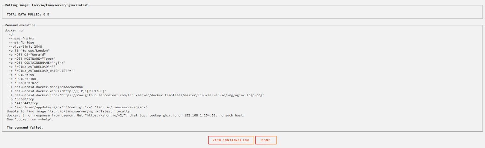

My unRaid server connects to the internet just fine.  Unraid Connect is installed and works just fine.  I'm able to download and install plugins.
However, I cannot install apps/containers into Docker. I keep getting "no such host" errors and the install(s) fails.
(Error message and sys logs appended below and diagnostics attached)
Any ideas or suggestions?
Thanks!
12/23 Update:
Apparently this a DNS settings issue and adding two external public DNS servers in Network Settings fixed the problem. 🙂
Per Unraid support:
In Unraid Network Settings
(1) Enable Static DNS addresses
(2) Add as #1 DNS: 208.67.222.222
(3) Add as #2 DNS: 208.67.220.220

docker run
  -d
  --name='Home-Assistant-Container'
  --net='bridge'
  --privileged=true
  -e TZ="America/Los_Angeles"
  -e HOST_OS="Unraid"
  -e HOST_HOSTNAME="SVR1"
  -e HOST_CONTAINERNAME="Home-Assistant-Container"
  -l net.unraid.docker.webui='http://[IP]:[PORT:8123]'
  -l net.unraid.docker.icon='https://raw.githubusercontent.com/balloob/unraid-docker-templates/master/balloob/home-assistant-icon.png'
  -v '/mnt/user/appdata/Home-Assistant-Container':'/config':'rw' 'ghcr.io/home-assistant/home-assistant:stable'
Unable to find image 'ghcr.io/home-assistant/home-assistant:stable' locally
docker: Error response from daemon: Head "https://ghcr.io/v2/home-assistant/home-assistant/manifests/stable": Get "https://ghcr.io/token?scope=repository%3Ahome-assistant%2Fhome-assistant%3Apull&service=ghcr.io": dial tcp: lookup ghcr.io on 192.168.200.1:53: no such host.
See 'docker run --help'.
The command failed.

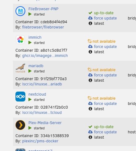

    Hello, I can't install applications, mainly from linuxserver. But now I used main dns 8.8.8.8 and I was able to install. But something is wrong, because I had my default gateway before the unraid

Try setting static DNS addresses in your server (Settings - Network settings). Use 208.67.222.222 and 208.67.220.220 and see if that makes a difference
That did the trick, its working now. Although I never had to set Static DNS before so i still dont really understand what happened.
Thank you! :)
There's no telling what dns an ISP points a customer at; most likely the one that pays them the most. You probably landed on a lesser one with your new isp. OpenDNS is a good one (arguably the best) which is what Squid pointed you towards.

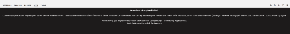

Hi all. I need help with apps.
I've had this error for two days now:
Download of appfeed failed.
Community Applications requires your server to have internet access. The most common cause of this failure is a failure to resolve DNS addresses. You can try and reset your modem and router to fix this issue, or set static DNS addresses (Settings - Network Settings) of 208.67.222.222 and 208.67.220.220 and try again.
Alternatively, you might need to enable the Cloudflare CDN (Settings - Community Applications).
Last JSON error Recorded: Syntax error
  1. I changed DNS:
  1. I put it: "Use CloudFlare CDN: YES"
  2. I rebooted my router.
  3. I changed browsers, tried incognito mode.
But nothing helped. I have internet access from the server, but I can't open the app list.
I will attach the file: "CA-Logging-20260723-2019"
