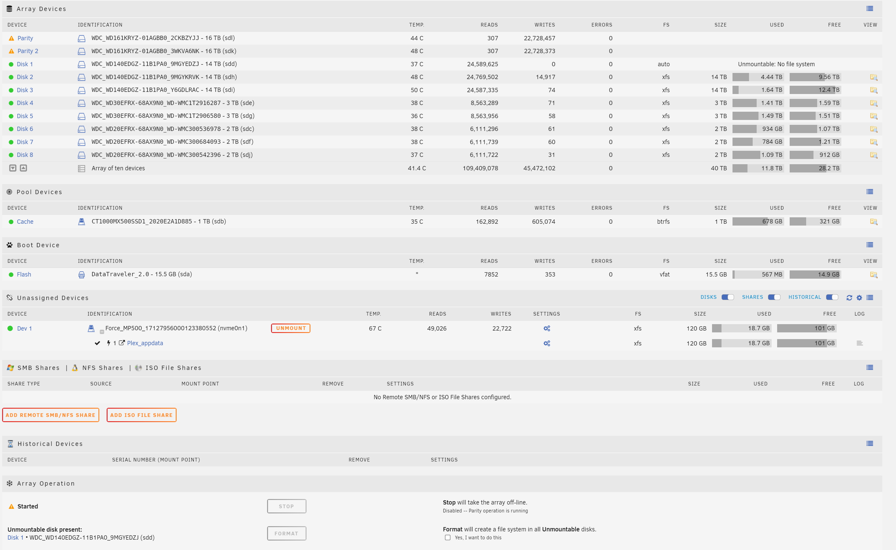

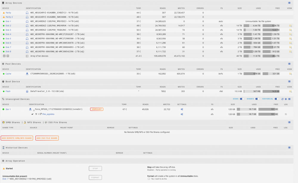

It says the 14tb i installed is Unmountable: No File System.  I figured it would do that since is used to be a parity drive and now is a data drive.  I see the format option at the bottom below Stop the Array.  Is it safe to do this while a parity rebuild is happening?
Yes.
13 minutes ago, JorgeB said:
Yes.
Thanks!  I'll start the format!
Once its done with the format, it'll show up in the array automagically?

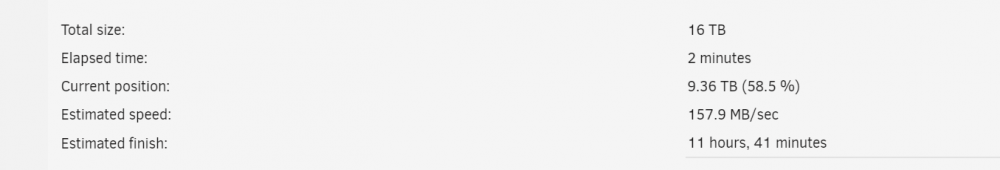

1 minute ago, JorgeB said:
Yes, it pauses for a few seconds (couple minutes max) or the format would take a long time, and disk will be available after the format is done.
Thanks!  It looks like the rebuild counter restarted, but current position shows the rebuild is still going strong:
