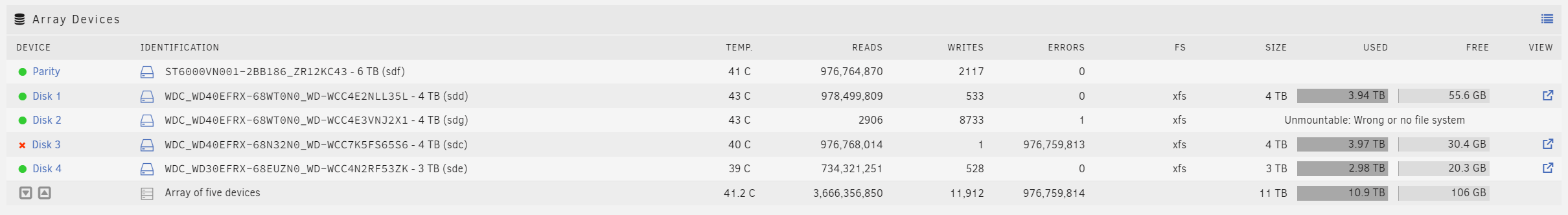

So, currently I'm in position that Disk 2 was supposed to be rebuilt (rebuilt process finished in maintainance mode, everything was in green), but after I launched the Array in normal mode, I'm having now:
Disk 2 - Unmountable, wrong file system (despite the 4 days data rebuilt process for the 2nd time during last half-year)
Disk 3 - DEVICE IS DISABLED, CONTENTS EMULATED - now and this one as well...
But while the content from the disks is unprotected (with exclamation signs), it LOOKS like it exists, it's OK, I see that my biggesst, most important folders / file are OK.

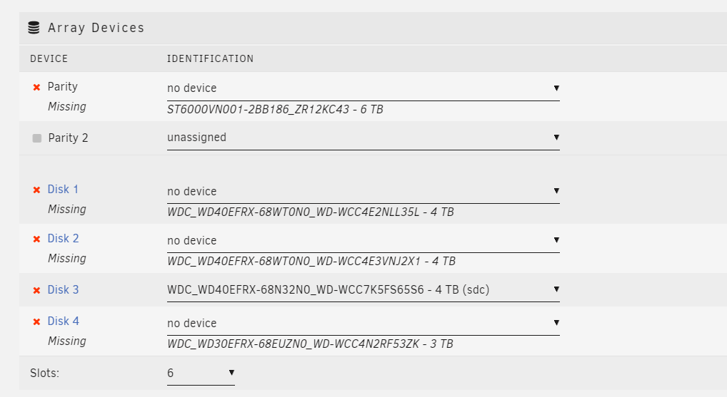

After reboot, I'm getting this.
No changes in hardware config was implemented...
The majority of the disks are "missing" now.  Avialble drives were the drives connected directly to the motherboard, so I've replaced the Raid controller with a new one (I know I 've installed not recomended Marvel one as a reserve one, but now for the sake of the data restoration / disks swap I suppose I can use it temporary). Btw, the previous controller is also a Marvel (this one http://www.iocrest.com/index.php?id=2208).
With new controller, Array started with similar status: Disk 2 umountable FS, Disk 3 disabled.
diagnostics-Controller_failed_20230423-1436.zipdiagnostics-After_Disk2_checkFS_20230423-1518.zip
