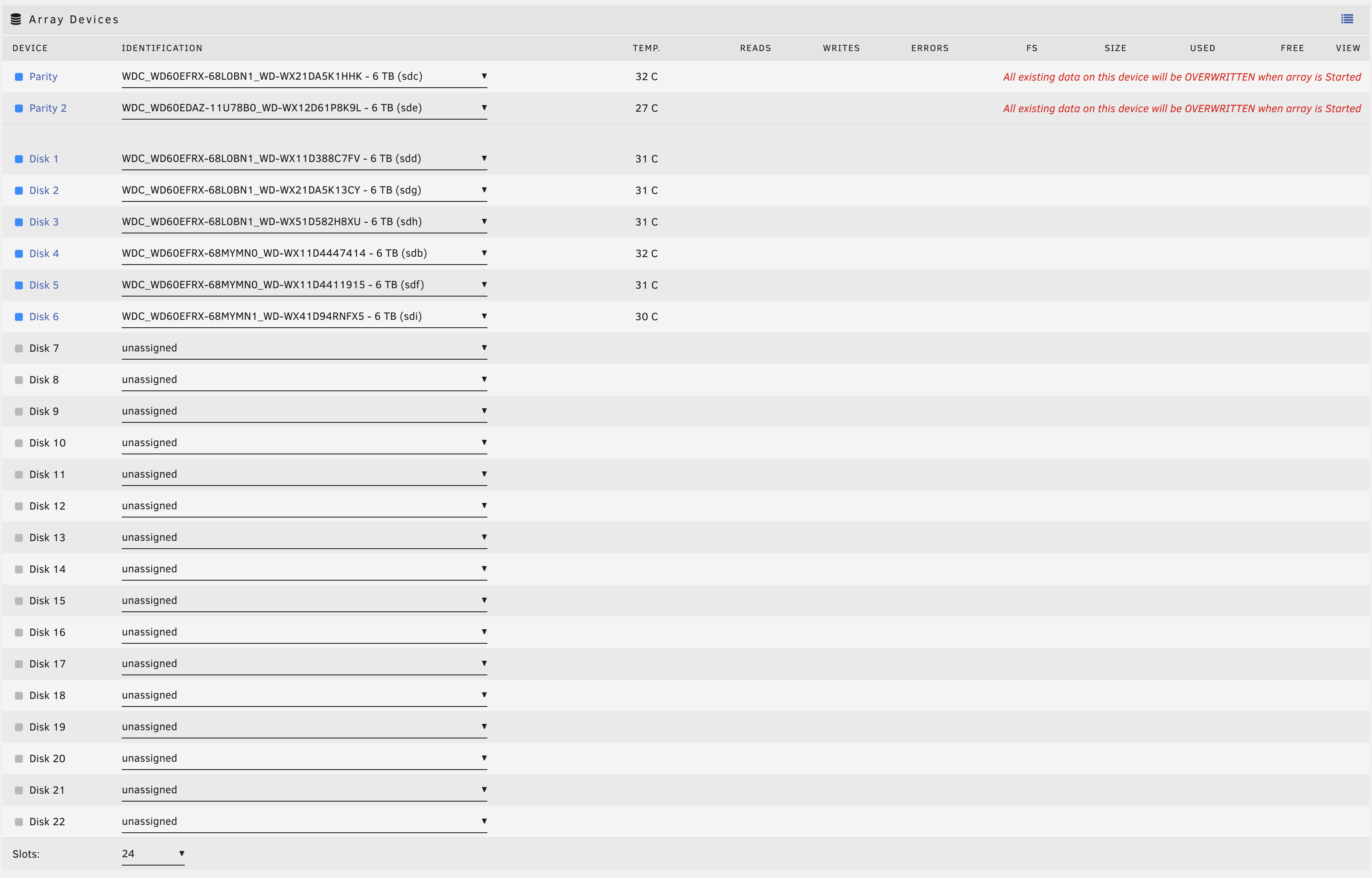

Devices before I assign them:
56611393_CleanShot2022-02-24at15_52.21@2x.thumb.png.af0b76e9a64d5a0f56d4afeeb881b1d6.png

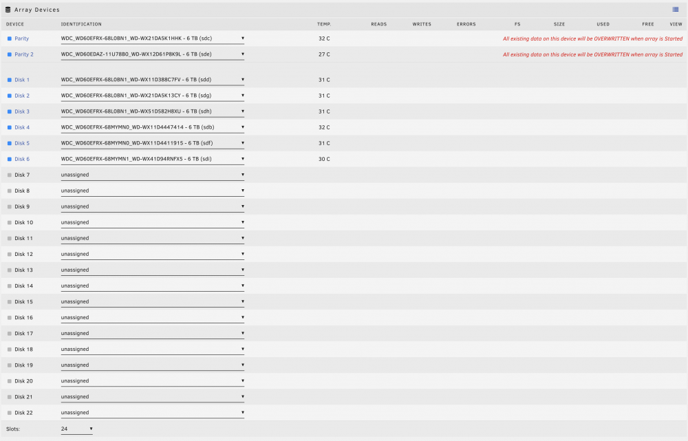

Devices after I assign them:
64352533_CleanShot2022-02-24at15_59.58@2x.thumb.png.27b9754a811dada64e6b8cec01f90632.png

@itimpi Just to make sure I understand...
The data in the parity drives isn't essential to keep all the data in the other drives.
So put the drives in any order and rebuild both parity drives
All the data in the other non-parity drives will be fine as long as none of them fail during the parity rebuild?
