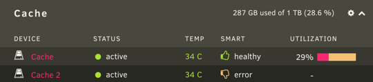

Success! So I have the server back up and it looks to be working as it was prior to the "issue" with one exception. I have errors on my 2nd cache drive (refer attached image). I think that drive may be on its way out??? I better look at how I can undertake some diagnostics on the drive to get a definitive answer as the drive is currently still under warranty.

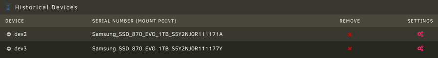

Another thing I noticed was a new section on the Main tab called Historical Devices (refer attached image). Does anyone know what this is and should I just delete these OR do I need to do something with this detail?
That's a SMART warning, might or note be serious, need the SMART report.
That's from the UD plugin, you can remove them from there, or toggle the historical devices button to not show then.
This is in the Unassigned Devices plugin. Certainly useful to manage plug and play devices that you use often for backup etc.
In you case, not so much. I think you can simply hit the X to remove them.
Difficult to say.
Attach your diagnostics to your next post so someone can look at it and provide an advice.
Acknowledge current SMART attributes and keep monitoring, it's showing some issues but nothing fatal for now.
