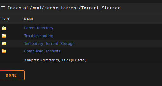

I want to  download files to be the cache_torrent drive that has a share created named "torrent_Storage". I do not want these filed moved to my array via Unraid's mover. I have Emby installed and I want Emby's Auto Organizer to move the files from a "Completed_torrents" folder on the "torrent_Storage" share to the correct folder on a  share called "holodeck" on disk1.  I have "torrent_Storage" share set to "only" on the "Use cache pool" currently b/c i do not want mover to move these files for any reason on the cache_torrent drive or any share on that cache drive. (probably change the cache setting to "prefer" as ChatNoir suggest after I figure out whats going on here.
Here is the file structure on the "torrent_Storage" share;

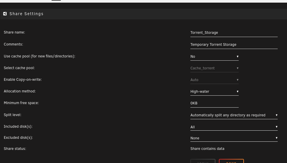

but what is happening is when I copy or move a file to the "torrent_Storage" share, unraid is also copying the files to my array using the same file structure as the "torrent_Storage" share. Unraid is moving the data to a location on disk1 outside of my share "holodeck" on disk1.
I am not really understanding what unraid is doing behind the scenes. Any help would be appreciated. I want to learn what I doing wrong here and how to correct my thinking about how Unraid works/should work. Let me know if more information is needed.
According to your screenshot you have the Torrent_Storage share set to NOT use the cache so Unraid is (quite correctly) writing to the array.   If you want it only on the cache it needs to use the Only (or Prefer) setting for Use Cache Pool.  Note that if you change this setting it only applies to new files.
Thank you sir.. what a dumb oversight.

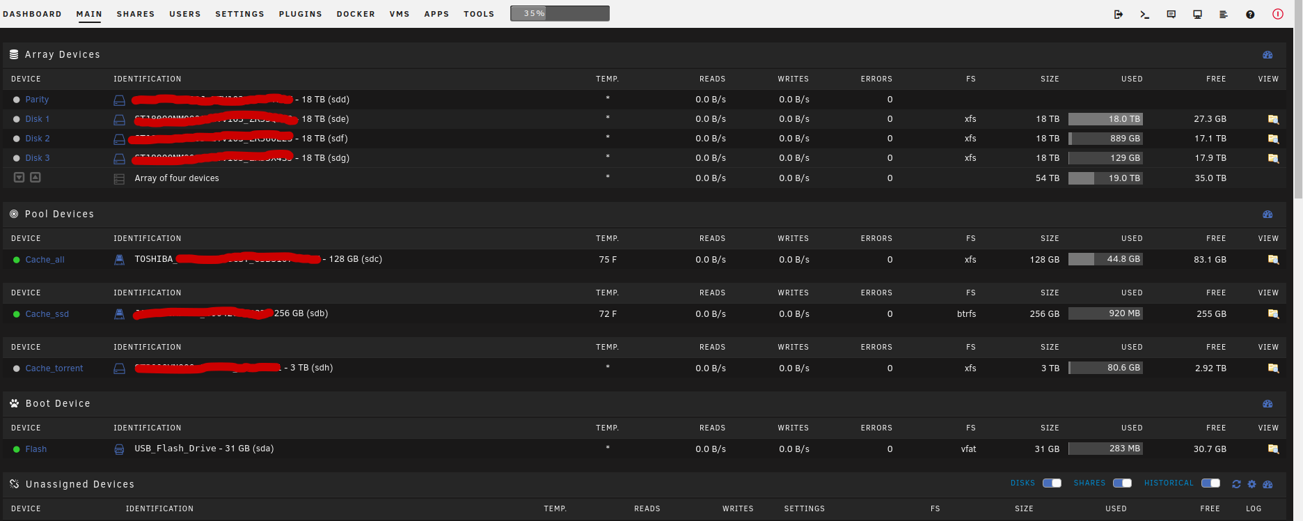

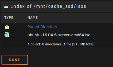

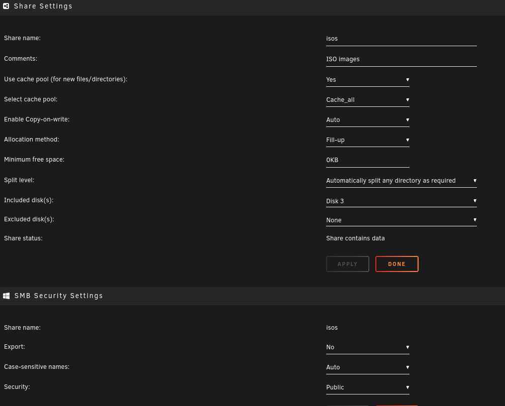

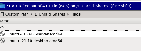

One other issue has come up and I am sure it is something simple that I am over looking. I have a "isos" share set up and I have it set on public (as shown in the screenshot below) and  the cache pool for the "isos" share is pointed to "cache_all" pool and the array storage location is on disk3 in a share called "isos".
Even though Krusader shows the two isos that i do have downloaded in the "isos" share location: one of the isos are located in a totally different cache drive (cache_ssd). Is it obvious to one of you guys why this happened? i am sure this is some setting I have wrong again.
Also, why doesn't the "isos" share show up as a SMB share like the rest of my shares as I have it set up to be public? is it because export is set to no " the share settings for "isos" share?
