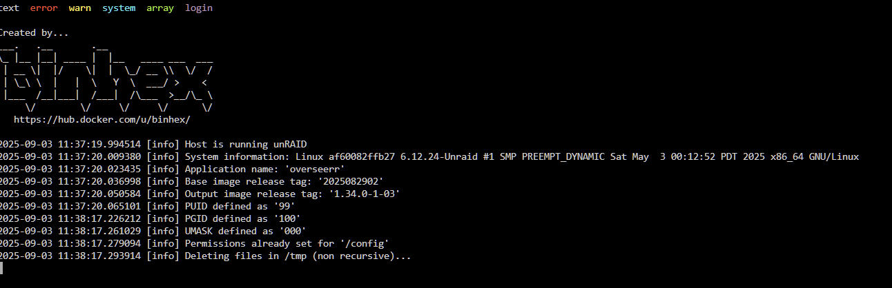

2025-09-03 01:44:38.012589 [info] Host is running unRAID
2025-09-03 01:44:41.381686 [info] System information: Linux e9c058e6a3cd 6.12.24-Unraid #1 SMP PREEMPT_DYNAMIC Sat M
2025-09-03 01:44:41.400203 [info] Application name: 'overseerr'
2025-09-03 01:44:41.417243 [info] PUID/PGID: '99'/'100' -- '2025082902'
2025-09-03 01:44:41.440686 [info] Output image release tag: '1.34.0-1-03'
2025-09-03 01:44:41.541130 [info] PUID defined as '99'
2025-09-03 01:44:41.570094 [info] PGID defined as '100'
2025-09-03 01:44:41.619068 [info] UMASK defined as '000'
2025-09-03 01:44:41.642998 [info] Permissions already set for '/config'
2025-09-03 01:44:41.675307 [info] Deleting files in /tmp (non recursive)...
