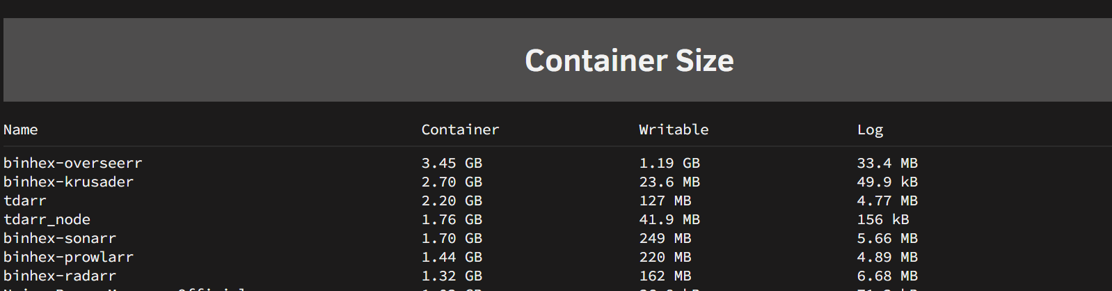

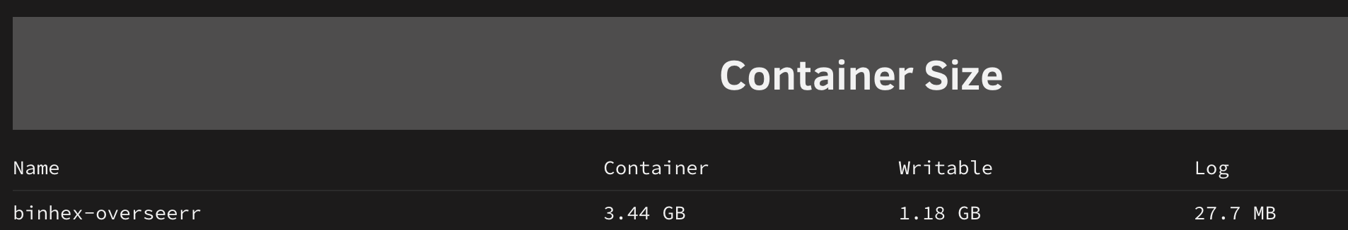

@rs5050 Were you ever able to figure out what was causing your container size to be so large? I seem to be running into a similar issue, my container is using up 3.44GB, which seems large.

Yeah, seeing the exact same numbers for container/writable size, it's 2x as big as any other docker I have running.  Seems way too big for a docker that shouldn't be storing any large data (media or large files).
You might want to check your log settings, 340MB worth of logs is a TON of logs, lol.  Mine is <30MB

same here. but i also think the other are pretty big.
for example i just installed krusader a few hours ago and it is pretty big. i am wondering if these should be that big?
The base OS i use is not optimised for docker usage (rolling distro for a start) thus the images are larger than other base OS's such as Alpine, but there are advantages too. In short there is nothing i can do to optimise the image over what it currently is, do keep in mind though that the size shown in the screenshot is not the size you download on update (or size on disk), firstly its compressed and secondly and more importantly there is sharing of layers, its typically more around the 450MB range.
If it really annoys you then the only option is to switch to another image, LSIO use Alpine so the container size will be smaller.
