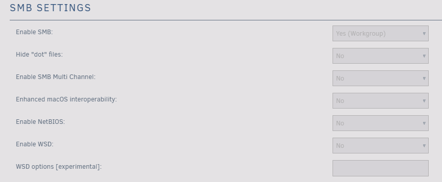

July 27, 20224 yr On 7/26/2022 at 4:40 AM, weirdcrap said: This server is getting rebuilt with all new hardware next month so I'm trying to just keep it coasting until then, see if the new hardware magically resolves any of the issues I've been having. Problem doesn't look like any hardware relate, anyway pls try two thing 1. Ping -4 google.com success or not 2. Disable Netbios in SMB setting

July 28, 20224 yr Author @Quick_FOXmy resolv.conf is intact with docker running. @SquidI can give the RC a try. It's difficult for me to diagnose as it seems to happen randomly. Maybe once a month or so. I will also disable NETBIOS as suggested. EDIT: Waiting on trying the RC until NerdPack gets updated as I need several of the tools it offers. Edited August 1, 20224 yr by weirdcrap
October 4, 20224 yr Author I'm still having issues with this. Netbios is off and I'm on the latest 6.11.0 ping -4 google.com worked but so did ping google.com immediately after so I assume it's just the issue fixed itself again. It doesn't seem to be as permanent as it used to be. If I just wait 5 minutes DNS will just start working again. Edited October 4, 20224 yr by weirdcrap
