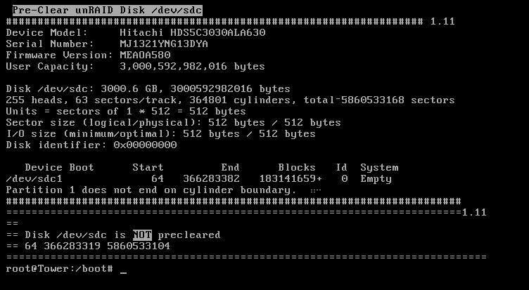

@Joe L.
I was running 1.11 :-(  Have downloaded 1.12beta now and will see how I go.
I ran pre... -t /dev/sdc (another drive already precleared by 1.11) and it didn't find a valid signature (see attached image) - I'll obviously have to redo every drive, no problem.  As the 6 drives all reported absolutely no problems (1 pass), I might use the -n switch to skip the pre/post reads on those drives.
I'll contact BJP999 re: the drivedb issue, thanks.  Many things are in flux at the moment with the new versions of unraid, support for 3TB drives etc.
