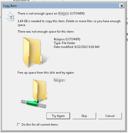

Here is the recreated scenario:
We are expecting the files being copied to use the array, which has enough storage.
Other notes:

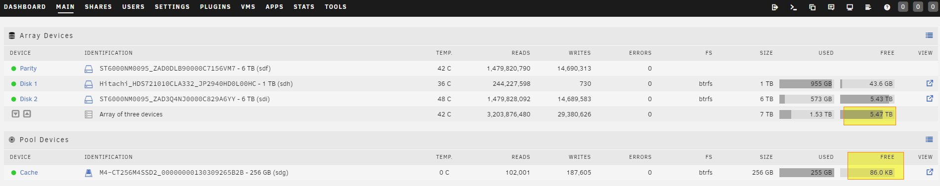

1) The cache drive says 86.0 KB free, which is below the minimum limit of 100MB.
2) I'm surprised the guest OS doesn't recognize the file being copied is larger than available space, and prevent the transfer.  I'm not sure if/how Unraid reports available storage to a guest OS.
3) The file copy action will keep repeating over and over, automatically retrying, and constant read/writes.

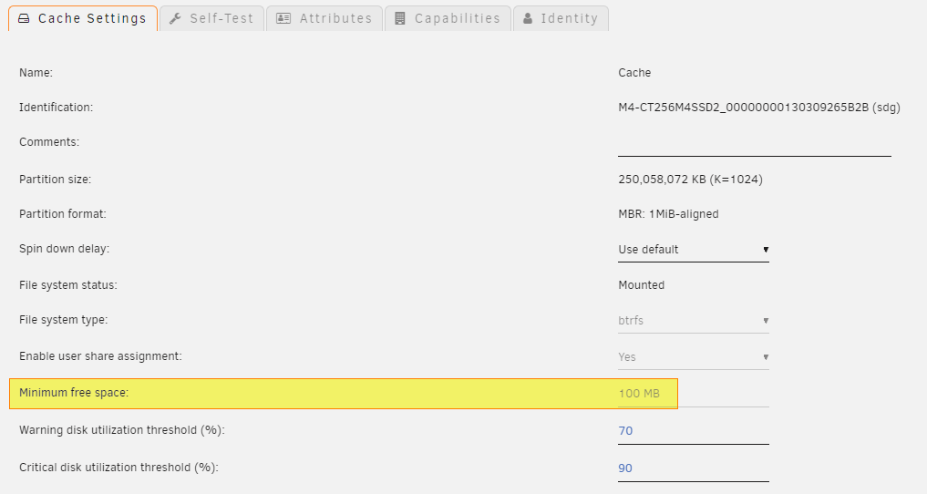

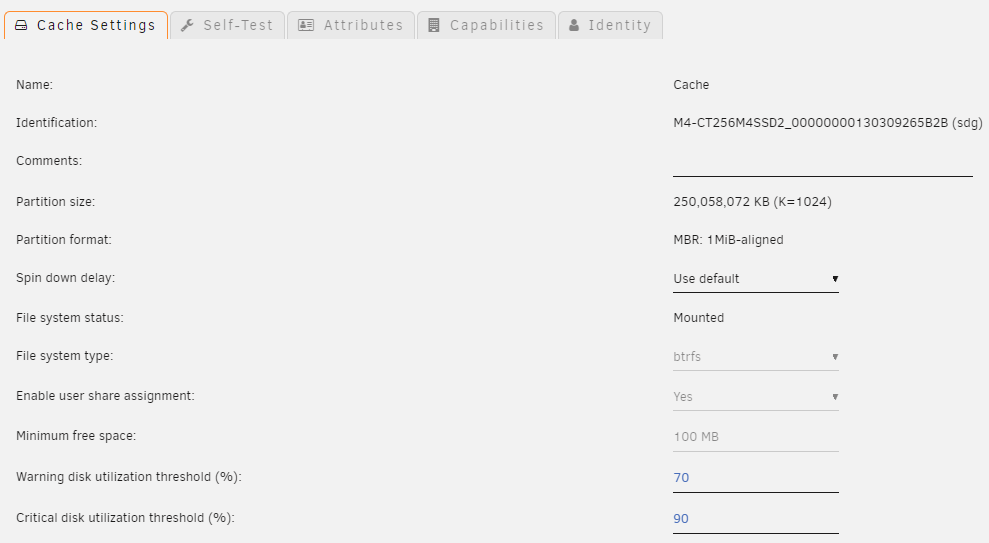

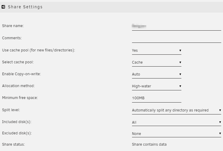

Ok, Looking at what you posted. You set your share Limit to 100Meg. Did you set your Cache Minimum space to a larger value than 0? it needs to be higher as well.
Share limits are designed to make sure drives that are low send files to other drives in the array.
I don't know why your SSD wouldn't follow those rules too since its kinda part of the Share, but not part of the Protected Array
You need to go into your SSD settings, by clicking on it and look at the Minimum Space. I bet its zero. You need to stop the array and raise its value too.
Yes, 100 MB.
Just a thought - have you checked that there is not an (incomplete) copy of the file already on the cache from a previous failed attempt?   If Unraid finds a file already exists it will try and update in situ and thus use the drive it exists on regardless of the other settings.
The above is likely your issue. Say you set free space to 100M, there is 200MB free, your client sends a 300MB file - There is less than the minimum free at the start of the transfer so the file gets put there but it's too big so it fails part way. But now that file is there so every subsequent retry will still try to update it in place but that'll fail since it's still too big.
A sensible Min Free space is more a few tens of GBs than 100M. It should be higher than the biggest file you're expecting to be sending.
