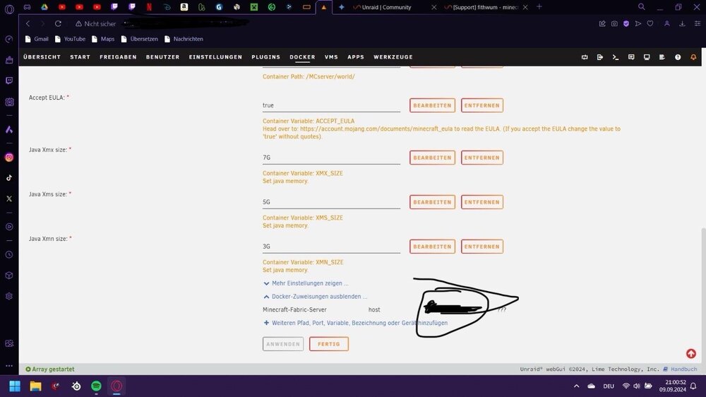

Hi there. I have been on an incredible unlucky journey to getting a fabric server up and running. I've been running my own vanilla server for quite some time, but this is really kicking my butt. I've gotten used to using the Console by just selecting it in Docker, but your version is missing, so I'm trying to use the rcon capabililty. I've downloaded mcrcon and every time I try to connect, it says connect failed. This is on a local server with all the defaults. In the server.properties, I've left the rcon.password=minecraft and rconport=25575 defaults, but still no luck.  What am I doing wrong? As silly as this is, I'm trying to give myself /op so I can run chunky commands at the server level.
I have been working on getting the console working, but i have no idea why your rcon is not working you could try connecting with putty and see if that helps.  also check that the ports are forded correctly.
if that still is not working what i did at one point is just make a minecraft server on my desktop and add ops that way then move the ops file over to the server

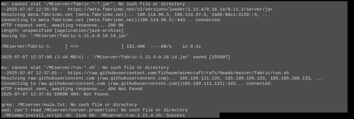

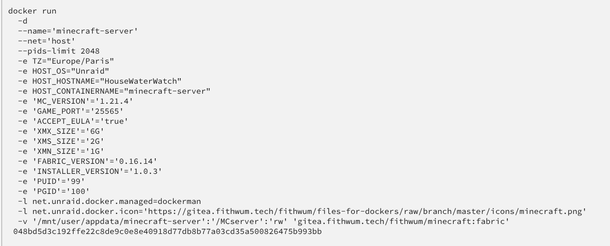

Hi i'm not able to install the new version of minecraft-server and the old one is broken (i had broke it trying to update).
It seems there is something wrong with the creation of files. I'm trying to install a fabric instance, just like the old one that i really loved it.
Thank you, i will appreciate any kind of help.
this are the logs of the unraid docker:
sed: can't read /MCserver/server.properties: No such file or directory
./MCtemp/install_script.sh: line 98: /MCserver/run-1.21.4.sh: Success
INFO ! fabric-1.21.4-.jar found starting now.
INFO ! run-1.21.4.sh found ... will use existing file.
INFO ! Setting game port.
INFO ! Starting Minecraft Server 1.21.4
Press ANY KEY to close this window
after that, it just crash.
Edited by Calaat
I'm following exactly what you are saying, and the result is the same.
I've tried again and i haave this, all over again.
Maybe, something is not working? i'm the only one with this? it is the new template, but i have tested with the old with the same result.
I've been using your template since almost two years now. It was the first one and my prefered because of the autopause feature, and it is easy and well done. I have reinstaled it a huge amount of times and i have never seen this message before (the second shot). I'm pretty sure something is wrong with the fabric image (i'm not talking about the eula, it is the same with the eula)
If i overwrite the folder with my old minecraft folder, it doesn't work neither. it says:
Edited by Calaat
i have found the problem there was a link that i hadn't changed and it was not pulling the correct files. there will be an update shortly
