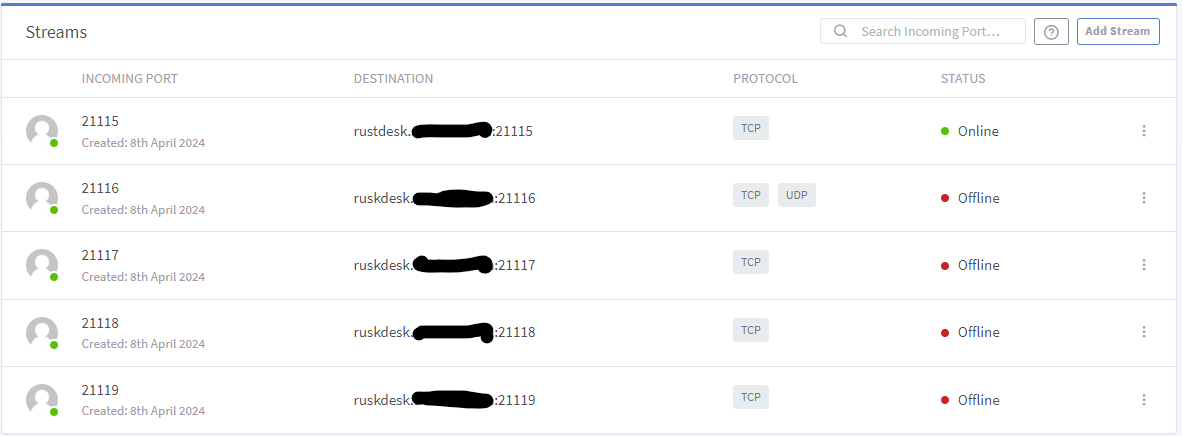

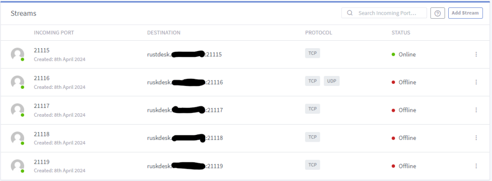

Hello! I am new in rustdesk.
i installed rustdesk server and rustdesk server relay.
Protocol data seems to b ok.
I have a tunnel working with nginx proxy manager.
I don't know which port to use in the proxy manager!?
And i cannot connect to my server installation.
I ve done this server installation in unraid via the app store and i also tried the installation with docker compose.
Same problem -> No Connection.
Is there someone out there woh can help me?
Link to comment
On 10/12/2022 at 2:10 AM, Kilrah said:
It's not an HTTP app so no proxy. I've got both containers running with Host networking and directly forwarded ports 21115-21118 to the server and all works fine.
I just did a CNAME to duckdns like I do with all my other apps and then just opened the ports on the router. Everything just magically worked.
