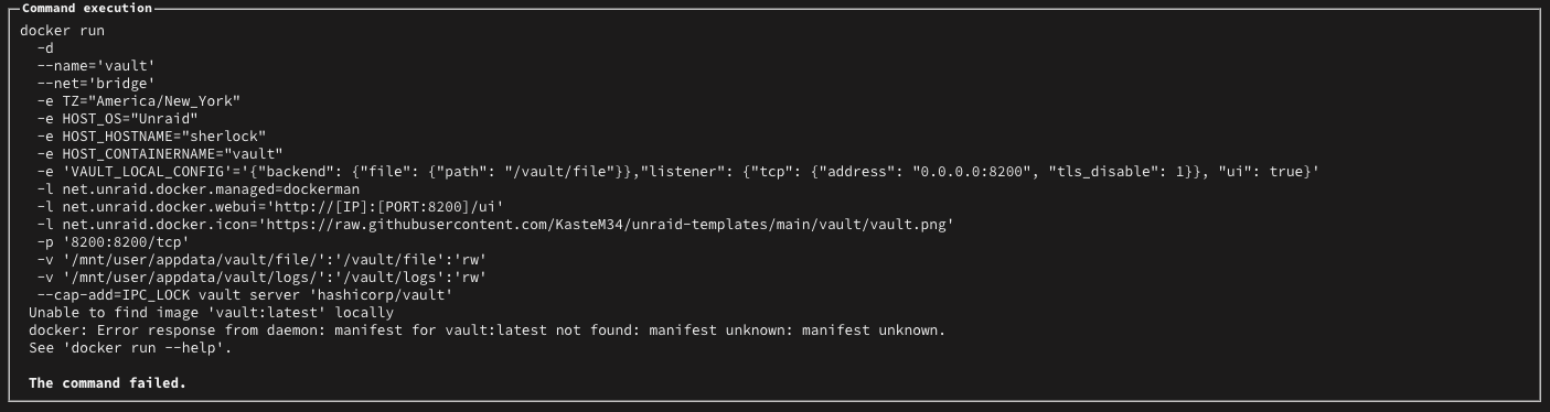

I am not able to start the container. I get the following:
Unable to find image 'vault:latest' locally
docker: Error response from daemon: manifest for vault:latest not found: manifest unknown: manifest unknown.
See 'docker run --help'.
I have tried :latest, :1.14, 1:13 and they all end in the same error. I was able to successfully install another container after trying this one so I don't believe it is something unraid/my system related.

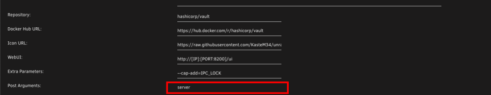

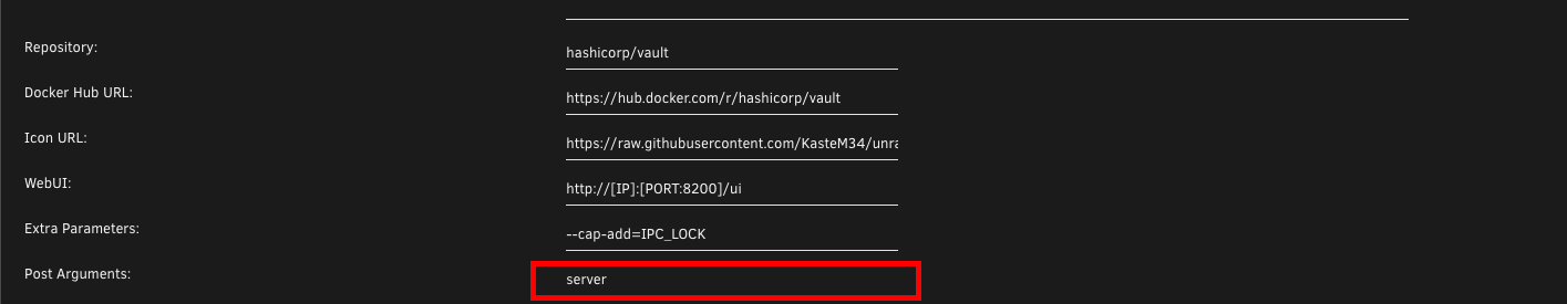

I was able to fix this by adjusting the docker extra parameters. The template lists "vault server" after the memory lock option in extra parameters, I believe the docker run command is accepting this as the repository value instead of hashicorp/vault. From the Vault Docker hub site it only shows server as the post command argument, vault appears to not be needed. Full disclosure though I'm by no means a Vault expert, I was just trying to spin up the container to try it out.

Thank you for the hint, I have updated the template, in like 2 hours from now it should be updated, feel free to tell me if it works.

Worked for me, I removed the container and previous template. I reinstalled the container from Community Applications and the container started up without issues, Thanks!
