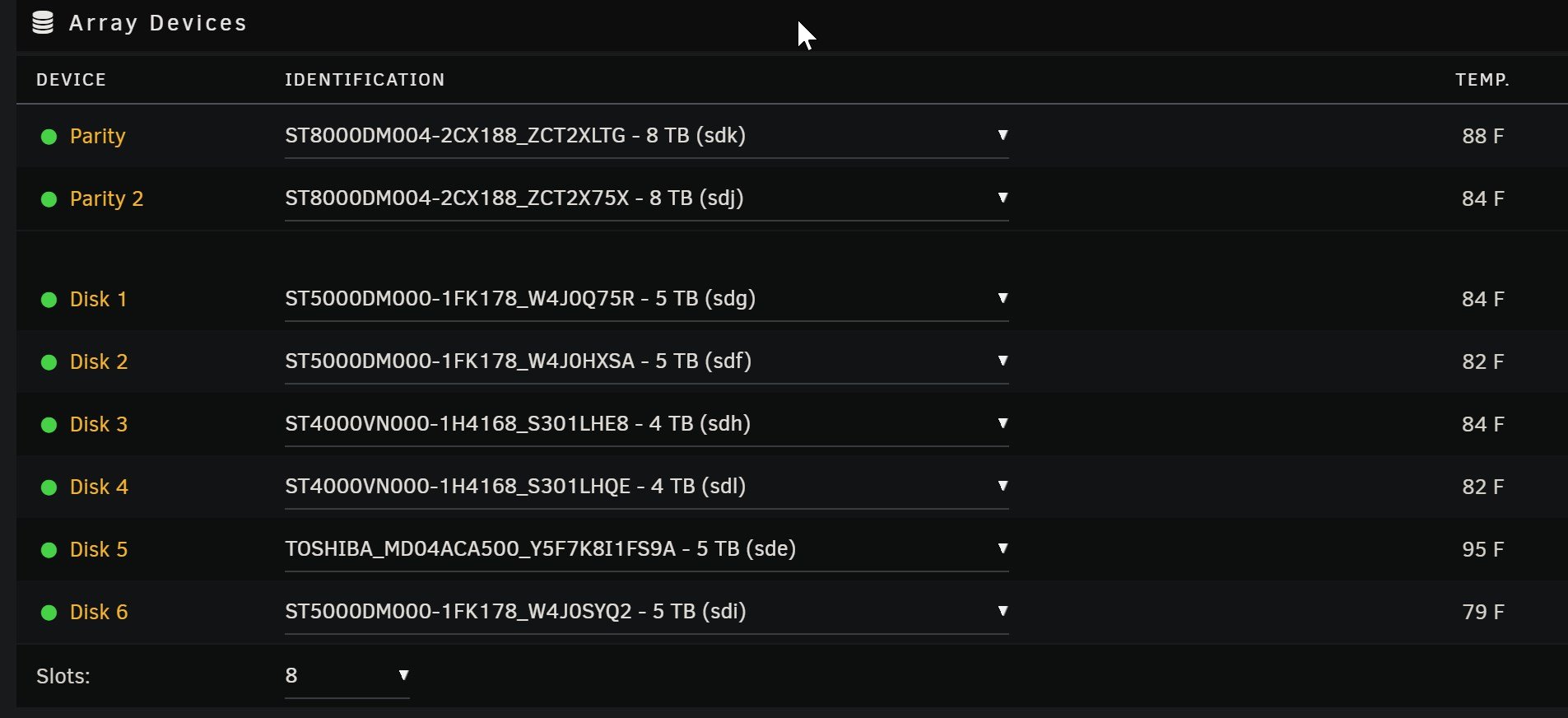

July 1, 20224 yr Community Expert If you start with a fresh install and assign your array drives as they currently are then Unraid will recognise drives that have previously been used by Unraid and leave their contents intact. Just make certain you do not accidentally assign a data drive to a parity slot as that will result in its contents being lost. A screenshot of your§ Main tab as it is now is worth having.
July 2, 20224 yr Author I have backups of my flash drive with syslogs and such. Can I just install unraid on a new usb and copy the disk config only? My parity disks are the only 8tb disks in my array right now, so thats easy to keep track of. But if its that easy as assigning them in this order, it sounds simple. Maybe too simple

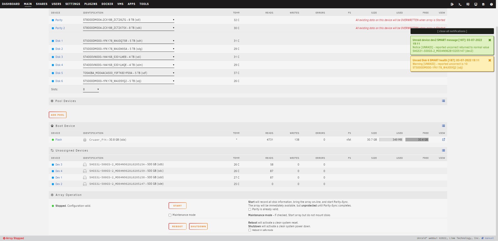

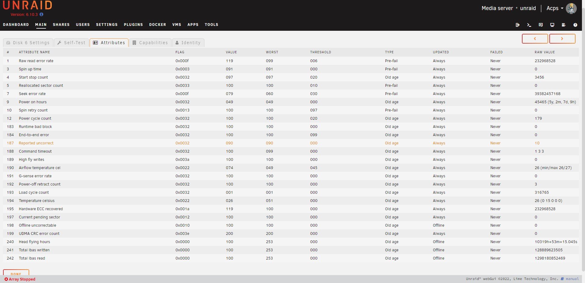

July 4, 20224 yr Author So I got a fresh usb and my key moved to a fresh build. the only configurations i did, was network settings and installed myservers. Is this what I need to see before pressing start for the first time? Disk 6 was reporting an error: Is there anything I should do before trying to do a parity sync? Ty in advance! ~Acps
July 4, 20224 yr Community Expert If these are the same disks as before and parity was already valid you don't need to sync parity. 14 minutes ago, Acps said: my key moved If you also move super.dat it will already know your disk assignments and won't need to sync parity.
