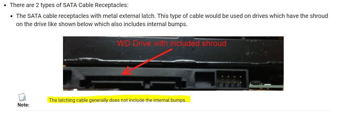

July 3, 20224 yr Author I find the WD article very confusing. In this photo it does not show a photo of the sata cable but says the latching cable does not include the internal bumps but points to the WD hard drive connector and not a cable.

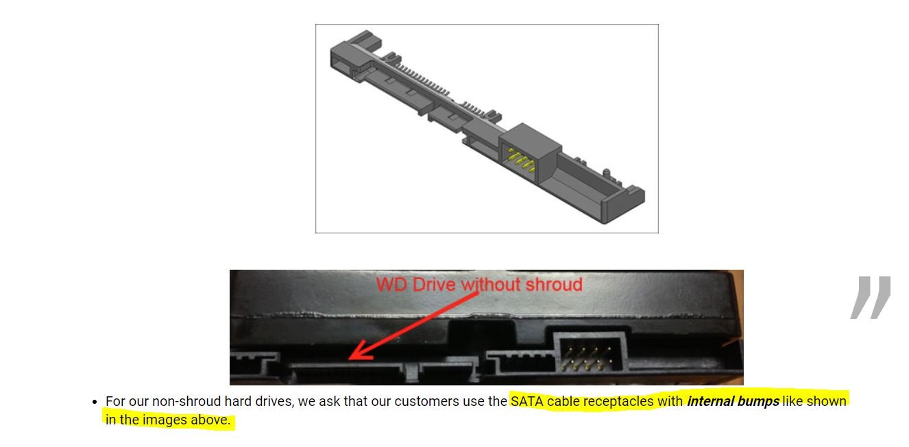

July 3, 20224 yr Author In this photo it shows the WD hard drive SATA connectors that do not have the shroud and should not use the locking connectors but says for this type of connector "use the SATA cable receptables with internal bumps like the images above". Yet there are NO images above of the SATA cables.

July 3, 20224 yr PhotoBucket has kindly placed a watermark across the pictures, but you can make it out. (or if you look at a non-locking cable, it will be quite easy to see the internal "bump"
July 3, 20224 yr Author I have in my hands two SATA cables. A blue one with the metal latches and a red cable with black connectors that does not have the metal connectors. And other than the latches, they look identical. I see the differences between the SATA connectors on the hard drives for latching and non latching. The shroud is in plain sight. But with the cables, the only differences I can see are the latches. I've checked Amazon.ca and Newegg.ca for latches and unlatched sata cables and the only differences are the latches. I will check the connector on the WD Blues 5TB. Edited July 3, 20224 yr by Vetteman

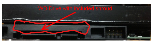

July 3, 20224 yr Community Expert The nibs are down inside the female connectors on the cable. They are the same color as the plastic of the connector housing. They are very small and quite hard to see unless you shine a light down inside of the connector. If there are the proper nibs on the cable, when you pull the cable off of the drive, you can feel a slight resistance until the connector releases. (The nibs are designed so that the cable has a slight interference fit when it is inserted into the plug on the drive. Because these parts are made with thermoplastic, the design can only allow a very minimum of interference before the design would have problems with cold flow of the thermoplastic.) It is generally accepted that ALL cables without the metal latch have the plastic nibs. Furthermore, it also accepted that any cable with the metal latches does NOT have the plastic nibs. The problem comes with those certain models of WD drives that do not have the shroud. ( The shroud is not a part of the SATA connector spec.) However, it is present on all other hard drives. I have grabbed a screenshot of that shroud and circled it. The metal tab of the latch type cable pushes against the shroud to force the mating connectors together (the nibs perform the same service). (The barbs on the latch also provide additional locking function to prevent the connector from working loose.) As you can visualize, with the shroud missing, there is no connector force as well as well as no locking function. There is another picture in the link of a WD drive without the shroud. It may look like the shroud is there but a careful inspection will show that the opening is much larger and the latch will not function properly. If you can pull a latching connector off the drive with little to no force, the drive does not have the shroud!
