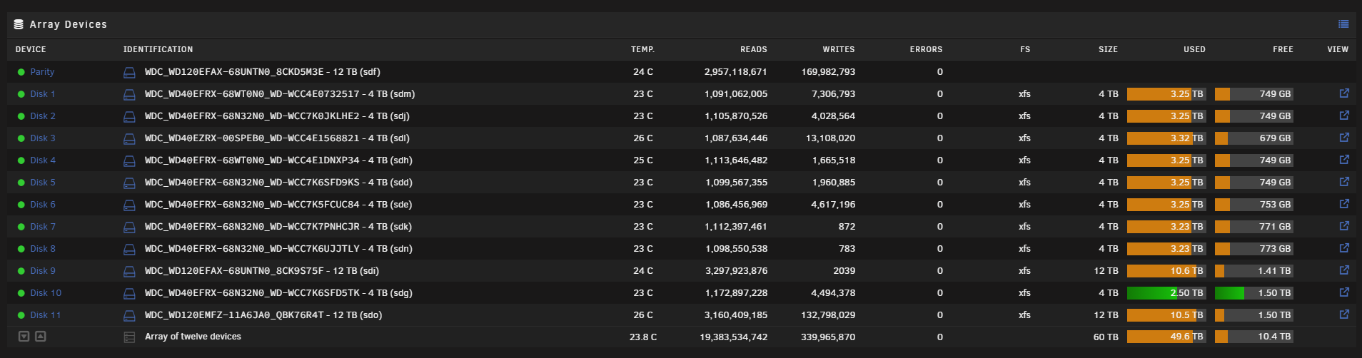

July 4, 20224 yr So I have 12 bays and all full now, mixture of 4TBs and 12TB. I got another 12TB to replace a 4TB but not sure which one to replace. Just replace at random or is there a way to check which is oldest? All the 4TB drives are WD Reds but think 1 is a WD Green so maybe take that out? Edited July 4, 20224 yr by bally12345

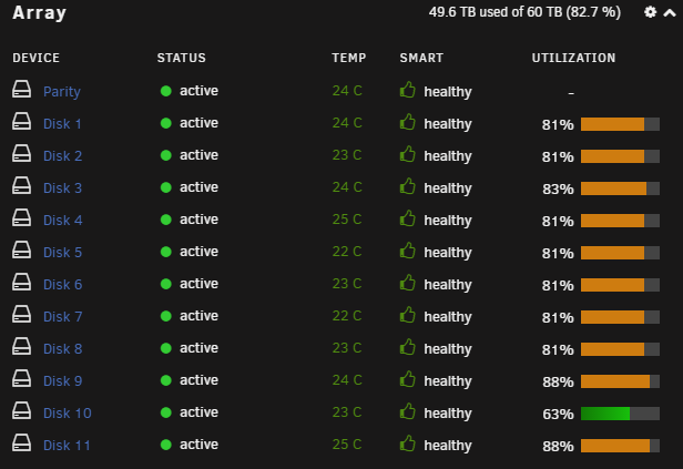

July 4, 20224 yr Community Expert 43 minutes ago, bally12345 said: check which is oldest SMART report for each disk has that information. Do any disks have SMART warnings on the Dashboard page? Post diagnostics if you want us to take a look

July 4, 20224 yr Author 2 hours ago, trurl said: SMART report for each disk has that information. Do any disks have SMART warnings on the Dashboard page? Post diagnostics if you want us to take a look I will run smart against all the disk and pop it into excel for future reference too. None of the drives have any warnings against them and all showing as healthy. 2 hours ago, Frank1940 said: @bally12345 The only reason I would consider doing this is to add a second parity drive. You are actually at the point (number of data drives) where you should consider this. The primary reason for the second parity drive is not to wait until you have a second drive issue but so that you have a redundancy in case you have a problem in rebuilding what you thought was a single drive failure. I think you are right, I didnt even consider a 2nd parity tbh. Either way will still need to pull a drive from the array. server-diagnostics-20220704-1618.zip
