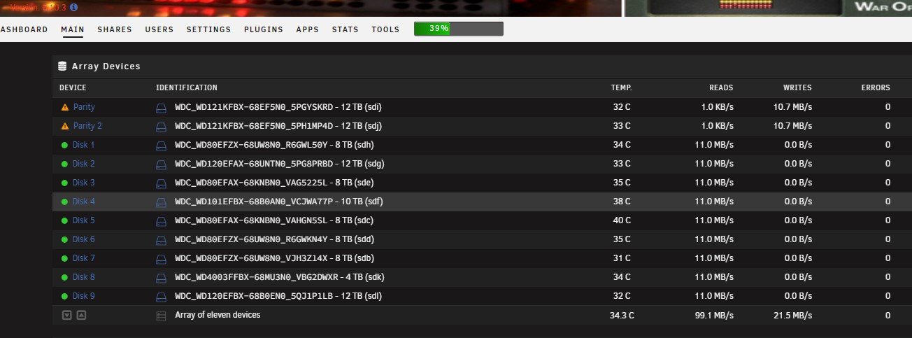

(Solved) Parity-Sync running extremely slowly...currently at 8MB/sec Unable to find out why.
Solved by FQs19
@Vr2Io
Testing old parity disks with one as Parity and one as a Data disk:
No change. I did see 212MB/sec. for the first second, but it quickly fell off to ~80-100MB/sec.

6 hours ago, FQs19 said:
This still isn't anywhere near the 180MB/sec. I should be seeing.
What are your thoughts on this??
CPU usage is still very high for just two disks going at those speeds:
USER        PID %CPU %MEM    VSZ   RSS TTY      STAT START   TIME COMMAND
root          2  0.0  0.0      0     0 ?        S    22:22   0:00 [kthreadd]
root      92867 94.9  0.0      0     0 ?        R    22:31   3:35  \_ [unraidd0]

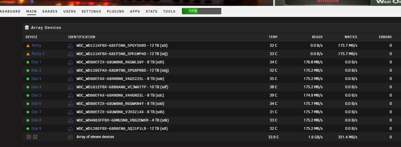

So I decided to go back to basics and assume I messed up installing my components when I switched cases.
I pulled my graphics card.
I pulled the AIO cooler off and cleaned it. Previous thermal paste application was good.
I pulled all the memory sticks.
I pulled my Dimm.2 stick.
I pulled the 24 pin power cable out.
I made sure the two 8 pin power cables were seated all the way. They were.
I pulled the 3960X CPU out of the carriage, after cleaning the thermal paste off. I verified all the pads were still in good shape. They were.
I then took video of the motherboard CPU pins in the socket to verify nothing was damaged. No damage seen.
I then re-inserted the CPU using the supplied torque wrench with the proper sequence of 1>2>3.
I applied a liberal amount of thermal paste to the AIO heatsink.
I then re-inserted my four memory sticks, my Dimm.2 stick, the 24 pin power cable, and my graphics card.
I then plugged my PSU in (which is only 1000 watts and several years old. I am replacing this PSU with a new Seasonic PRIME 1300W 80+ Platinum one this week). I'm thinking my server could hit 1000 watts during high work loads and since the PSU is several years old I should replace it with a higher wattage one. I don't believe it was causing my errors, but if I'm going back to basics, this is something that should be replaced with a higher wattage PSU.
I cleared the CMOS.
I configured the BIOS, changing only the TPM to Firmware, the CPU speed to Auto from Default, the boot mode to CSM and Legacy USB boot, then saved and rebooted.
Once in Unraid, I had to reconfigure the network settings since I left the Intel LAN controller enabled, then rebooted Unraid to save the changes.
After getting back into Unraid and verifying the network changes worked, I added my two parity disks and started the array.
I immediately saw normal performance, 165MB~185MB/sec!!!
I don't see any high single thread CPU usage either!!!

After a while, the Fix Common Problems plugin through a warning saying it was Unable to communicate with Github.
I had to go into my router, change the DNS provider to 8.8.8.8, then change it back to 1.1.1.1. Once I did that, the DNS error on Fix Common Problems cleared. There might be an issue with my SFP+ module. I'll deal with that annoyance later.
I'm attaching my diagnostics to see if you can spot any difference after reseating my CPU, cooler, memory, and power cables.
I'm hoping that my problems were just because I didn't have the CPU, cooler, or power cable seated properly after switching cases.
It might also be that my PSU is just at its limit and with its age it couldn't keep up.
I have two new TRX40 motherboards coming as well in case this Asus ROG Zenith II Extreme Alpha motherboard has a problem.

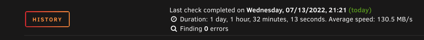

My parity-sync finally finished after 25hrs 32mins 13secs with an average speed of 130.5 MB/s.
1629441251_ScreenShot2022-07-13at10_06_01PM.thumb.png.fe2850b7077f21ce0b367f43b519d902.png
I believe my previous parity checks were around 26~28 hours. I forget.
Would you say that's an average speed for two WD Red Pro drives as parity disks?
Perfect, if all disk in same size will speed up more then 7200/5400.
