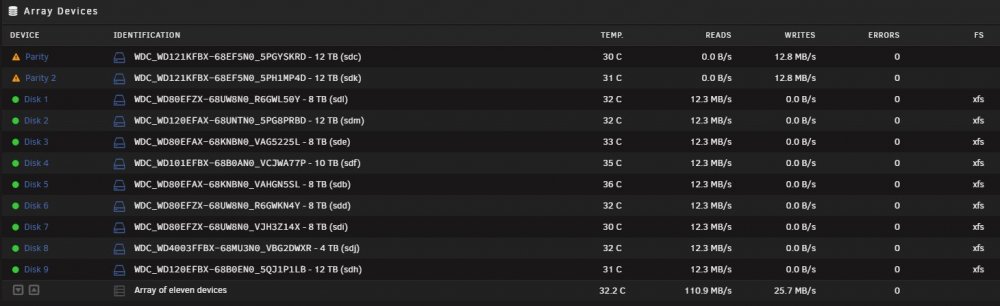

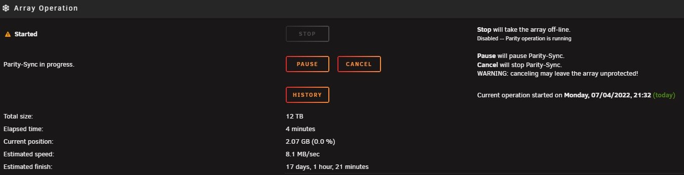

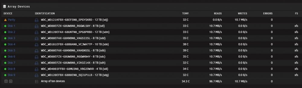

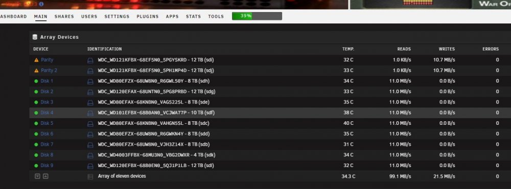

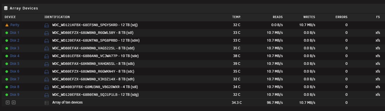

After rebuilding my server and setting everything up, I finally added my two WD Red Pro disks back as Parity.
The first time I tried adding the two parity disks, it was running at 10MB/sec.
I canceled that, rebooted my server and tried again.
This time the performance is worse. It's currently running at 8MB/sec.

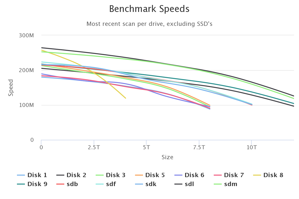

I ran all disks through the DiskSpeed docker and all disks looked great.

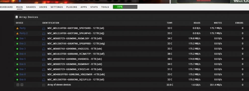

I know some disks are old, but I've been able to transfer data to my array at the normal 110-120MB/sec.
I canceled the Parity-Sync so I could grab the DiskSpeed graph.
After stopping my array, setting my two parity drives, and starting the array, the speed is still slow at 8.7MB/sec.
Anyone have an idea of why the sync is so slow?
On version 6.10.3.
All plugins updated.
Two parity drives are WD Red Pro's.
Array disk are all WD with a mix of red, red plus, and pro.

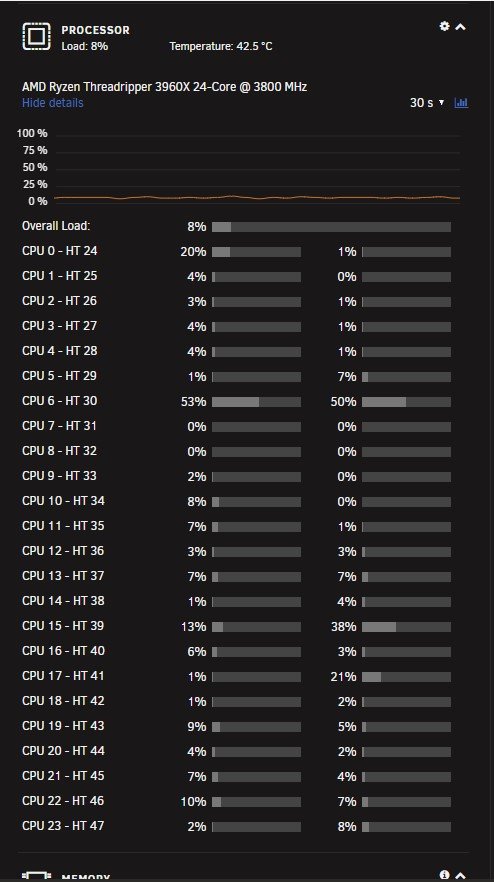

The sync thread is single threaded and the CPU usage is very high for the speed it's going, there was a similar case recently, also with a threadripper IIRC, but don't remember the solution, let me see if I can find it.

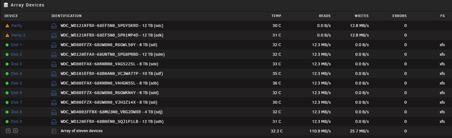

I moved my parity drives to the ASMedia ports.
So now I have 8 disks on the HBA, 2 disks on the MB SATA ports, and 2 parity disks on the ASMedia SATA ports.
Speed increased to only 12MB/sec.

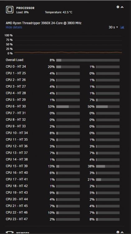

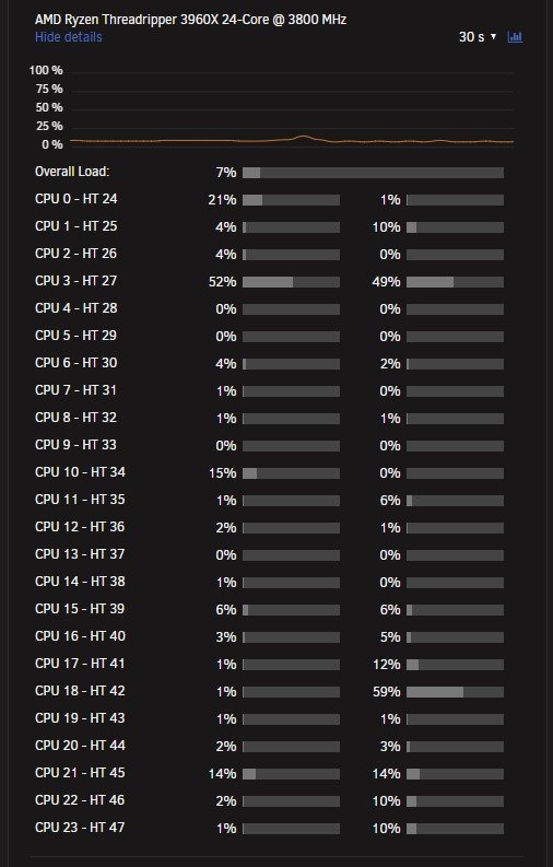

CPU occasionally has 1 thread hitting 80%, but this is the average:
Any other ideas?
threadripper19-diagnostics-20220705-1524.zip

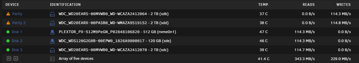

Not much idea, TR is kind of NUMA, memory and IO may access cross CPU core, but those delay definitely neglectable.
I have 1920x, not running Unraid and only have three harddisk attach, will do some test.
Pls try disable parity2, if that will increase speed then it should CPU issue relateed.

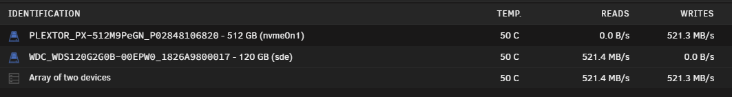

I have make test on my 1920x, can't reproduce the problem. CPU core will reach ceiling 80+ for short time and not in continues.
Could you do one more test, only test with two parity disk, new config, then assign one as data and other as parity.

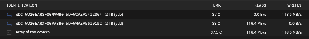

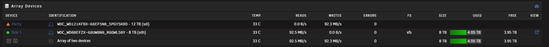

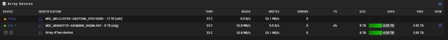

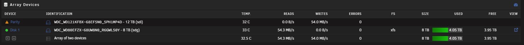

Well it somewhat worked, though I'm only getting around 60MB/sec. It occasionally spikes up into the 80MB/sec range.
CPU usage is like before:
This still isn't anywhere near the 180MB/sec. I should be seeing.
What are your thoughts on this??
threadripper19-diagnostics-20220705-2234.zip

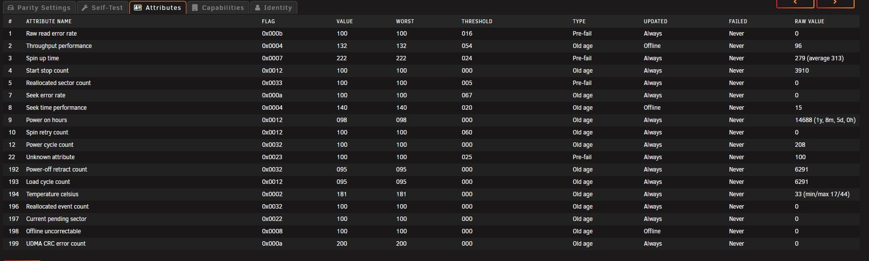

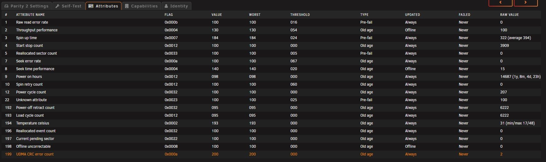

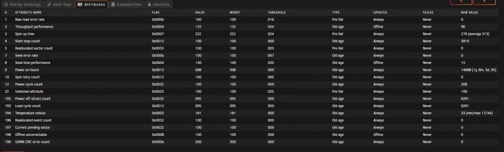

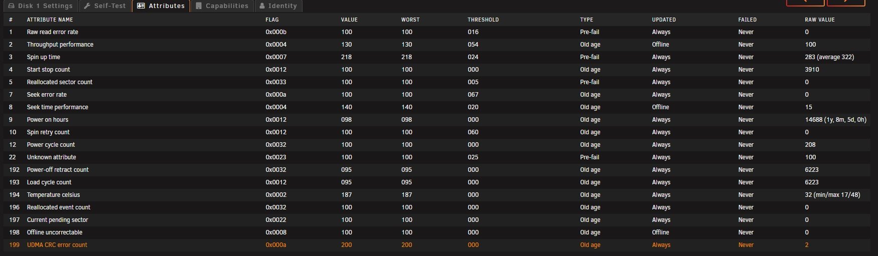

Good, at least have some different, I notice your 2nd parity disk "Seek time performance" was 15 and I check all my WD disk was 18, it may indicate this disk have issue.
Pls check "Seek time performance" on 1st parity disk. If it is 18 or other value, then it may prove 2nd disk have some issue.
Next, I suggest assign a real data disk and 1st parity disk as parity and perform test again.
** Just don't wrongly assign any real data disk be parity "

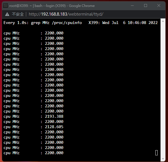

I got the value is 15 too, pls in console terminal type "watch -n 1 grep MHz /proc/cpuinfo" to check current CPU frequency.

"Seek time Performance" for both are 15.

Same results as first test. ~60MB/sec. with occasional spikes to 80MB/sec.
For the first second after starting the array, I did see a speed of 120MB/sec, but it never went that high again.
@Vr2Io
I swapped old parity disks and tried again. Same results, only getting ~60MB/sec.
So disk ...KRD as parity 60MB/sec. and disk ...P4D as parity 60MB/sec.

Pls in console terminal type "watch -n 1 grep MHz /proc/cpuinfo" to check actual CPU frequency.
I stopped the parity-sync and did a New Config, so this is just unraid sitting idle on the Main page.

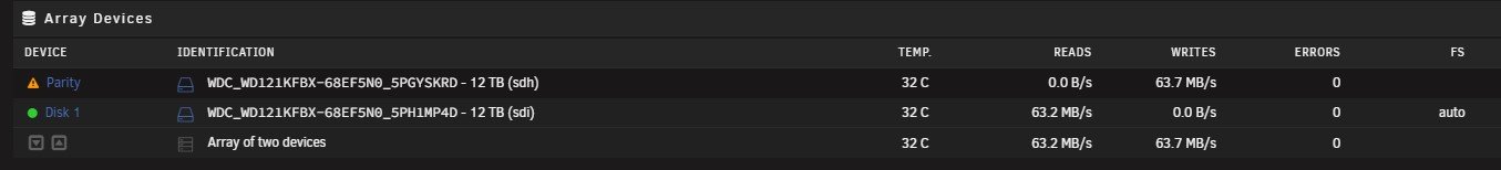

Performance is better, but not by much. Not sure if this speed is normal, but it's not the 180MB/sec. I'm expecting.
This is one of my old parity disks ...KRD as parity and one of data disks as Disk 1:
It was over 100MB/sec for a couple seconds after starting the array, but kept falling to ~80MB and leveled off there.
Here's the CPU usage as well:

I'm going to try again with just the old parity disks like the first test you asked me to try.
Sure abnormal.
I couldn't sleep without trying the 1603 BIOS.
Suggest only use parity disk to test, connect to onboard FCH or Asmedia SATA controller and perform same test, otherwise you really need try different BIOS / Unraid OS to figure out whats going wrong.
Edited by Vr2Io
