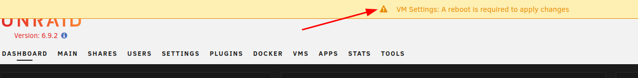

July 6, 20224 yr If I simply go to the VM Manager page under the Settings tab, I immediately get prompted to reboot the server even though nothing was changed. I'm told this is not normal. Can someone confirm this is not normal behavior and help me understand why I see this behavior?
July 6, 20224 yr Author No. I've been on 6.9.2 since it came out. I don't recall if I had this issue on the prior version. And I'm holding off on going to 6.10.3 given recent events. Maybe going to the new version will clear this up?

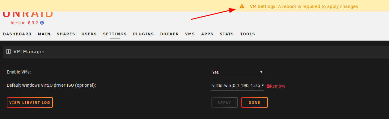

July 6, 20224 yr Author And now it's on every page. I didn't change anything - I just clicked the VM Manager icon.

July 6, 20224 yr Author If I reboot it goes away. Until I hit the VM Manager icon again. When I look at it, it's in Basic View. root@server:~# cat /boot/config/domain.cfg SERVICE="enable" IMAGE_FILE="/mnt/user/system/libvirt/libvirt.img" IMAGE_SIZE="1" DEBUG="no" DOMAINDIR="/mnt/user/domains/" MEDIADIR="/mnt/user/isos/" VIRTIOISO="/mnt/user/isos/virtio-win-0.1.190-1.iso" BRNAME="br0" VMSTORAGEMODE="auto" HOSTSHUTDOWN="shutdown" TIMEOUT="180" Edited July 6, 20224 yr by nraygun
July 6, 20224 yr Author I see the time/date stamp for the domain.cfg file change when I visit that area and don't change anything. Using diff, they contain the same content. Hmmm...
July 6, 20224 yr Author I tried a few things and still get the reboot message at the top: Copied the domain.cfg to domain.old, deleted the file, then had unRaid recreate the file. I rebooted, then went to the VM Manager area, and it still has the reboot message at the top. Tried uninstalling the My Server plugin (read somewhere that was causing issues for someone) and I still get the message. Tried a different browser - PaleMoon in MX Linux Edited July 6, 20224 yr by nraygun
