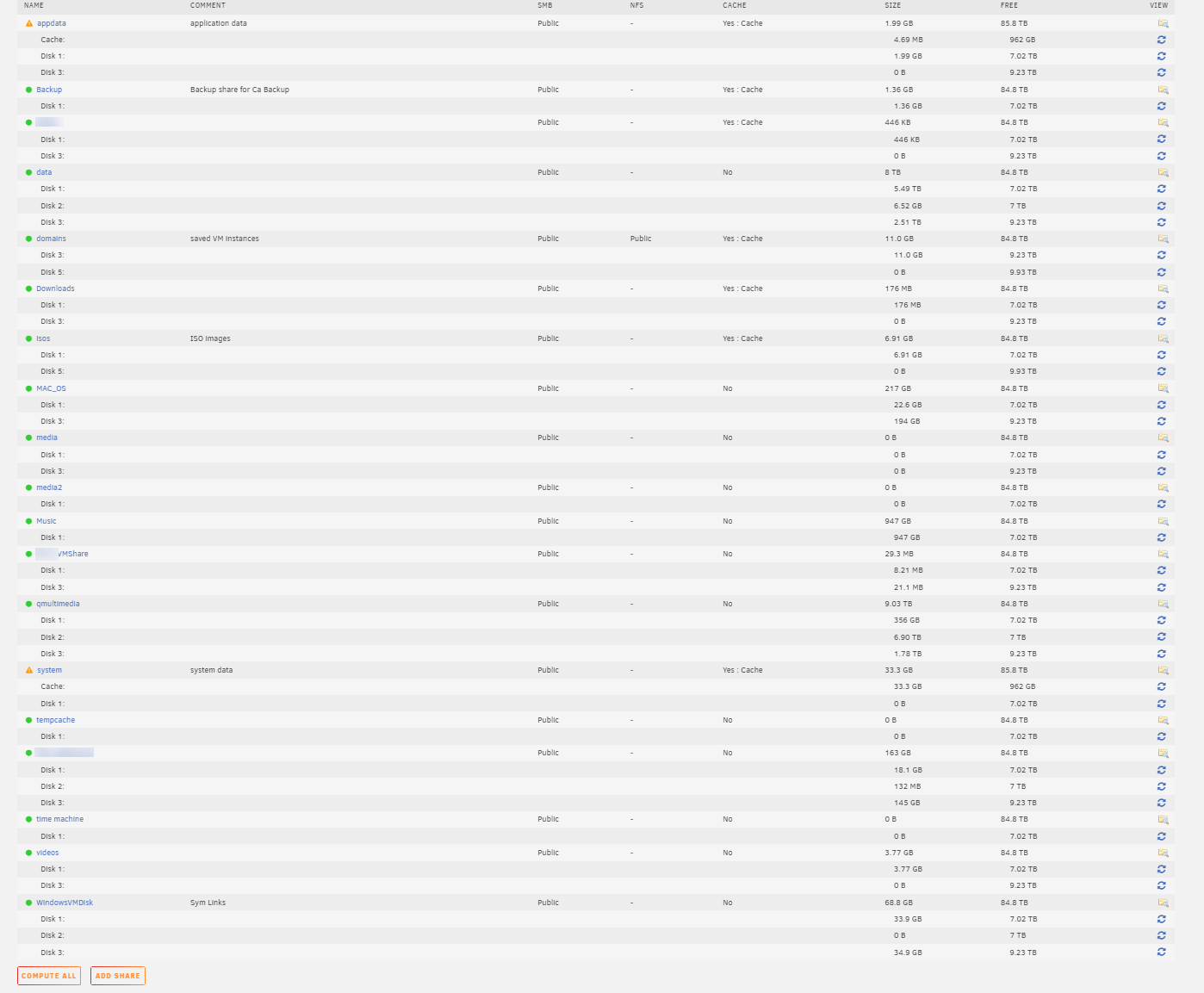

Your appdata, domains, system shares have files on the array, and are configured to be moved to the array. You want these shares all on fast pool (cache) and configured to stay there, so Docker/VM performance isn't impacted by slower array, and so array disks can spin down since these files are always open.
These are the only shares I looked at since you have so many .cfg files in config/shares folder and 6.9.2 diagnostics don't give a summary of your shares so I would have to open them all one at a time.
Go to User Shares page, click Compute All button at bottom, wait for the complete results. Complete results will show how much of each disk each user share is using. If you don't get complete results after a few minutes, refresh the page. Then post a screenshot
Here you go, if too small to read, i can post 2 screenshots. I just blurred some personal info

As I was explaining in my previous post, there are some things you want to stay on cache. That screenshot shows what I was talking about
Set appdata, domains, system shares to cache:prefer so they can be moved to cache. The names of some of your other shares suggest they are also involved in VMs, so you might want them cache:prefer also.
Nothing can move open files. Disable Docker and VM Manager in Settings and then run Mover.
Mover won't move duplicates so there may still be some manual cleanup needed.

Did all of the items you mentioned.   After making the Cache Prefer, the size got larger (39g) but then today it dropped to (15g)

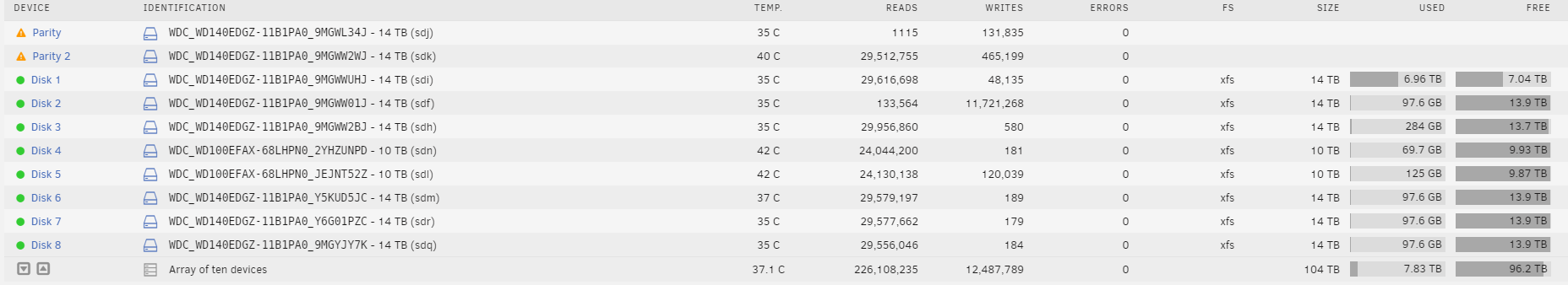

I can't believe it but it seems like 2 14tb's failed at the same time.   I been running smooth without any issues for a long period since the other issue back in July but at 11:43am today both drives (disk 3 and 1 of the parity drives) failed.   I have not done anything yet but here is the diagnostics.zip file seeking some help again.   Not sure if there is another issue going on because both drives stopped at same time with 'disk in error state (disk dsbl)' both have same message and when i click on the drives they both say 'a mandatory smart command failed'  - I have been using Urbackup and have many large disk images on the server and i don't want to lose them.

Problem with the onboard SATA controller, quite common with Ryzen boards, though it appears to be much less common with recent Unraid releases, so suggest updating to v6.11.5
I ran a xfs repair on disk 3. Updated to latest version on unraid (I heard about some issues with the Fan plugin, which i had working good so that is why i hesitated to upgrade this one.   But where do i go from here?   Do i need to replace the hard drives?  Both Parity 1 and Disk 3 failed.   Not sure what to do next.  I have 1 spare 14tb
