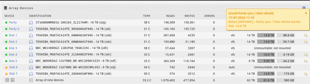

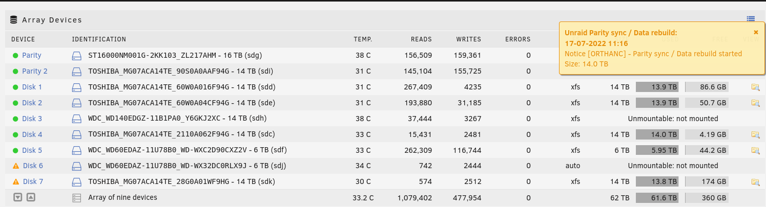

Cleaned up some space by deleting a bunch of movies, and unmounted disk 6 and 7 (they were flagged as unmountable, but no smart errors). Disk 7 is rebuilding from parity, and disk 6 is still marked as unmountable. I suspect that disk 6 might actually need to be replaced.
But, now disk 3, which didn't have any issues before, is marked as unmountable.
I've attached new diagnostics.
orthanc-diagnostics-20220717-1415.zip
disk7 not unmountable according to that screenshot. Perhaps you just meant they were both disabled.
Both disks are rebuilding, disk6 is rebuilding an unmountable filesystem. We usually recommend repairing the filesystem before rebuilding on top of the same disk to make sure it can be repaired before you overwrite the disk. Too late now, you will have to hope for the best when you repair the filesystem.
disk3 filesystem will also have to be repaired, after rebuild completes.
So, you are exactly in this position I was concerned about with your full disks.

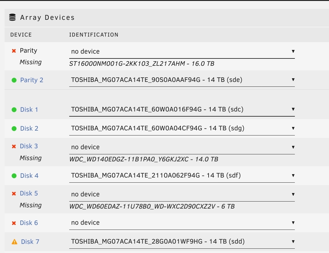

I was able to get some time to take the server out of the rack and up to my office (thank god the kids are napping lol).
I opened it up and disconnected all the sata cables and power. I carefully reconnected everything and double checked the connections. I still have multiple drives that show up as unmountable.
orthanc-diagnostics-20220717-1849.zip

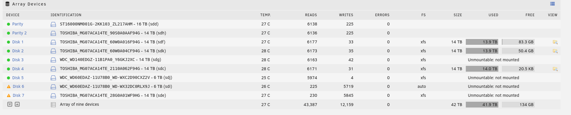

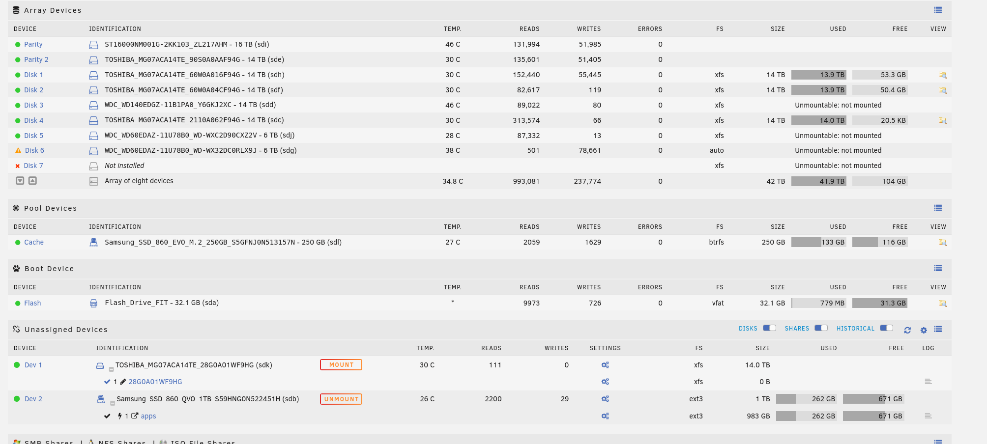

Post screenshot of Main - Array Operation
Nevermind, syslog shows it is rebuilding disks 6,7
Is it showing anything in the Errors column on Main - Array Devices since you took that screenshot?
Probably you are just going to have to repair the filesystems on all the unmountable disks and hope for the best.

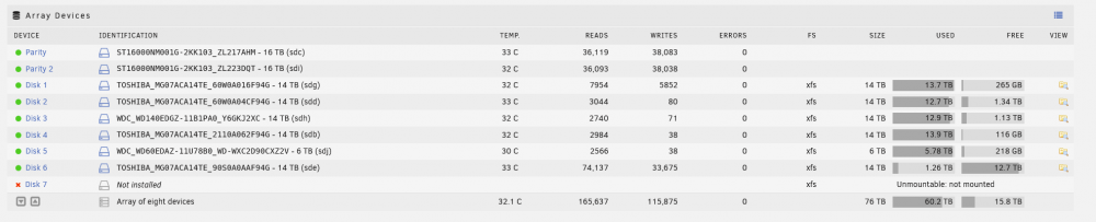

No errors are showing up. I'm freeing some more storage space from disk 4 before I stop the array and try and do some file system repair.

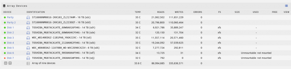

Current view on the UI:
Disk 7 did eventually show up after I swapped out the sata cable for one that connected better.
I tried moving disks 3, 5, and 6 to other sata ports on the motherboard instead of the expansion card, and I also tried different power connectors, and nothing changed.
I will attempt to do some file system repair and see how it goes.
