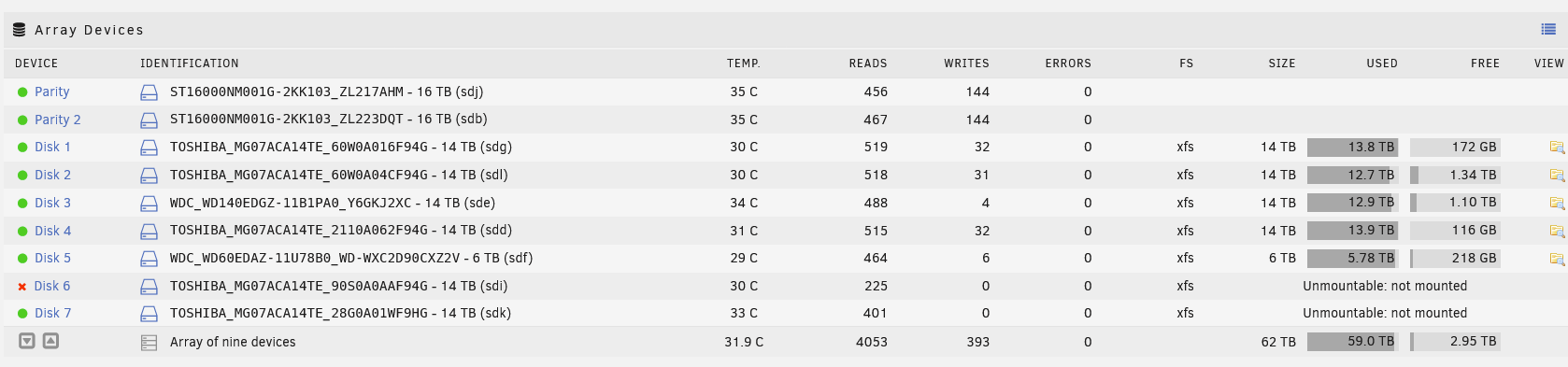

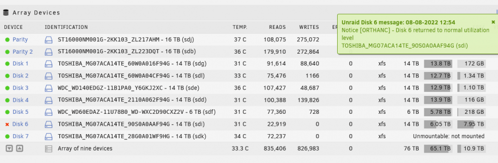

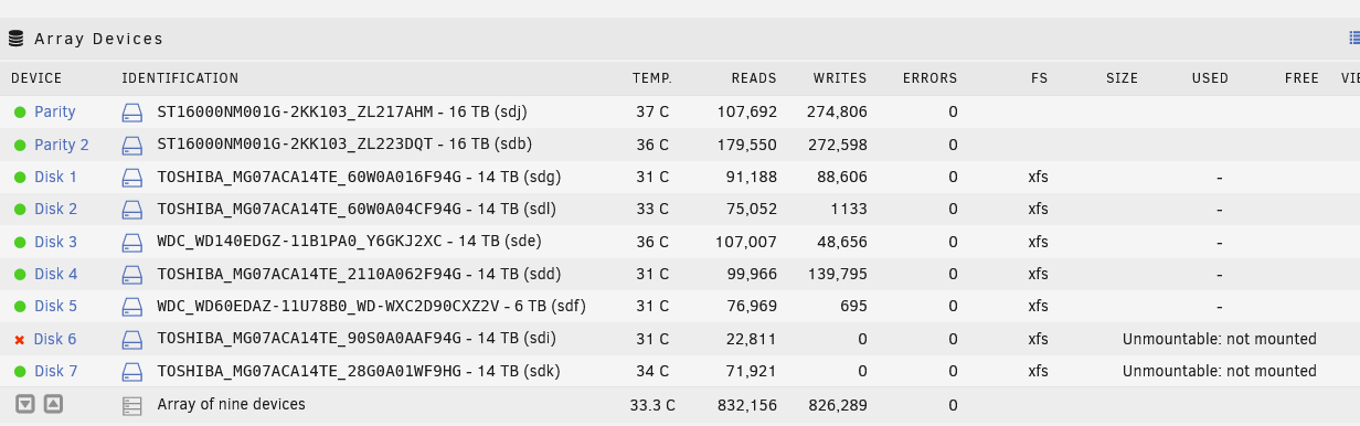

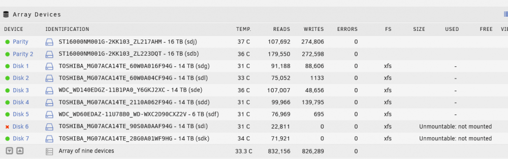

Here's my update. I let the rebuild and parity checks finish, and I still had a dead drive. I decided to just remove the 6 TB drive and replace it with a larger one. I got a good deal on a 16 TB seagate, so I swapped out the 14 TB drive in parity for the larger 16 TB drive after a preclear. Both parity drives are now 16tb. I let parity rebuild onto the new drive, and swapped out the dead 6 TB for the 14 TB drive (that has always worked fine). The data rebuilt and I had all drives green! But, the last 2 drives still show up as unmountable.
I did some digging into the Marvell raid controller. I initially thought it had to be the motherboard since it says it has 4 ports, but nope, it's the expansion card which has 6 ports on it. I decided to stop the array and see if I could troubleshoot, and this is what I saw next. Only 2 drives showed up as attached and the rest were missing.
I downloaded the diagnostics and rebooted, now the drives are all back.
Disks 6 and 7 still show up as unmountable.
My thoughts are that I should replace the sata controller and see if that helps.
My question at this point is do I need to do something with the unmountable drives? I know disk 6 is a good disk since it's been in use as a parity drive and I did not unplug or move the port it is connected to, just assigned it in the UI.
I also attached the diagnostics for after I rebooted if that helps. It's the one that ends in "-2".
Thanks!
orthanc-diagnostics-20220807-2206.zip orthanc-diagnostics-20220807-2219-2.zip
Well, I just reviewed the thread after all these weeks, and though a lot was said about unmountable disks and filesystem corruption, I don't think anything was said about what to do about it.
Fixing hardware won't fix filesystem corruption, since the corruption already happened. And rebuild won't fix it, because parity is in sync with the disk that is corrupt.
Disable Docker and VM Manager in Settings until things are fixed, and try not to write anything to your server.
Check filesystem on disk 6 and 7
Also, lots of syslog entries about Unassigned Device sdh, looks like it might be a drive problem. Disable spindown on that disk and run an extended self-test
Be sure to capture the output so you can post it
Running xfs_repair from the UI with the `-n` flag and it has been hanging for about 20 minutes.
Here is the output so far:

13 minutes ago, thebedivere said:
pre-clear on it last night which failed, so it's not looking good
SMART attributes for it look OK, but it has never had an extended self-test so you might try that. You should remove it if for no other reason than it is cluttering your syslog and we will wonder about it next time.
22 minutes ago, thebedivere said:
xfs_repair for disk 6 finished
23 minutes ago, thebedivere said:
No modify flag set, skipping filesystem flush and exiting
Go ahead and do check filesystem on emulated disk6 without -n (no modify) so it will do the repair. Since it is emulated, it won't actually repair the physical disk, but the result is what would be rebuilt onto disk6. If the repair of emulated disk6 looks good then you can rebuild it. If not, then we can take a look at the physical disk as Unassigned Device and see if it is any better.
Disk7 later
Running xfs_repair without the -n flag on disk 6 now.
Ok, xfs_repair on disk 6 finished:

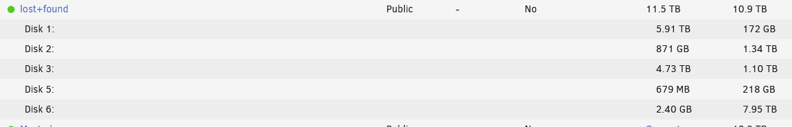

So emulated disk6 mounts and has plenty of data.
Go to User Shares, click Compute... for lost+found share, post a screenshot
lost+found folder is created on a disk when filesystem repair can't figure out what to do with some of the data.
Reviewing this thread, only (emulated) disk6 has been repaired in this thread.
But your screenshot is telling us that you have previously repaired all those other disks as well. And some of them have a lot of data in lost+found. Have you ever looked in that share?
I have not looked in that share. I have probably repair the other disks at some point in time, yes. What should I do to restore that data?
Looking in the share I just see a bunch of folder and files with alpha-numeric names that don't have any meaning to me.
Scratch that, after clicking into more folders I found some audiobook files.
The audio book files I found are also on the correct share for Media/audiobook files.
That is typical for lost+found, filenames couldn't be associated with the data, and neither could folders. So you just get a lot of stuff that you can either forget about, or try to figure it out one at a time. Often not worth the trouble. Disks 1, 2, 3 have a large amount of data in lost+found.
Linux 'file' command can sometimes tell you what kind of data is in a file, which might give you some idea of how to open them.
Anything important is backed up to another machine and to backblaze, so I'm not too worried about missing files at this point.
Is it safe to ignore for now, or do I need to address it before I move on?
Edited by thebedivere
If you don't want it you can delete it and recover the space. You can decide later.
