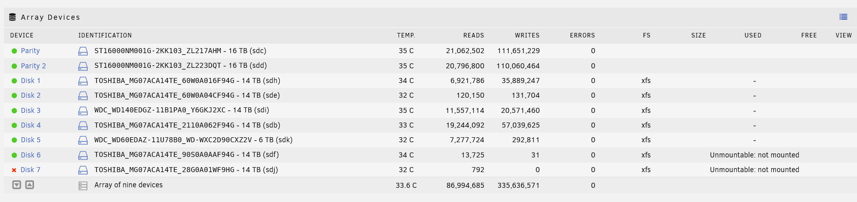

I disconnected disk 7. The rebuild of disk 6 started to slow down and went from 2-3 days up to over 400 days.
After removing disk 7 it is back to under 1 day.
I think I should let disk 6 rebuild and then deal with disk 7.

Oh, I see. It was disconnected which was causing the read errors. Once disk 6 is done rebuilding today I'll try reconnecting disk 7 and make sure it connects.

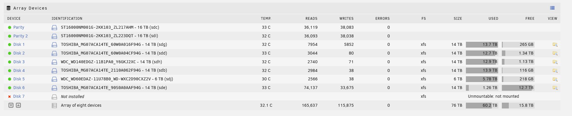

I followed the rest of the steps in the wiki link (which I have also done before, just not from the command line) and drive 6 is once again mounted and green, thanks for the assist with that.
I am waiting on the replacement for drive 7 and hopefully that puts everything back in the green.
I am still not sure I have figured out the root of my issues with drive failures and overall system instability. I did replace the sata card, but I still had drive 6 fail to mount after being fine for a week or so.

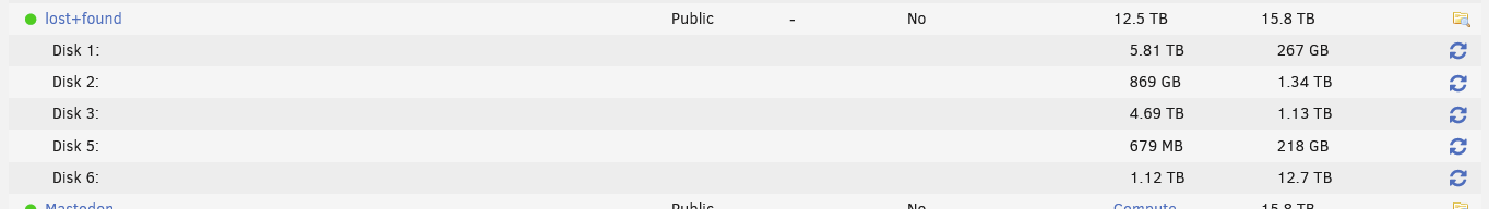

lost+found went up another TB after this. I am going to go through it and start deleting or restoring files.image.thumb.png.d6eb85e5ade78686aad6572c22002d24.png
Down to 6 TB in lost+found!image.thumb.png.639fe96afe2f6020ba54df536b56c029.png It has a lot of movies and TV shows that are pretty easy to copy out in large chunks.
