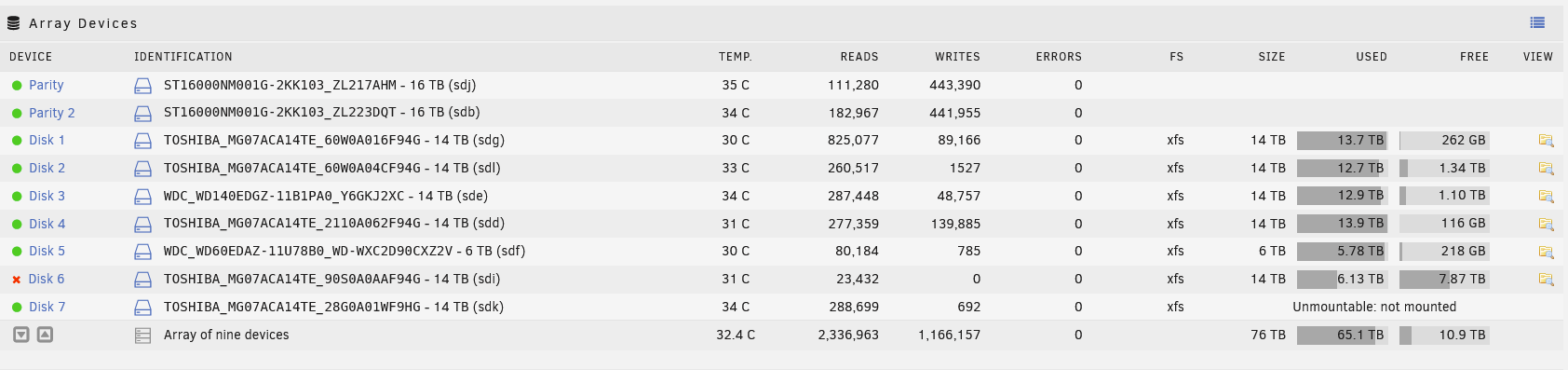

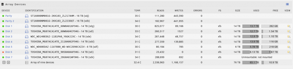

  • That is definitely the wrong command in more than one way.   The webUI knows the correct command.   The correct command for the command line is documented, but not always understoo
Disk 7 still shows up as unmountable.

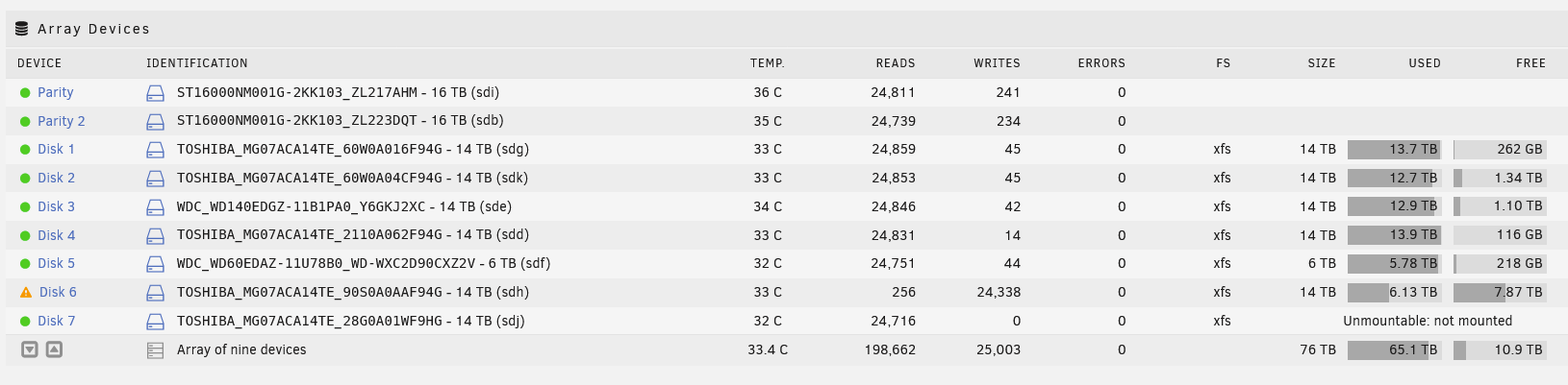

Since (emulated) disk6 is mountable now you could rebuild it.
Or you could take a look at physical disk6 using Unassigned Devices to see if it has corruption, or if repair would turn out better than the 2.4GB lost+found you will get from the rebuild.
Is this the process of stopping the array, unassigning the drive, starting the array, stopping the array, and reassigning the drive to the same slot?
yes
Disk7 appear to be failing:
ID# ATTRIBUTE_NAME          FLAGS    VALUE WORST THRESH FAIL RAW_VALUE
  24 Helium_Condition_Upper  PO---K   075   043   075    NOW  0
Helium leak?
Also check/replace cables on parity2 and disk5.
Connection problems on parity2.
Also, disk7 seems to think it is failing, maybe the reason you can't repair its filesystem?

Ideally, when rebuilding a disk, you should see a lot of Writes to the rebuilding disk, a lot of Reads from all other disks, and zeros in the Errors column.
Are you seeing any Errors in the Errors column in Array Devices?
No errors showing up:
15 minutes ago, trurl said:
Still having connection problems on parity2.
I stopped the array and hot swapped the 2 parity drives into a different drive bay, so they should be running from the sata controller on the mobo now instead of the expansion card.
if they don't have problems and the other drives now do, I will need to replace the sata card.
orthanc-diagnostics-20220810-1708.zip
