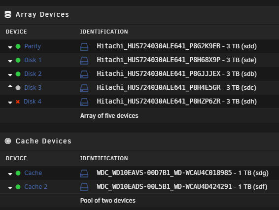

August 4, 20224 yr So as stated I have a red x on drive 4 of a 5 device array - I have a replacement drive ready if needed but am not sure how to proceed - do I just stop the array - then power down the server - replace questionable drive with new drive - then reboot and let unraid do its job or is there more to it? thank you in advance for all your help server-smart-20220804-1129.zip

August 5, 20224 yr Community Expert 2 minutes ago, thearttist said: is this the correct diagnostics yes Why are you running such an old version of Unraid? (we hate trying to work with those old diagnostics 😉) Looks like disk4 and both cache have disconnected. Do these have anything in common, controller, power cable?

August 5, 20224 yr Community Expert 52 minutes ago, trurl said: disk4 and both cache have disconnected. Do these have anything in common, controller, power cable?

August 5, 20224 yr Community Expert 7 hours ago, thearttist said: looks like the cache is fine from dashboard That is not the Dashboard. Diagnostics say otherwise. 7 hours ago, thearttist said: fix the drive first fix the connections for disk4 and both cache. Are any other disks on the Marvell?

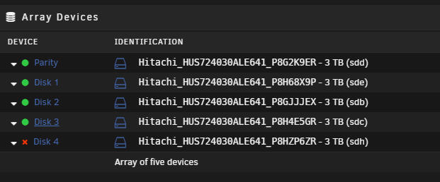

August 10, 20224 yr Author Ok so installed new controller and have upgraded to newest version of unraid everything seems to be working - how do I fix the red X issue on drive 4 thanks for the help server-diagnostics-20220810-1921.zip server-smart-20220810-1922.zip
August 11, 20224 yr Author can anyone tell if the drive is bad and needs replacing or was it the controller
