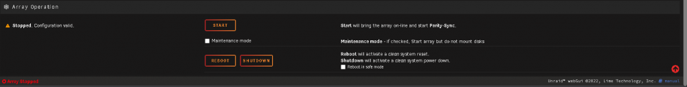

Ok, so I took a chance and just restarted. I only ran the diagnostics and the array shows stopped. I haven't attempted to start the array or add the drive in question. Hope this helps.

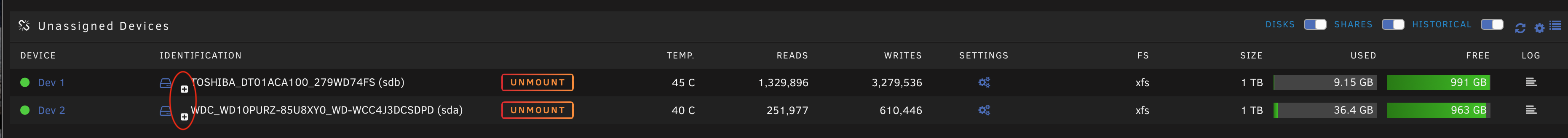

I just noticed the drive I was trying to add from before now says mount not preclear.
If it is mountable it is not clear. Did you perhaps format it? A formatted disk (empty filesystem) isn't a clear disk.

I believe it the /dev/sdd Toshiba drive.
Looks like it is a 3TB drive but has an existing 2TB DOS partition allocated.  I would guess that deleting that partition would solve the issue.
Thanks for the reply, how do I do that in Unraid because I am not sure. Thank you for figuring this out too.
If you have Unassigned Devices plugin and UD+ installed you can use Unassigned Devices to delete the partition and reformat the drive. Destructive Mode must be enabled in UD settings.
Hey, thanks for letting me know I will try that. Well I enabled the destructive mode because I have both Unassigned Devices and UD+ installed but I can't find a way to delete the partition.
Is the only way to try and add it to the array? If so my array is still going through a parity check and I can't do it then.
Thanks for the help again.
2104832378_ScreenShot2022-08-21at7_18_27PM.thumb.png.79302ab02c958735aba75d7ac1aa1dbc.png
Locate the drive in the UD section of the webUI and you'll see a little + sign (assuming that "show partitions" is set to "No"). Click the + sign and you'll see the partitions with a red X next to them. Clicking the X will delete the partition. IIRC you don't need to re-format the drive if you intend to add it to the array. unRAID will clear and format it for you.
There is a great video for working with UD- https://www.youtube.com/watch?v=Wz4-YlH1lTk&t=204s
Hopefully this link will take you directly to the proper section of the video. If not, the whole video will probably be useful for you.
Also, if the drive is mounted you may need to unmount it to see the red X.
Thanks for the reply and the link to the video. I did see what you said and clicked the red X and now it says format instead of mount (greyed out). My array still hasn't completed it's parity check yet so once that finishes I will try to add it again.
Thank you for all the help.
