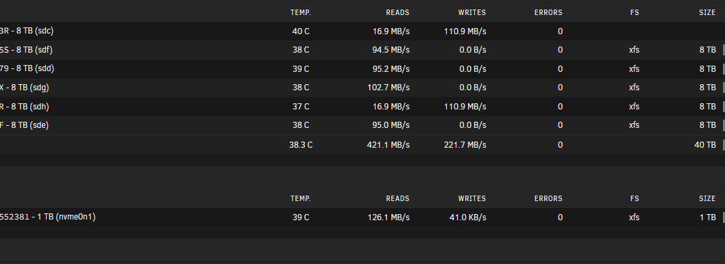

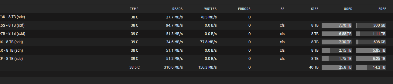

Behaviour with reconstruct write on, still reading from destination drive.
Around 18 months ago i expanded my array by adding another 2 8tb disks, ever since then reconstruct write doesn't seem to work as it should.
With reconstruct write on unraid is still reading from the destination disk and also the parity disk. Slowing down operations to basically read/modify/write speeds. I've ignored it up until now.
Tried to google the answer myself but every post talks about slow write speeds not the fact that disk is still reading when it shouldn't be.
Pre array expansion with 'Turbo write' on i would see pure writing to destination and parity, now you see as below.
Anything i can do to fix this?
File copy from disk 1 > disk 3
Reconstruct write onfirefox_2022-08-24_19-01-54.thumb.png.c6e71a8f94d20f49c2d007506a3d0fe9.png
Reconstruct write offfirefox_2022-08-24_19-00-49.thumb.png.0cce433f8ed3e4dd9f2084841c12bf4e.png

That's because you're also reading from the array, when you do so it'll bounce back and forth between both modes. If your copy source is not on the array you'll see what you expect.
Full speed reconstruct write needs full read bandwidth from all drives, so if you're also reading from one it'll be impossible to achieve and you'll end up with pretty much the same situation than read-modify-write where a disk has to seek back and forth.

With reconstruct write / turbo write on you can copy and move files between disks in the array without any speed penalty. Which is how it was working before adding extra drives.
No you cannot, it's as mentioned above.

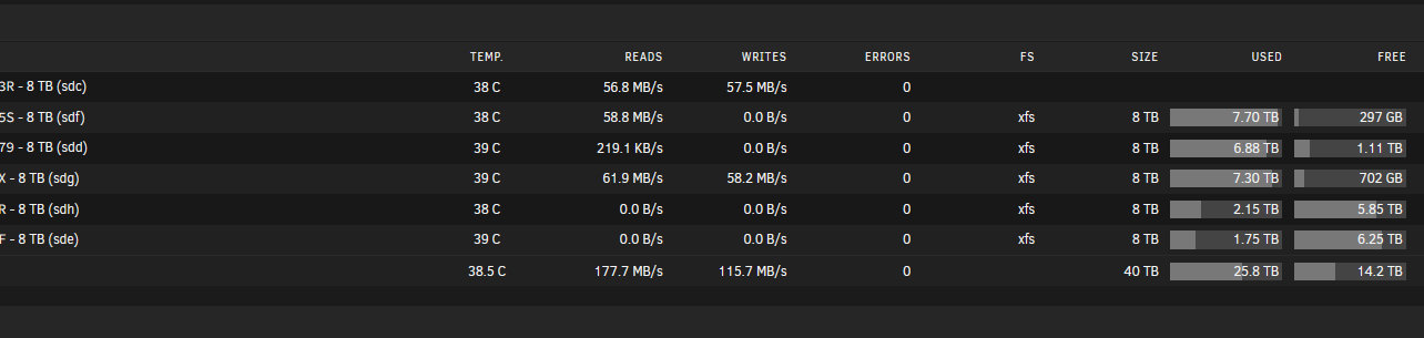

Ok. Here is a copy from cache drive to drive 4 with turbo write enabled. Exhibits the same behaviour albeit with less reading.
Something else is still reading from that drive.
Yeah and that's my issue. What could it be? Or how can i find it.
You can try the "Open Files" plugin.
