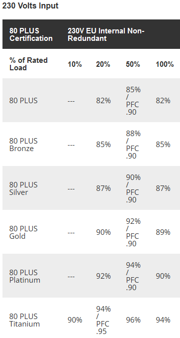

If you can afford, get the one with the highest 80 Plus rating - Titanium, or the next down, Platinum.
The Titanium rated PSU must be at least 90% efficient at 10% load, which would make it the most efficient one at idle where media servers normally spend the vast majority of their time.
