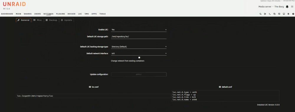

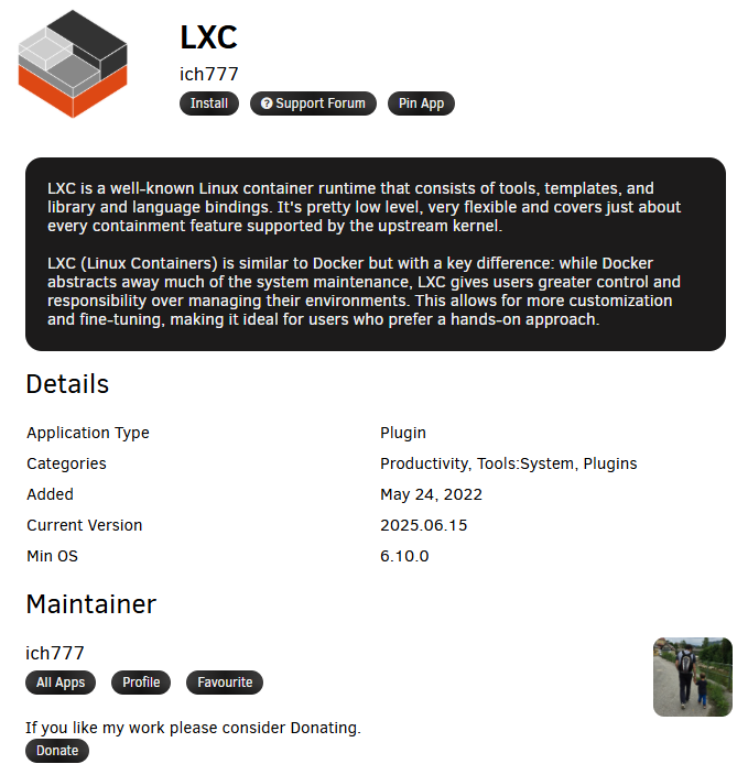

this project requires ich777 lxc plugin installed.
enable anc configure the volume path
This is akin to the appdata folder where the sytem lives...

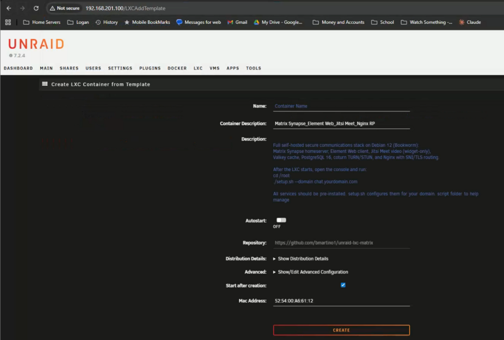

Unraid Installation
Step 1 --- Download the LXC Template
Open a terminal on your Unraid server and run:
wget -O /tmp/lxc_container_template.xml \
https://raw.githubusercontent.com/bmartino1/unraid-lxc-matrix/main/lxc_container_template.xml
Step 2 --- Import the Template
/LXCAddTemplate
Open the Unraid LXC template page:
http://<Your_UnRAID_IP>/LXCAddTemplate
Example:
http://192.168.1.10/LXCAddTemplate
Unraid will automatically detect the downloaded template.
Give the continer a name example matrix.
Click create and wait for the done button.

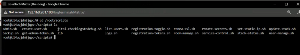

Then open the terminal
then run the scirpts in this order
/root/scripts/set-static-ip.sh
You MUST SET A STATIC IP!

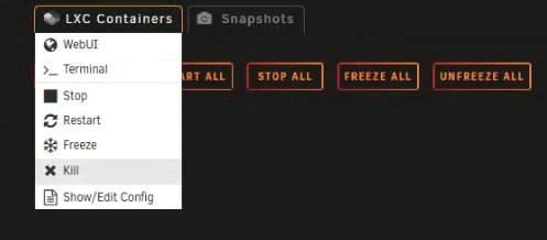

⚠️ After setting the static IP, fully stop and start the LXC (do not just restart). The new IP will not take effect until a full stop/start cycle.
stop the lxc start the lxc
* You may need to scroll down for the menu to apear...
If you do't stop start you willhave the dhcp ip and static ip and script will not run coreclty...

then run the setup script.
/root/setup.sh --domain chat.yourPublicdomain.com --admin-pass ChangeMe
then 2 side scirpts to have admin script work
#Some admin script require teh admin token to do things,,,
/root/scripts/get-admin-token.sh
#adds token to matrix.env for scritps...

Many Thanks To @ich777 with ich777 for ther OG assistance on a LXC templte in the past...
