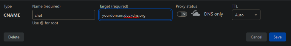

DNS Setup:
• Create a CNAME record pointed to your unraid server.
• I'll be using the "chat" subdomain in this guide but you can use what you'd like.
(If you're on Cloudflare and want federation "Proxy status" has to be toggled to "DNS only". It works internally with a proxy but I couldn't communicate with other matrix servers).

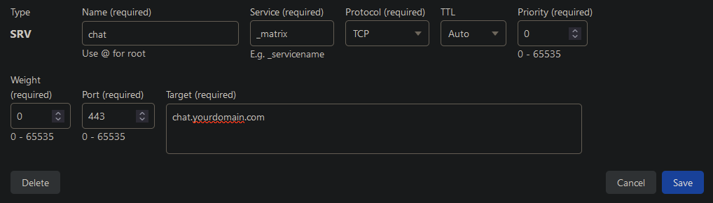

• Create an SRV record for the service _matrix targeted at your subdomain like so:

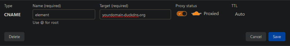

• Create a CNAME record for element pointed to your unraid server:

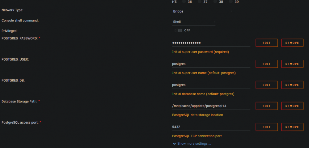

Postgres Database Setup:
Matrix defaults to an SQLite database, but performance is better with postgres. Before installing matrix we'll prepare a database.

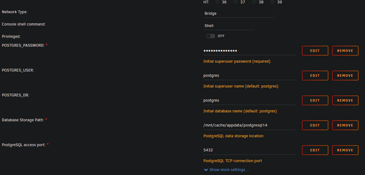

• Search CA for "postgres" and install postgresql14 from jj9987.
• Set a superuser password and leave the rest on default.
• After installing open the console and enter the following commands to set a password for the default postgres user:
su
passwd postgres
Now exit out of su (type: "exit") and login (type: "login") as the user postgres with the password you just created.
Now we're going to create a superuser in the maintenance database named "matrix" in psql by running the following commands:
psql
CREATE USER matrix SUPERUSER PASSWORD 'passwordstring';
(replace passwordstring with your own password but leave the quotes)

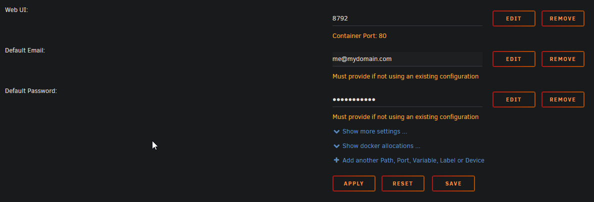

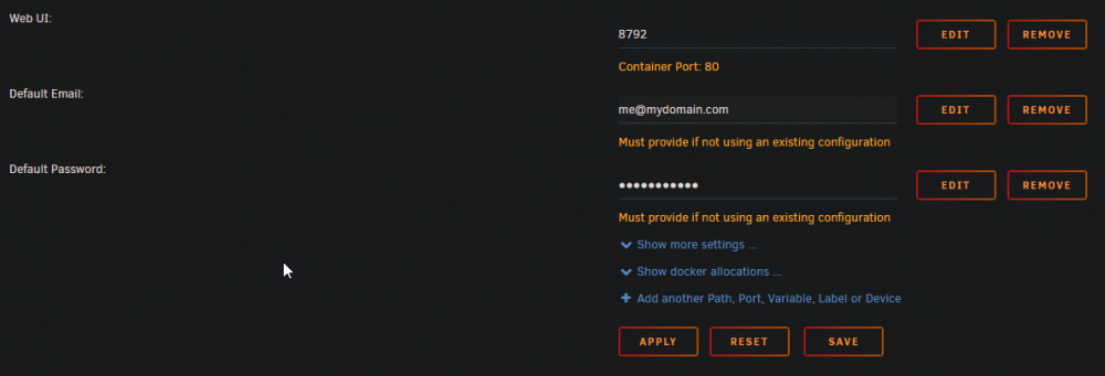

Now that we have a database superuser setup lets install pgadmin4 to make administration easier. Search CA for pgadmin4 and grab the one from FoxxMD. Enter an email/password into the template - email doesn't need to be functional it's just serving as a username.
(It can take a minute to load after install so be patient with it.)

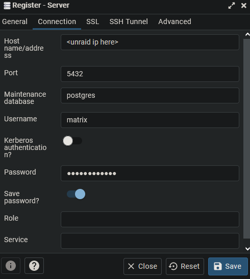

• Login to pgadmin with the the email/password you just set.
• Select Add New Server and give it a name (I used my unraid server name)
• Go to the Connections tab and specify your unraid server IP in the host field.
• Enter the database user matrix and passwordstring that you created above in psql.

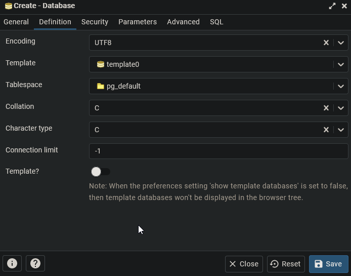

• Click Save and you should see your server pop up on the list to the left. Right click it and select Create > Database
• Give the database a name (I named it matrix) and go to the Definition tab. Set everything just like this:
• Click Save and you should see the database show up on the left.

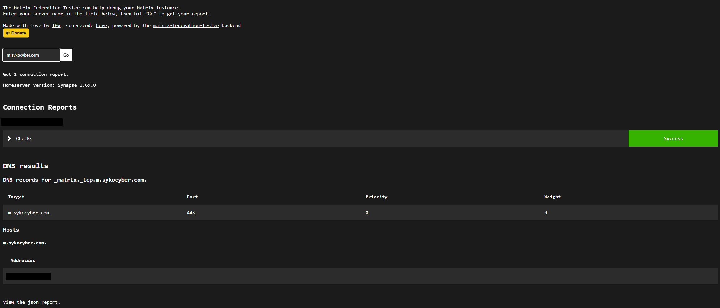

You should now have a functional matrix server. Feel free to log in and try it out. Visit https://federationtester.matrix.org/ to test federation.

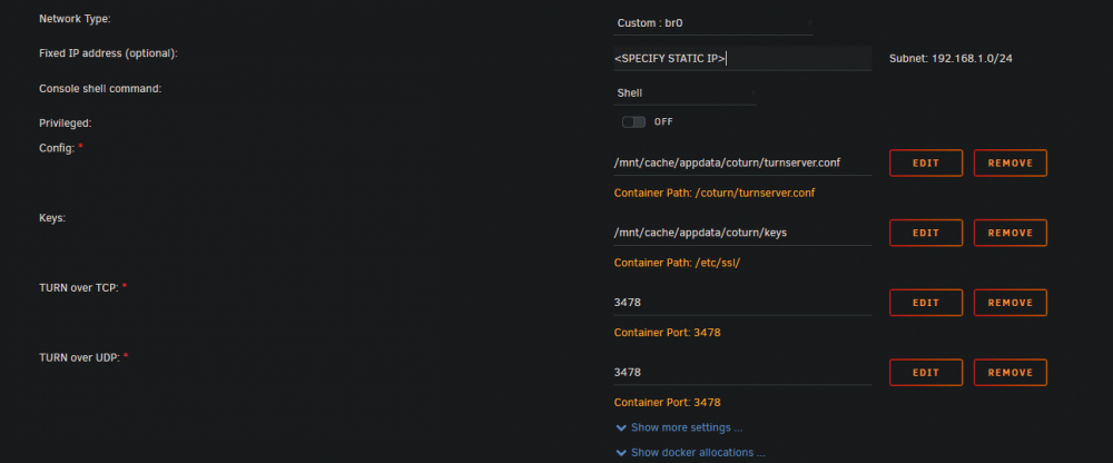

Coturn Setup:

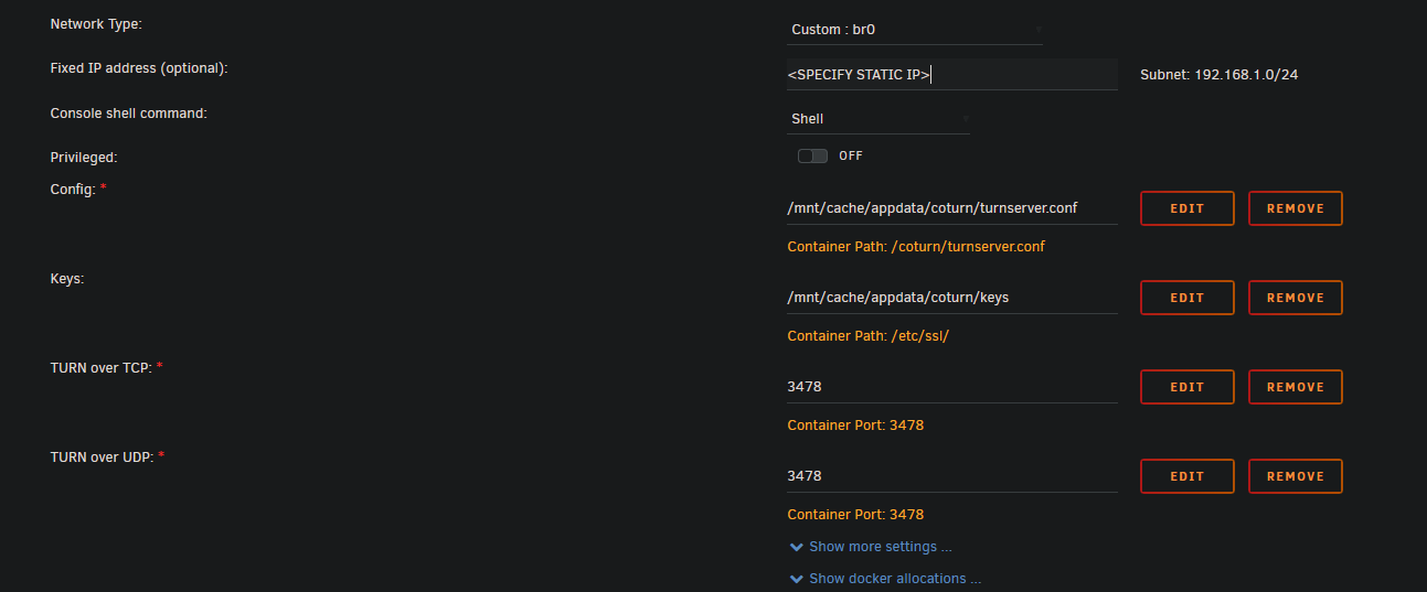

• Search for coturn by xthursdayx on CA.
• Change Network Type to "Custom: br0" and give it its own static IP on your LAN
• Delete all ports from template except 3478 TCP & UDP.
• Install
Next go to your firewall settings and forward the following ports:
WAN UDP 3478 -> coturn static ip
WAN UDP range 49152:49172 -> coturn static ip
And lastly we have to edit our coturn settings. Navigate to /appdata/coturn and edit turnserver.conf so it looks like this:
listening-port=3478
listening-ip=0.0.0.0
external-ip=COTURNIP
min-port=49152
max-port=49172
lt-cred-mech
use-auth-secret
static-auth-secret=TURN_SHARED_SECRET
total-quota=100
stale-nonce=600
realm=chat.yourdomain.com
server-name=chat.yourdomain.com
• Change COTURNIP to the static IP you gave the coturn docker
• Change TURN_SHARED_SECRET to the key you generated for that field in your homeserver.yaml file above.
• Change realm and server-name to your subdomain.
That's it. We're finally done. Make sure to restart coturn to apply your settings and then give it a try.
(https://icetest.info/ is a great TURN troubleshooting tool if you have issues).
Also I recommend installing synapse-admin from A75G in CA for easier administration. (Install with all defaults and login with the admin user you just created above).
• Install

Coturn Setup:
• Install
listening-port=3478
min-port=49152
max-port=49172
lt-cred-mech
use-auth-secret
total-quota=100
stale-nonce=600
