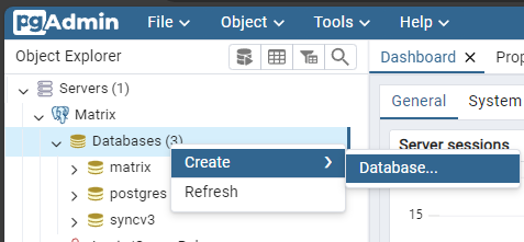

  • For anyone looking for a guide on how I did this, here it is.   Login to pgAdmin4. On the left expand Server > Matrix > Databases, then right click Databases then go Create > Databa

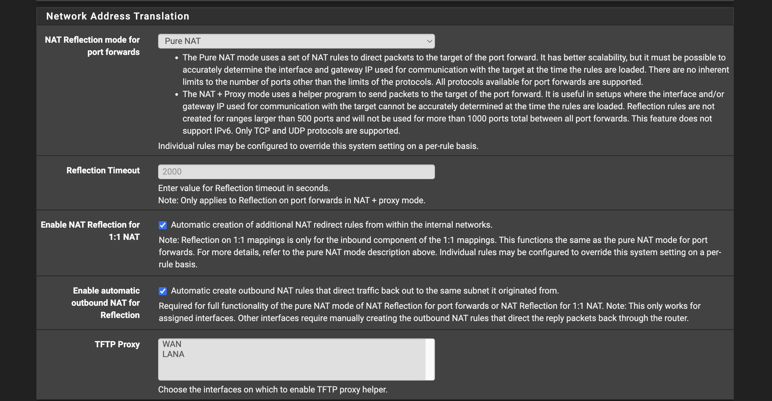

16 hours ago, Gazeley said:
Hi @strauberry, I seem to remember having a similar network issue and for me the magic solution was this setting in opnsense. Do you have something similar in pfsense and is it checked?
Thank you so much @Gazeley this was the missing piece. It was an enormous relief to wake up to your message here today.
EDIT: ignore the 1:1 checkbox, that was not necessary I wound up removing that setting when I learned more about it
67605908_Screenshot2023-03-15at1_21_18PM.thumb.png.411777f2e2c3f06cefa30854c408b0e7.png
Although admittedly I do not yet really have a full comprehension of why this worked, these settings just fixed all my problems:
- Set NAT Reflection mode for Port Forwards to "Pure NAT"
- Enable NAT Reflection for 1:1 NAT
- Enable automatic outbound NAT for Reflection
I can now access synapse-admin without issue, along with the element-ui subdomain in my browser. Everything just works now as expected. I will be able to move forward in the guide now long to the COTURN section and begin making customizations to my homeserver.yaml now.
So much appreciated, have a great week.
Edited by strauberry
Correction

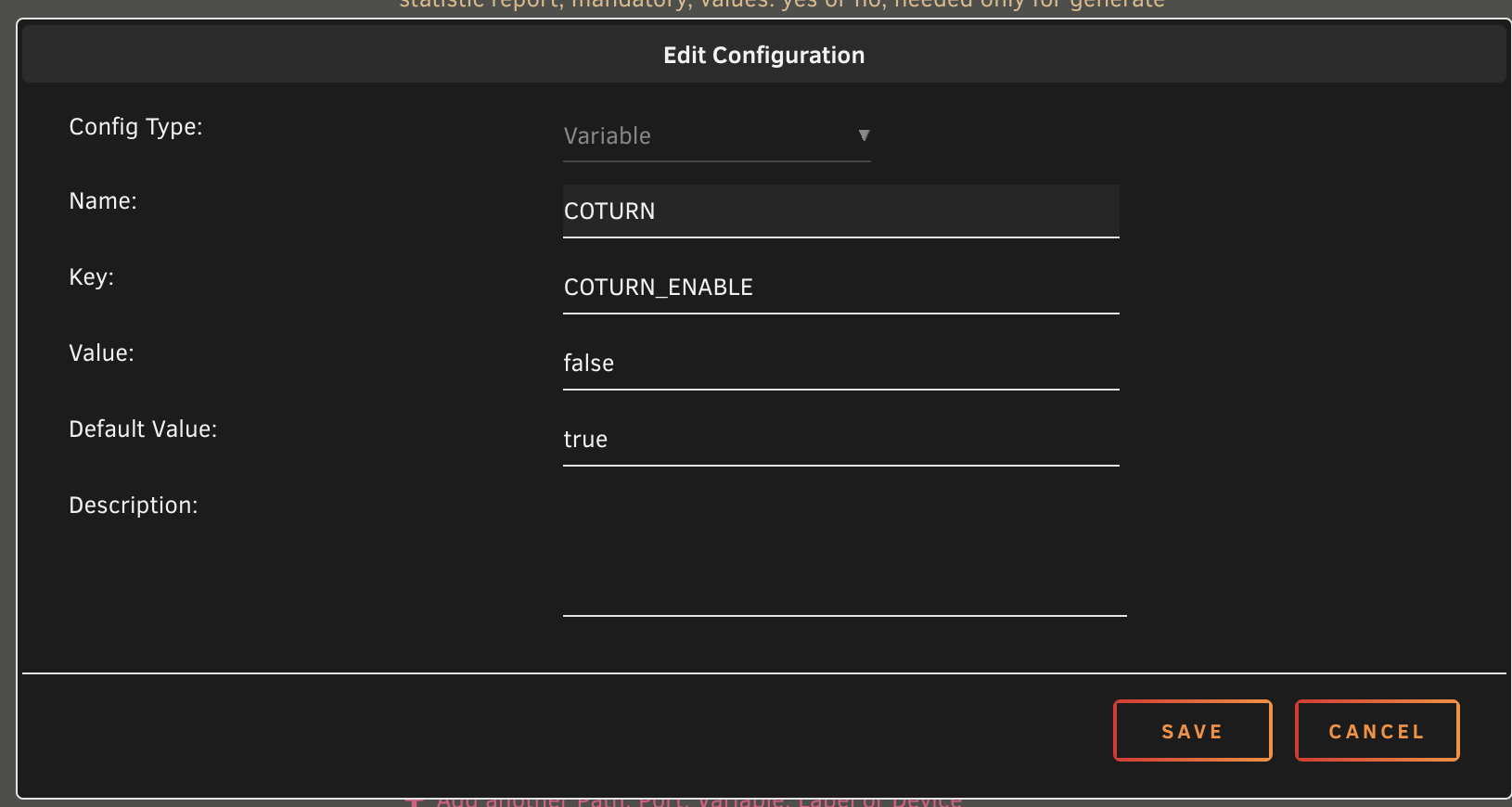

I have discovered one last thing worth mentioning while going through the effort to get my COTURN server working on SSL.
It looks like the matrix synapse Docker package that we are using already contains a COTURN server in it by default: https://github.com/AVENTER-UG/docker-matrix
This is why we see a whole bunch of warning and turn related output in the logs for the matrix container. It took me a while to realize what was actually happening. We probably don't want two different turn servers running like this?
They do provide a way of changing this behavior via Environment Variable of COTURN_ENABLE="false"
I'm testing out if everything is stable right now after adding this variable to my Matrix Container so we don't have two COTURN services running:

  1. Login to pgAdmin4. On the left expand Server > Matrix > Databases, then right click Databases then go Create > Database...
    Then in the Database field type "syncv3" then click "Save"
