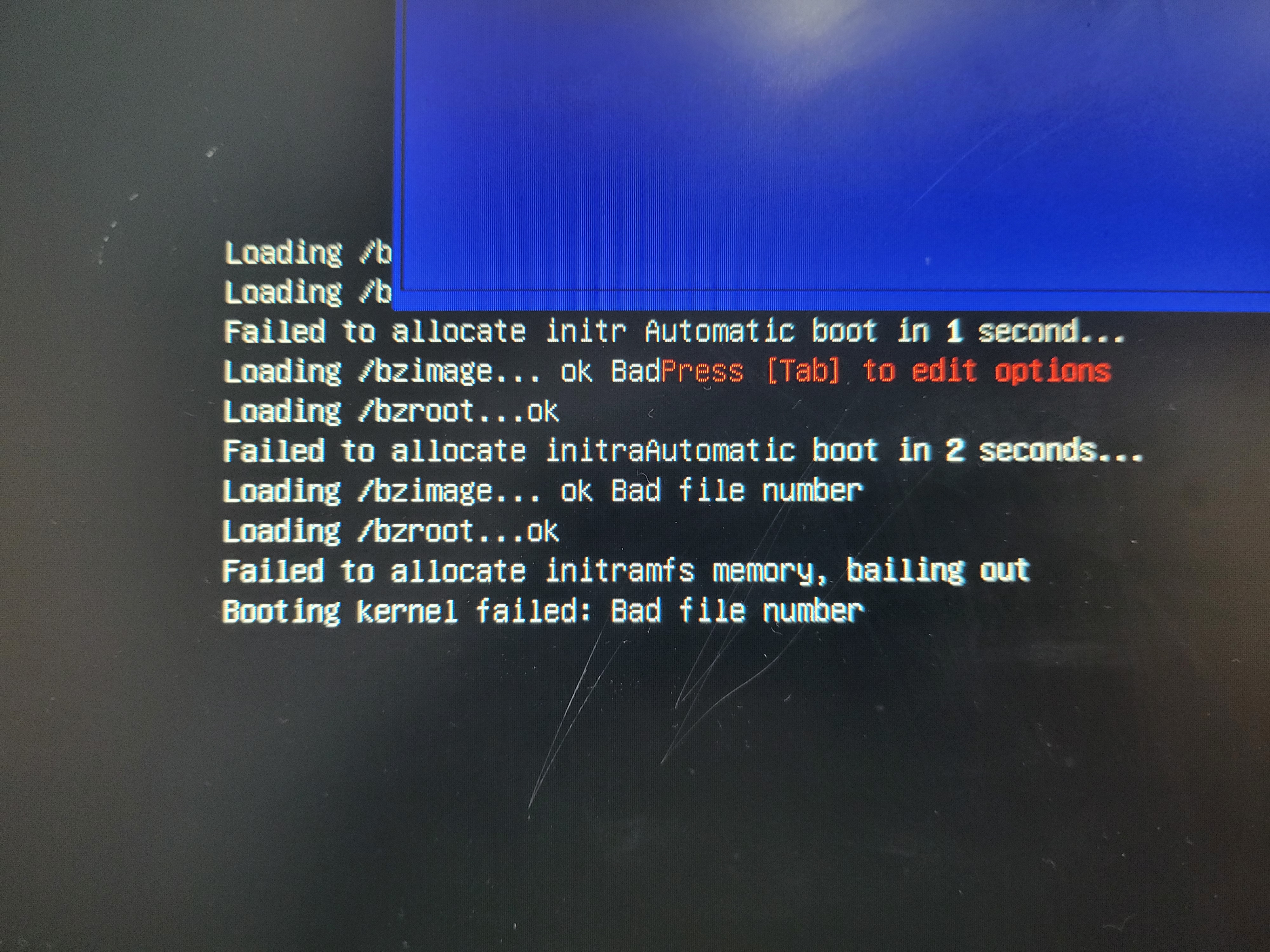

I just finished installing another power supply that I had lying around which is bigger and more efficient than the one I was using. I also installed another graphics card; I already had a 1080ti installed which handles Plex work, so the additional video card (1080) I was planning send through a couple VM's that I use. After doing all this, I go to start it up, and I get a message on the screen (which was plugged into the internal graphics port and which I don't usually have connected) saying it had detected over current in a USB drive and would shut down. So it shuts down and I disconnect the 2 USB drives that were connected, and I try and start it up again. I then get a different message that it keeps repeating:
Thinking it might be the thumb drive, I put it in a windows machine, but it doesn't detect any errors. Just to be certain, I grab a copy of the config file and the licence, and I use the USB creator to write a new system onto it, and then I copy back on to it the config folder and the licence. I then attempt to start it again, but I get the same message as before.
I then decide to remove the second video card, and after doing so it starts up.
Could this second video card really cause this issue?

Try booting in CSM/legacy mode, i.e., no UEFI.
But it's working fine now, and has been running great prior to this.
I'm worried that maybe something is on its way out and/or something serious could occur...
If it's working fine let it be, if it happens again try booting legacy.
