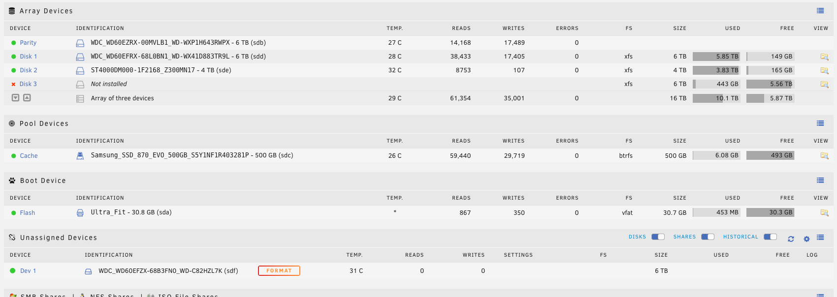

October 18, 20224 yr Author On 10/12/2022 at 10:24 AM, JorgeB said: Disk3 has a failing now SMART attribute, you need to replace it, reboot to clear the logs, unassign disk3, start the array and post new diags. Hi, I have now replaced disk 3 with a drive of the same capacity, and it is unassigned. With the array started it shows as "Not installed". Here are the logs: nebula-diagnostics-20221018-0647.zip

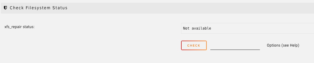

October 18, 20224 yr Author I have added "v" so the command is -nv, and clicked on the "Check" button for disk 3. As noted in the toggled help text, there is no visual change on the page to indicate the check has started. It advises to "verify the operation is running by observing the read/write counters increasing for the device on the Main page" but as the disk is not installed, the read/write columns are blank. Is there a way to verify the check operation is running? Edited October 18, 20224 yr by gooner_47
October 18, 20224 yr Author I have removed -n, clicked Check and am in the same situation as my previous post. Nothing changes on the page, visually nothing is happening.
October 18, 20224 yr Community Expert 1 hour ago, gooner_47 said: As noted in the toggled help text, there is no visual change on the page to indicate the check has started. It advises to "verify the operation is running by observing the read/write counters increasing for the device on the Main page" but as the disk is not installed, the read/write columns are blank. No sure what you mean, it should open a filesystem check window, but do it on the console instead, type: xfs_repair -v /dev/md3
October 18, 20224 yr Author On this screen, when I click the "Check" button, nothing happens. It does not open a filesystem check window. I do not get any notification from Chrome that a popup is being blocked either, so not sure what is going on there. Running your command from the console gave the following: root@Nebula:~# xfs_repair -v /dev/md3 Phase 1 - find and verify superblock... - block cache size set to 237856 entries Phase 2 - using internal log - zero log... zero_log: head block 37421 tail block 37421 - scan filesystem freespace and inode maps... Metadata CRC error detected at 0x439496, xfs_agf block 0x7ffffff9/0x200 agf has bad CRC for ag 1 Metadata CRC error detected at 0x4643f6, xfs_agi block 0x7ffffffa/0x200 agi has bad CRC for ag 1 bad magic # 0x0 for agf 1 bad version # 0 for agf 1 bad sequence # 0 for agf 1 bad length 0 for agf 1, should be 268435455 bad uuid 00000000-0000-0000-0000-000000000000 for agf 1 bad magic # 0x0 for agi 1 bad version # 0 for agi 1 bad sequence # 0 for agi 1 bad length # 0 for agi 1, should be 268435455 bad uuid 00000000-0000-0000-0000-000000000000 for agi 1 reset bad agf for ag 1 reset bad agi for ag 1 bad agbno 0 for btbno root, agno 1 bad agbno 0 for btbcnt root, agno 1 bad agbno 0 for refcntbt root, agno 1 agf_freeblks 938, counted 0 in ag 1 bad agbno 0 for inobt root, agno 1 bad agbno 0 for finobt root, agno 1 agi_freecount 24, counted 0 in ag 1 agi_freecount 24, counted 0 in ag 1 finobt agi unlinked bucket 0 is 0 in ag 1 (inode=2147483648) agi unlinked bucket 1 is 0 in ag 1 (inode=2147483648) agi unlinked bucket 2 is 0 in ag 1 (inode=2147483648) agi unlinked bucket 3 is 0 in ag 1 (inode=2147483648) agi unlinked bucket 4 is 0 in ag 1 (inode=2147483648) agi unlinked bucket 5 is 0 in ag 1 (inode=2147483648) agi unlinked bucket 6 is 0 in ag 1 (inode=2147483648) agi unlinked bucket 7 is 0 in ag 1 (inode=2147483648) agi unlinked bucket 8 is 0 in ag 1 (inode=2147483648) agi unlinked bucket 9 is 0 in ag 1 (inode=2147483648) agi unlinked bucket 10 is 0 in ag 1 (inode=2147483648) agi unlinked bucket 11 is 0 in ag 1 (inode=2147483648) agi unlinked bucket 12 is 0 in ag 1 (inode=2147483648) agi unlinked bucket 13 is 0 in ag 1 (inode=2147483648) agi unlinked bucket 14 is 0 in ag 1 (inode=2147483648) agi unlinked bucket 15 is 0 in ag 1 (inode=2147483648) agi unlinked bucket 16 is 0 in ag 1 (inode=2147483648) agi unlinked bucket 17 is 0 in ag 1 (inode=2147483648) agi unlinked bucket 18 is 0 in ag 1 (inode=2147483648) agi unlinked bucket 19 is 0 in ag 1 (inode=2147483648) agi unlinked bucket 20 is 0 in ag 1 (inode=2147483648) agi unlinked bucket 21 is 0 in ag 1 (inode=2147483648) agi unlinked bucket 22 is 0 in ag 1 (inode=2147483648) agi unlinked bucket 23 is 0 in ag 1 (inode=2147483648) agi unlinked bucket 24 is 0 in ag 1 (inode=2147483648) agi unlinked bucket 25 is 0 in ag 1 (inode=2147483648) agi unlinked bucket 26 is 0 in ag 1 (inode=2147483648) agi unlinked bucket 27 is 0 in ag 1 (inode=2147483648) agi unlinked bucket 28 is 0 in ag 1 (inode=2147483648) agi unlinked bucket 29 is 0 in ag 1 (inode=2147483648) agi unlinked bucket 30 is 0 in ag 1 (inode=2147483648) agi unlinked bucket 31 is 0 in ag 1 (inode=2147483648) agi unlinked bucket 32 is 0 in ag 1 (inode=2147483648) agi unlinked bucket 33 is 0 in ag 1 (inode=2147483648) agi unlinked bucket 34 is 0 in ag 1 (inode=2147483648) agi unlinked bucket 35 is 0 in ag 1 (inode=2147483648) agi unlinked bucket 36 is 0 in ag 1 (inode=2147483648) agi unlinked bucket 37 is 0 in ag 1 (inode=2147483648) agi unlinked bucket 38 is 0 in ag 1 (inode=2147483648) agi unlinked bucket 39 is 0 in ag 1 (inode=2147483648) agi unlinked bucket 40 is 0 in ag 1 (inode=2147483648) agi unlinked bucket 41 is 0 in ag 1 (inode=2147483648) agi unlinked bucket 42 is 0 in ag 1 (inode=2147483648) agi unlinked bucket 43 is 0 in ag 1 (inode=2147483648) agi unlinked bucket 44 is 0 in ag 1 (inode=2147483648) agi unlinked bucket 45 is 0 in ag 1 (inode=2147483648) agi unlinked bucket 46 is 0 in ag 1 (inode=2147483648) agi unlinked bucket 47 is 0 in ag 1 (inode=2147483648) agi unlinked bucket 48 is 0 in ag 1 (inode=2147483648) agi unlinked bucket 49 is 0 in ag 1 (inode=2147483648) agi unlinked bucket 50 is 0 in ag 1 (inode=2147483648) agi unlinked bucket 51 is 0 in ag 1 (inode=2147483648) agi unlinked bucket 52 is 0 in ag 1 (inode=2147483648) agi unlinked bucket 53 is 0 in ag 1 (inode=2147483648) agi unlinked bucket 54 is 0 in ag 1 (inode=2147483648) agi unlinked bucket 55 is 0 in ag 1 (inode=2147483648) agi unlinked bucket 56 is 0 in ag 1 (inode=2147483648) agi unlinked bucket 57 is 0 in ag 1 (inode=2147483648) agi unlinked bucket 58 is 0 in ag 1 (inode=2147483648) agi unlinked bucket 59 is 0 in ag 1 (inode=2147483648) agi unlinked bucket 60 is 0 in ag 1 (inode=2147483648) agi unlinked bucket 61 is 0 in ag 1 (inode=2147483648) agi unlinked bucket 62 is 0 in ag 1 (inode=2147483648) agi unlinked bucket 63 is 0 in ag 1 (inode=2147483648) sb_icount 2176, counted 1792 sb_ifree 227, counted 186 sb_fdblocks 1350187333, counted 1100481525 - found root inode chunk Phase 3 - for each AG... - scan and clear agi unlinked lists... - process known inodes and perform inode discovery... - agno = 0 - agno = 1 - agno = 2 - agno = 3 - agno = 4 - agno = 5 - process newly discovered inodes... Phase 4 - check for duplicate blocks... - setting up duplicate extent list... - check for inodes claiming duplicate blocks... - agno = 0 entry "TV Shows" in shortform directory 128 references non-existent inode 2147483780 junking entry "TV Shows" in directory inode 128 entry "Logs" in shortform directory 131 references non-existent inode 2147483776 junking entry "Logs" in directory inode 131 entry "Images" in shortform directory 131 references non-existent inode 2147483778 junking entry "Images" in directory inode 131 entry "m3u8" in shortform directory 132 references non-existent inode 2147483777 junking entry "m3u8" in directory inode 132 entry "config" in shortform directory 148 references non-existent inode 2147483785 junking entry "config" in directory inode 148 entry ".." at block 0 offset 80 in directory inode 183 references non-existent inode 2147483781 entry "templates-user" in shortform directory 2053967 references non-existent inode 2147485032 junking entry "templates-user" in directory inode 2053967 - agno = 1 - agno = 2 entry ".." at block 0 offset 80 in directory inode 4294967424 references non-existent inode 2147483776 entry "727" at block 0 offset 416 in directory inode 4294967424 references non-existent inode 2159524292 clearing inode number in entry at offset 416... entry "750" at block 0 offset 768 in directory inode 4294967424 references non-existent inode 2147485006 clearing inode number in entry at offset 768... entry "760" at block 0 offset 944 in directory inode 4294967424 references non-existent inode 2147485025 clearing inode number in entry at offset 944... entry "762" at block 0 offset 976 in directory inode 4294967424 references non-existent inode 2147484995 clearing inode number in entry at offset 976... entry "766" at block 0 offset 1040 in directory inode 4294967424 references non-existent inode 2147485016 clearing inode number in entry at offset 1040... entry "770" at block 0 offset 1104 in directory inode 4294967424 references non-existent inode 2147484998 clearing inode number in entry at offset 1104... entry "779" at block 0 offset 1248 in directory inode 4294967424 references non-existent inode 2147487307 clearing inode number in entry at offset 1248... entry "781" at block 0 offset 1280 in directory inode 4294967424 references non-existent inode 2147487315 clearing inode number in entry at offset 1280... entry ".." at block 0 offset 80 in directory inode 4294967429 references non-existent inode 2147483781 - agno = 3 entry "backup-20220808.231132" at block 0 offset 1456 in directory inode 6446624904 references non-existent inode 2159524289 clearing inode number in entry at offset 1456... - agno = 4 entry ".." at block 0 offset 80 in directory inode 8589934720 references non-existent inode 2147483776 entry "726" at block 0 offset 416 in directory inode 8589934720 references non-existent inode 2159524290 clearing inode number in entry at offset 416... entry "731" at block 0 offset 496 in directory inode 8589934720 references non-existent inode 2159524304 clearing inode number in entry at offset 496... entry "752" at block 0 offset 832 in directory inode 8589934720 references non-existent inode 2147485030 clearing inode number in entry at offset 832... entry "758" at block 0 offset 928 in directory inode 8589934720 references non-existent inode 2147485021 clearing inode number in entry at offset 928... entry "765" at block 0 offset 1040 in directory inode 8589934720 references non-existent inode 2147485019 clearing inode number in entry at offset 1040... entry "772" at block 0 offset 1152 in directory inode 8589934720 references non-existent inode 2159524327 clearing inode number in entry at offset 1152... entry "773" at block 0 offset 1168 in directory inode 8589934720 references non-existent inode 2147485001 clearing inode number in entry at offset 1168... entry "777" at block 0 offset 1232 in directory inode 8589934720 references non-existent inode 2147487303 clearing inode number in entry at offset 1232... entry "backup-20220818.011555" at block 0 offset 1896 in directory inode 6446624904 references non-existent inode 2147485003 clearing inode number in entry at offset 1896... entry ".." at block 0 offset 80 in directory inode 8589934771 references non-existent inode 2147483778 entry "a5" at block 0 offset 128 in directory inode 8589934771 references non-existent inode 2147483804 clearing inode number in entry at offset 128... entry "8d" at block 0 offset 224 in directory inode 8589934771 references non-existent inode 2147483806 clearing inode number in entry at offset 224... entry "ad" at block 0 offset 320 in directory inode 8589934771 references non-existent inode 2147483809 clearing inode number in entry at offset 320... entry "9a" at block 0 offset 416 in directory inode 8589934771 references non-existent inode 2147483813 clearing inode number in entry at offset 416... entry "37" at block 0 offset 512 in directory inode 8589934771 references non-existent inode 2147483815 clearing inode number in entry at offset 512... entry "53" at block 0 offset 608 in directory inode 8589934771 references non-existent inode 2147483818 clearing inode number in entry at offset 608... entry "31" at block 0 offset 704 in directory inode 8589934771 references non-existent inode 2147483820 clearing inode number in entry at offset 704... entry "1d" at block 0 offset 800 in directory inode 8589934771 references non-existent inode 2147483822 clearing inode number in entry at offset 800... entry "d4" at block 0 offset 896 in directory inode 8589934771 references non-existent inode 2147483824 clearing inode number in entry at offset 896... entry "78" at block 0 offset 1024 in directory inode 8589934771 references non-existent inode 2152013001 clearing inode number in entry at offset 1024... entry "84" at block 0 offset 1120 in directory inode 8589934771 references non-existent inode 2152013003 clearing inode number in entry at offset 1120... entry "58" at block 0 offset 1216 in directory inode 8589934771 references non-existent inode 2152013007 clearing inode number in entry at offset 1216... entry "7e" at block 0 offset 1312 in directory inode 8589934771 references non-existent inode 2152013009 clearing inode number in entry at offset 1312... entry "6a" at block 0 offset 1328 in directory inode 8589934771 references non-existent inode 2152013013 clearing inode number in entry at offset 1328... entry "e3" at block 0 offset 1424 in directory inode 8589934771 references non-existent inode 2152013015 clearing inode number in entry at offset 1424... entry "61" at block 0 offset 1568 in directory inode 8589934771 references non-existent inode 2152013020 clearing inode number in entry at offset 1568... entry "b4" at block 0 offset 1664 in directory inode 8589934771 references non-existent inode 2152013023 clearing inode number in entry at offset 1664... entry "04" at block 0 offset 1728 in directory inode 8589934771 references non-existent inode 2152013026 clearing inode number in entry at offset 1728... entry "76" at block 0 offset 1824 in directory inode 8589934771 references non-existent inode 2152013029 clearing inode number in entry at offset 1824... entry "41" at block 0 offset 1920 in directory inode 8589934771 references non-existent inode 2152013032 clearing inode number in entry at offset 1920... entry "81" at block 0 offset 2016 in directory inode 8589934771 references non-existent inode 2152013035 clearing inode number in entry at offset 2016... entry "03" at block 0 offset 2112 in directory inode 8589934771 references non-existent inode 2152013037 clearing inode number in entry at offset 2112... entry "b7" at block 0 offset 2288 in directory inode 8589934771 references non-existent inode 2152013046 clearing inode number in entry at offset 2288... entry "66" at block 0 offset 2384 in directory inode 8589934771 references non-existent inode 2152013052 clearing inode number in entry at offset 2384... entry "a2" at block 0 offset 2480 in directory inode 8589934771 references non-existent inode 2156991488 clearing inode number in entry at offset 2480... entry "0a" at block 0 offset 2576 in directory inode 8589934771 references non-existent inode 2156991492 clearing inode number in entry at offset 2576... entry "da" at block 0 offset 2608 in directory inode 8589934771 references non-existent inode 2156991495 clearing inode number in entry at offset 2608... entry "0e" at block 0 offset 2704 in directory inode 8589934771 references non-existent inode 2159524299 clearing inode number in entry at offset 2704... entry "45" at block 0 offset 2816 in directory inode 8589934771 references non-existent inode 2159524312 clearing inode number in entry at offset 2816... entry "b3" at block 0 offset 2912 in directory inode 8589934771 references non-existent inode 2159524315 clearing inode number in entry at offset 2912... entry "fe" at block 0 offset 2992 in directory inode 8589934771 references non-existent inode 2159524319 clearing inode number in entry at offset 2992... entry "59" at block 0 offset 3088 in directory inode 8589934771 references non-existent inode 2159524321 clearing inode number in entry at offset 3088... entry "f9" at block 0 offset 3120 in directory inode 8589934771 references non-existent inode 2159524323 clearing inode number in entry at offset 3120... entry "b2" at block 0 offset 3184 in directory inode 8589934771 references non-existent inode 2159524325 clearing inode number in entry at offset 3184... entry "60" at block 0 offset 3264 in directory inode 8589934771 references non-existent inode 2159524333 clearing inode number in entry at offset 3264... entry "83" at block 0 offset 3376 in directory inode 8589934771 references non-existent inode 2159524338 clearing inode number in entry at offset 3376... entry "11" at block 0 offset 3504 in directory inode 8589934771 references non-existent inode 2159524344 clearing inode number in entry at offset 3504... entry "aa" at block 0 offset 3552 in directory inode 8589934771 references non-existent inode 2156991517 clearing inode number in entry at offset 3552... entry "54" at block 0 offset 3712 in directory inode 8589934771 references non-existent inode 2147485044 clearing inode number in entry at offset 3712... entry ".." at block 0 offset 80 in directory inode 6446624941 references non-existent inode 2147483780 entry "[email protected]" in shortform directory 6446624956 references non-existent inode 2147485017 junking entry "[email protected]" in directory inode 6446624956 entry ".." at block 0 offset 80 in directory inode 8655897962 references non-existent inode 2147483781 - agno = 5 entry "Location, Location, Location" at block 0 offset 552 in directory inode 10737418370 references non-existent inode 2159524342 clearing inode number in entry at offset 552... entry "Married at First Sight" at block 0 offset 912 in directory inode 10737418370 references non-existent inode 2156991531 clearing inode number in entry at offset 912... entry "This Is 40 (2012)" at block 0 offset 288 in directory inode 10737418371 references non-existent inode 2159524317 clearing inode number in entry at offset 288... entry "Elvis (2022)" at block 0 offset 392 in directory inode 10737418371 references non-existent inode 2159524307 clearing inode number in entry at offset 392... entry ".." at block 0 offset 80 in directory inode 10737418426 references non-existent inode 2147483781 entry ".." at block 0 offset 80 in directory inode 10772335335 references non-existent inode 2147483780 entry ".." at block 0 offset 80 in directory inode 10807526525 references non-existent inode 2147483780 Phase 5 - rebuild AG headers and trees... - agno = 0 - agno = 1 - agno = 2 - agno = 3 - agno = 4 - agno = 5 - reset superblock... Phase 6 - check inode connectivity... - resetting contents of realtime bitmap and summary inodes - traversing filesystem ... - agno = 0 entry ".." in directory inode 183 points to non-existent inode 2147483781, marking entry to be junked bad hash table for directory inode 183 (no data entry): rebuilding rebuilding directory inode 183 - agno = 1 - agno = 2 entry ".." in directory inode 4294967424 points to non-existent inode 2147483776, marking entry to be junked bad hash table for directory inode 4294967424 (no data entry): rebuilding rebuilding directory inode 4294967424 entry ".." in directory inode 4294967429 points to non-existent inode 2147483781, marking entry to be junked bad hash table for directory inode 4294967429 (no data entry): rebuilding rebuilding directory inode 4294967429 - agno = 3 bad hash table for directory inode 6446624904 (no data entry): rebuilding rebuilding directory inode 6446624904 entry ".." in directory inode 6446624941 points to non-existent inode 2147483780, marking entry to be junked bad hash table for directory inode 6446624941 (no data entry): rebuilding rebuilding directory inode 6446624941 - agno = 4 entry ".." in directory inode 8589934720 points to non-existent inode 2147483776, marking entry to be junked bad hash table for directory inode 8589934720 (no data entry): rebuilding rebuilding directory inode 8589934720 entry ".." in directory inode 8589934771 points to non-existent inode 2147483778, marking entry to be junked bad hash table for directory inode 8589934771 (no data entry): rebuilding rebuilding directory inode 8589934771 entry ".." in directory inode 8655897962 points to non-existent inode 2147483781, marking entry to be junked bad hash table for directory inode 8655897962 (no data entry): rebuilding rebuilding directory inode 8655897962 - agno = 5 bad hash table for directory inode 10737418370 (no data entry): rebuilding rebuilding directory inode 10737418370 bad hash table for directory inode 10737418371 (no data entry): rebuilding rebuilding directory inode 10737418371 entry ".." in directory inode 10737418426 points to non-existent inode 2147483781, marking entry to be junked bad hash table for directory inode 10737418426 (no data entry): rebuilding rebuilding directory inode 10737418426 entry ".." in directory inode 10772335335 points to non-existent inode 2147483780, marking entry to be junked bad hash table for directory inode 10772335335 (no data entry): rebuilding rebuilding directory inode 10772335335 entry ".." in directory inode 10807526525 points to non-existent inode 2147483780, marking entry to be junked bad hash table for directory inode 10807526525 (no data entry): rebuilding rebuilding directory inode 10807526525 - traversal finished ... - moving disconnected inodes to lost+found ... disconnected dir inode 149, moving to lost+found disconnected dir inode 183, moving to lost+found disconnected dir inode 2044968, moving to lost+found disconnected dir inode 2044978, moving to lost+found disconnected dir inode 2044988, moving to lost+found disconnected dir inode 2053954, moving to lost+found disconnected dir inode 4294967424, moving to lost+found disconnected dir inode 4294967428, moving to lost+found disconnected dir inode 4294967429, moving to lost+found disconnected dir inode 4294967439, moving to lost+found disconnected dir inode 4294968315, moving to lost+found disconnected dir inode 4320009343, moving to lost+found disconnected dir inode 4322098254, moving to lost+found disconnected dir inode 4322098272, moving to lost+found disconnected dir inode 4330355292, moving to lost+found disconnected dir inode 4330355326, moving to lost+found disconnected dir inode 6446624928, moving to lost+found disconnected dir inode 6446624933, moving to lost+found disconnected dir inode 6446624941, moving to lost+found disconnected dir inode 6446626830, moving to lost+found disconnected dir inode 6537114832, moving to lost+found disconnected dir inode 6537114834, moving to lost+found disconnected dir inode 6537114836, moving to lost+found disconnected dir inode 6537114840, moving to lost+found disconnected dir inode 6537114867, moving to lost+found disconnected dir inode 6537114872, moving to lost+found disconnected dir inode 6537315531, moving to lost+found disconnected dir inode 8589934720, moving to lost+found disconnected dir inode 8589934723, moving to lost+found disconnected dir inode 8589934768, moving to lost+found disconnected dir inode 8589934771, moving to lost+found disconnected dir inode 8654827287, moving to lost+found disconnected dir inode 8654827295, moving to lost+found disconnected dir inode 8654827320, moving to lost+found disconnected dir inode 8654827323, moving to lost+found disconnected dir inode 8655897436, moving to lost+found disconnected dir inode 8655897441, moving to lost+found disconnected dir inode 8655897459, moving to lost+found disconnected dir inode 8655897962, moving to lost+found disconnected dir inode 10737418426, moving to lost+found disconnected dir inode 10744666244, moving to lost+found disconnected dir inode 10772335300, moving to lost+found disconnected dir inode 10772335305, moving to lost+found disconnected dir inode 10772335314, moving to lost+found disconnected dir inode 10772335335, moving to lost+found disconnected dir inode 10772335340, moving to lost+found disconnected dir inode 10807526513, moving to lost+found disconnected dir inode 10807526525, moving to lost+found disconnected dir inode 10807526527, moving to lost+found Phase 7 - verify and correct link counts... resetting inode 128 nlinks from 9 to 8 resetting inode 4294967424 nlinks from 41 to 33 resetting inode 6446624904 nlinks from 32 to 30 resetting inode 6446624956 nlinks from 3 to 2 resetting inode 8589934720 nlinks from 41 to 33 resetting inode 10737418370 nlinks from 18 to 16 resetting inode 10737418371 nlinks from 16 to 14 resetting inode 8589934771 nlinks from 234 to 195 resetting inode 131 nlinks from 7 to 5 resetting inode 132 nlinks from 4 to 3 resetting inode 148 nlinks from 3 to 2 resetting inode 398 nlinks from 2 to 51 resetting inode 2053967 nlinks from 3 to 2 XFS_REPAIR Summary Tue Oct 18 12:25:50 2022 Phase Start End Duration Phase 1: 10/18 12:25:48 10/18 12:25:49 1 second Phase 2: 10/18 12:25:49 10/18 12:25:49 Phase 3: 10/18 12:25:49 10/18 12:25:50 1 second Phase 4: 10/18 12:25:50 10/18 12:25:50 Phase 5: 10/18 12:25:50 10/18 12:25:50 Phase 6: 10/18 12:25:50 10/18 12:25:50 Phase 7: 10/18 12:25:50 10/18 12:25:50 Total run time: 2 seconds done

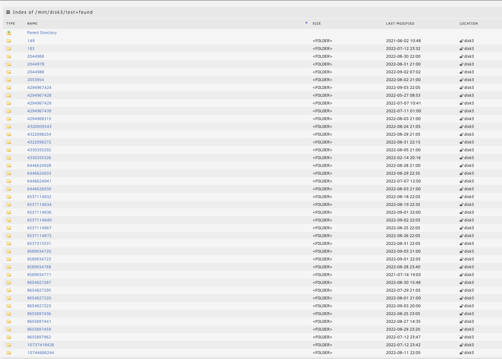

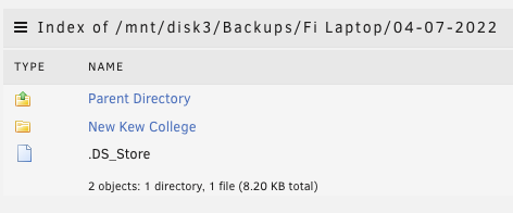

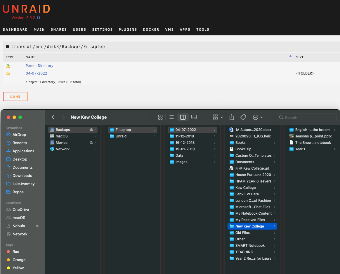

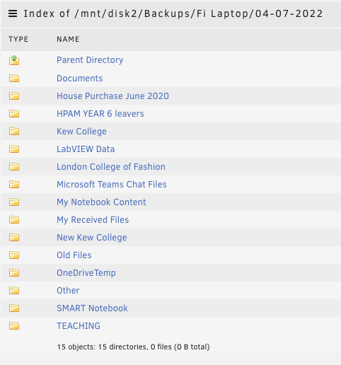

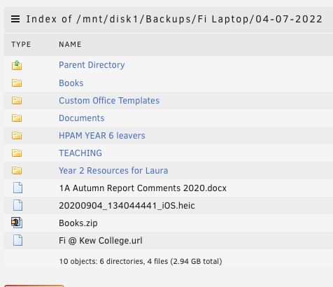

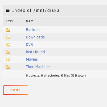

October 18, 20224 yr Author OK I've started the array in normal mode and the emulated disk mounted. The new replacement drive is still unformatted and unassigned. This is what I see when I click on the file explorer for the emulated disk., which is only a subset of the directories on the NAS as a whole - does this mean this is what's stored just on this disk? There are a few folders here which exist, but do not have the contents I would expect to see (and that I do see when comparing to what I can see in finder), is this ok? I also see lots in the lost and found folder. What exactly do I do with these? Edited October 18, 20224 yr by gooner_47
October 18, 20224 yr Community Expert Mount the old disk with UD and compare the data (array must be stopped or you need to change the XFS UUD first in UD), it should be in a better state, if so best to copy everything from there.
October 18, 20224 yr Community Expert 1 hour ago, gooner_47 said: I also see lots in the lost and found folder. What exactly do I do with these? Those are folders for which the repair process could not find the directory information to give them their correct name. You might be able to work out what the folder name should have been by looking at its contents.

October 18, 20224 yr Author 1 hour ago, JorgeB said: To the array. Using what method? Finder? That's how I would usually copy my files. But in finder I already see all of the files I would be expecting. Or do you mean do it somehow within the Unraid UI itself? And if so to which location specifically? - only the emulated disk 3? - or by going to Shares and clicking the file explorer icons on each of the shares in there? What's confusing me is I see repeating folders/data when clicking on each of the disks individually Disk 1 Disk 2 Disk 3
October 18, 20224 yr Community Expert We are only talking about disk3, you can copy from UD to the array using your favorite tool.
October 19, 20224 yr Author 17 hours ago, JorgeB said: Mount the old disk with UD and compare the data (array must be stopped or you need to change the XFS UUD first in UD), it should be in a better state, if so best to copy everything from there. Does the array start automatically when booting the machine? If so will that cause any problems if the old disk 3 is connected? i.e. will these steps work in order to connect the old disk and then mount it with UD: Shut down system Connect old drive Boot up system (will array auto start?) Stop array Mount old disk 3 with UD Compare contents of old disk 3 with emulated disk 3 to determine whether to use that data or not
October 19, 20224 yr Community Expert 1 hour ago, gooner_47 said: Does the array start automatically when booting the machine? Depends on how "Enable auto start" is set in Settings -> Disk Settings, but it's not a problem if the array starts, lets to this step by step, start with connecting the old disk3 to the server, go to UD settings and change the XFS UUID for that disk, then you can have the array started and the old disk mounted at the same time, at that point compare the data from the emulated disk3 with old disk3 to see which one is in better shape, note that old disk3 has a SMART problem error that might indicate that data there cannot always be trusted, though in my experience most or even all should be OK, so it would be a good idea to play/check a few files to make sure it looks good.

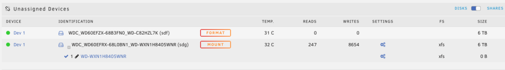

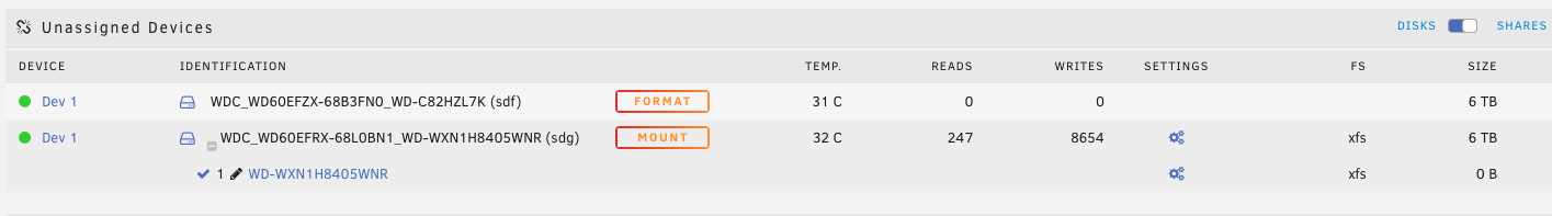

October 19, 20224 yr Author Connected old disk 3, changed UUID in UD settings. Click Mount button and the button text changed to Mounting for about 5 minutes, but it didn't seem to work, button changed back to Mount again. Also noticed writes are increasing, is this expected?
October 19, 20224 yr Community Expert Please post new diags after the mount attempt. 2 hours ago, JorgeB said: note that old disk3 has a SMART problem error that might indicate that data there cannot always be trusted I was confusing this with another thread, this disk will likely have some bad sectors and not be readable, at least not completely, so possibly we'll need to consider a different option, but post the diags first.
