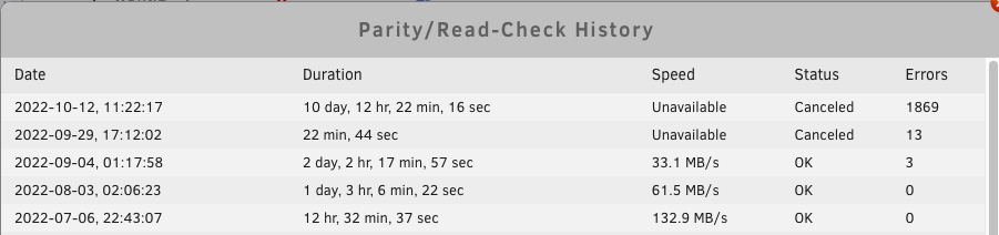

3 minutes ago, JorgeB said:
Do you run regular parity checks?
I do. They run on a monthly schedule
The last successful run was on the 4th September.  Is it possible that the 2 subsequent runs (by which point I believe the drive problems had surfaced) corrupted things?
Yes, if they were set to correct the errors, also note that the previous check already found some errors.

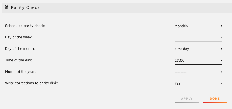

Is that this setting?
"Write corrections to parity disk"
What does Unraid set this to by default? As I’m pretty sure I wouldn’t have changed this setting without knowing the consequences.
If it sets it to “Yes”, wouldn’t it make more sense, based on the advice in this thread, to default it to “No”?
Bump on this.  Just a suggestion for that setting in case it's any improvement, but if it's more suited as it is, then all good.
It would be an improvement, I've made a request to see if it can be changed.
