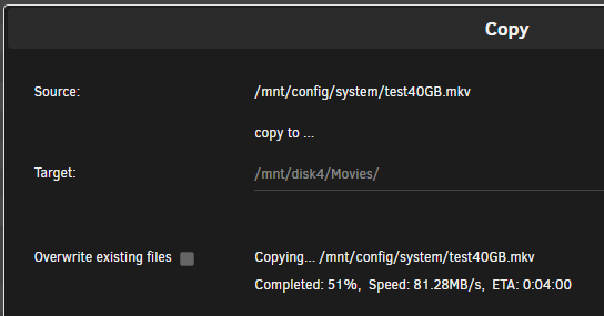

Copy 40GB file from NVME to Cache
Copy 40GB file from NVME to Array (Non Caching)
Bounced between 60 and 85

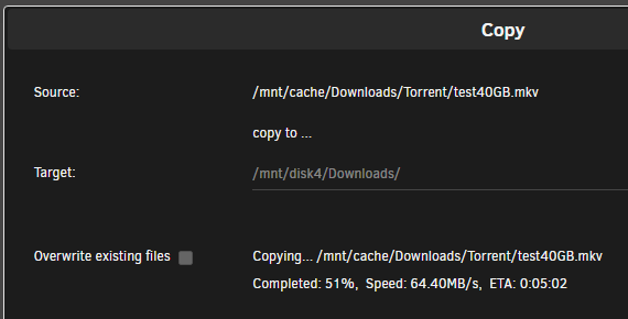

Copy 40GB file from Cache to Array (Non Caching)
Bounced between 50 and 75

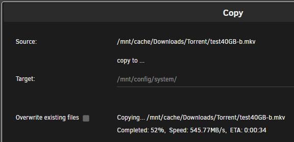

Copy 40GB file from Cache to NVME

- I'm running File Copy from inside the Shares page.
- I feel like I'm seeing virtually the same results whether I Move or Copy, but if I run the tests from within Windows, I see a difference between Move and Copy.
- Moving 1Large File verses Several Small Files
- I took note at about 50% because the numbers had seemingly normalized at that point

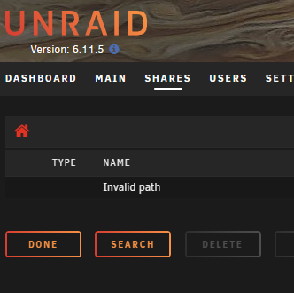

since I am unfamiliar with the available tools, I am trying to get a share available on the ram disk (/dev/shm) but I'm having no luck. I tried creating a softlink (ln -s /dev/shm/test/ /mnt/user/Backup/Test2)within another share to a folder at /dev/shm/test but I get invalid path when I try to look in that on the device:
Am I just barking up the wrong tree or am I making a minor mistake somewhere?
