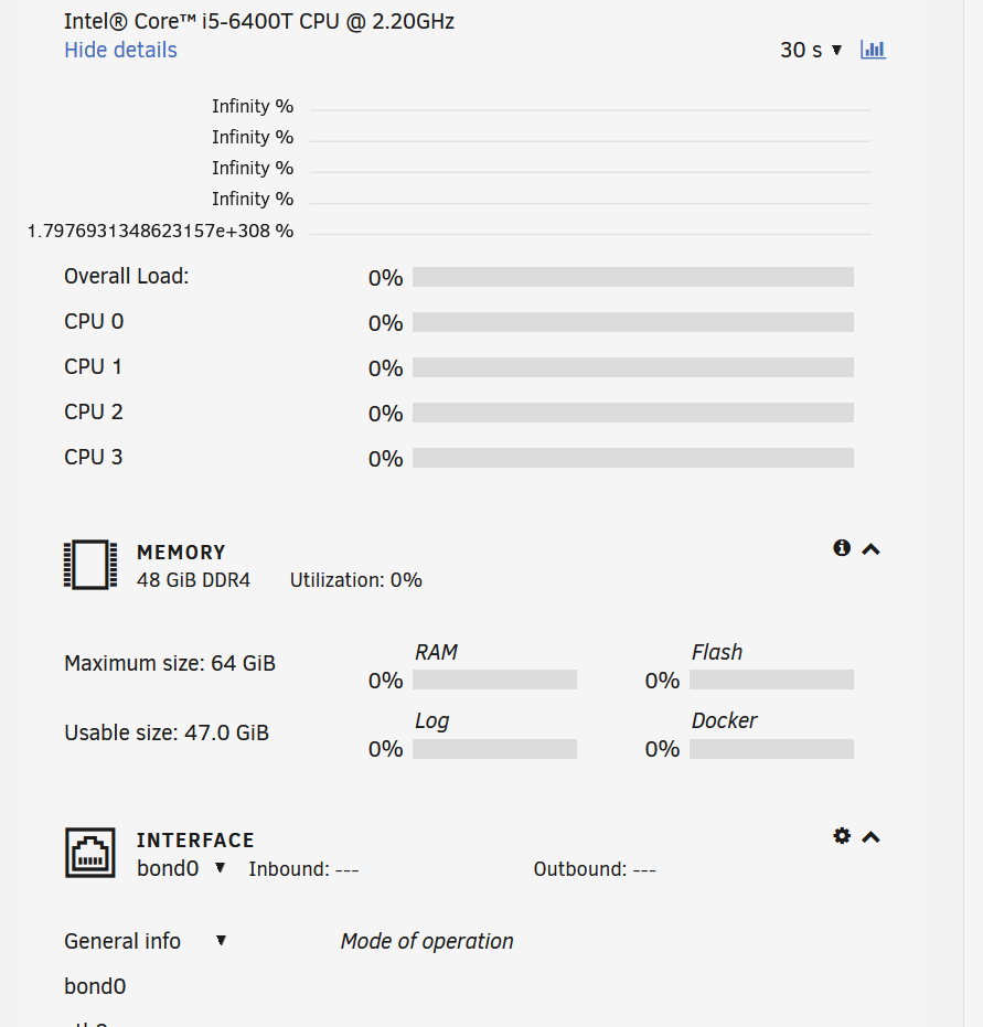

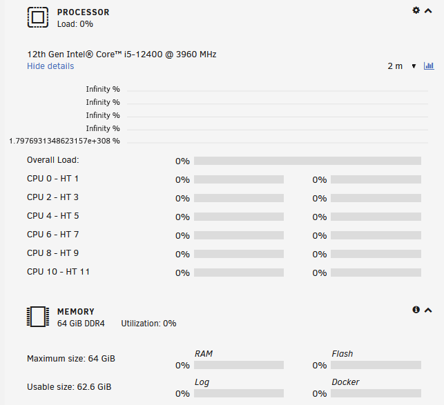

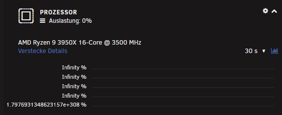

November 8, 20224 yr Hi all, when opening the Dashboard-Tab, I can't click on any button and the CPU shows "Infinity %" for between 10 to 60 seconds. I attached a screenshot. A similar behaviour is happening in the Start-Tab. For about 10 to 60 seconds the tab ist completely unresponsive and I can't see my array or cache-pool. The page is just empty. After given time everything appears and is usable. This does not happen when I login remote via Wireguard-VPN. This way everything loads instantly. What could be the problem here? I also attached the syslog file and the server diagnostics. I really can't find the root of it. I have another unraid server in the same network with no issues... I searched the forum and web but didn't find a similar problem. Help is very much apprechiated! server-syslog-20221108-1024.zip server-diagnostics-20221108-1127.zip

November 8, 20224 yr Author So I changed the browser: My main browser is firefox but if I open the WebUI in edge, everything works as expected - at first. Then the same thing happens. Where could this come from? If I open the WebUI from my second unraid server in firefox -WITHOUT- Wireguard and exactly the same browser-settings, everything works. So it can't be an ad-blocker or a firewall blocking something, right? I just use ABP and its disabled for the server. Same network - same PC and browser - two unraid servers - one works and the other with odd behaviour. 🤷♂️ Is there a log-file that could help me troubleshoot? Edited November 8, 20224 yr by Monokultur-Studio
November 8, 20224 yr 2 hours ago, Monokultur-Studio said: So I changed the browser: My main browser is firefox but if I open the WebUI in edge, everything works as expected - at first. Then the same thing happens. Where could this come from? If I open the WebUI from my second unraid server in firefox -WITHOUT- Wireguard and exactly the same browser-settings, everything works. So it can't be an ad-blocker or a firewall blocking something, right? I just use ABP and its disabled for the server. Same network - same PC and browser - two unraid servers - one works and the other with odd behaviour. 🤷♂️ Is there a log-file that could help me troubleshoot? Do you get the same results using incognito mode?
November 9, 20224 yr Author Solution I can't test that anymore, because I disabled "Use SSL/TSL" in the settings and now it works. Very strange... 🤔

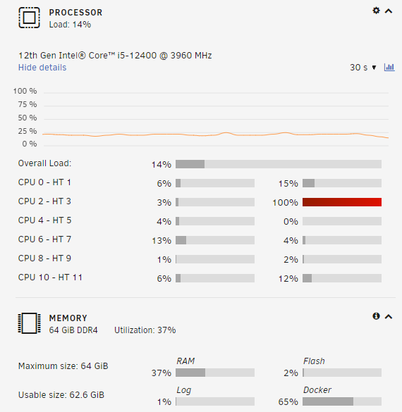

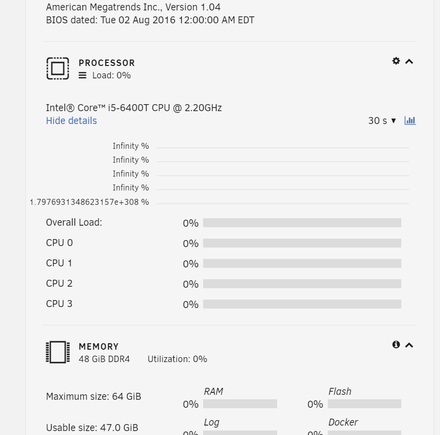

November 15, 20223 yr I also have the same problem. It just happened. I've been using Firefox with this server for a few months and everything's been ok until now. The following screenshots show the same server dashboard but with different browsers. The top is Firefox and the bottom is Edge. Both connections are https. The only thing that is different this time is that I'm running a comparison with dupeGuru which seems to be very intensive (and now seems to be frozen). Currently running unRAID 6.10.3. Plan is to upgrade to the latest this weekend. I guess we'll see what happens over the next few days. Edited November 15, 20223 yr by TimTheSettler

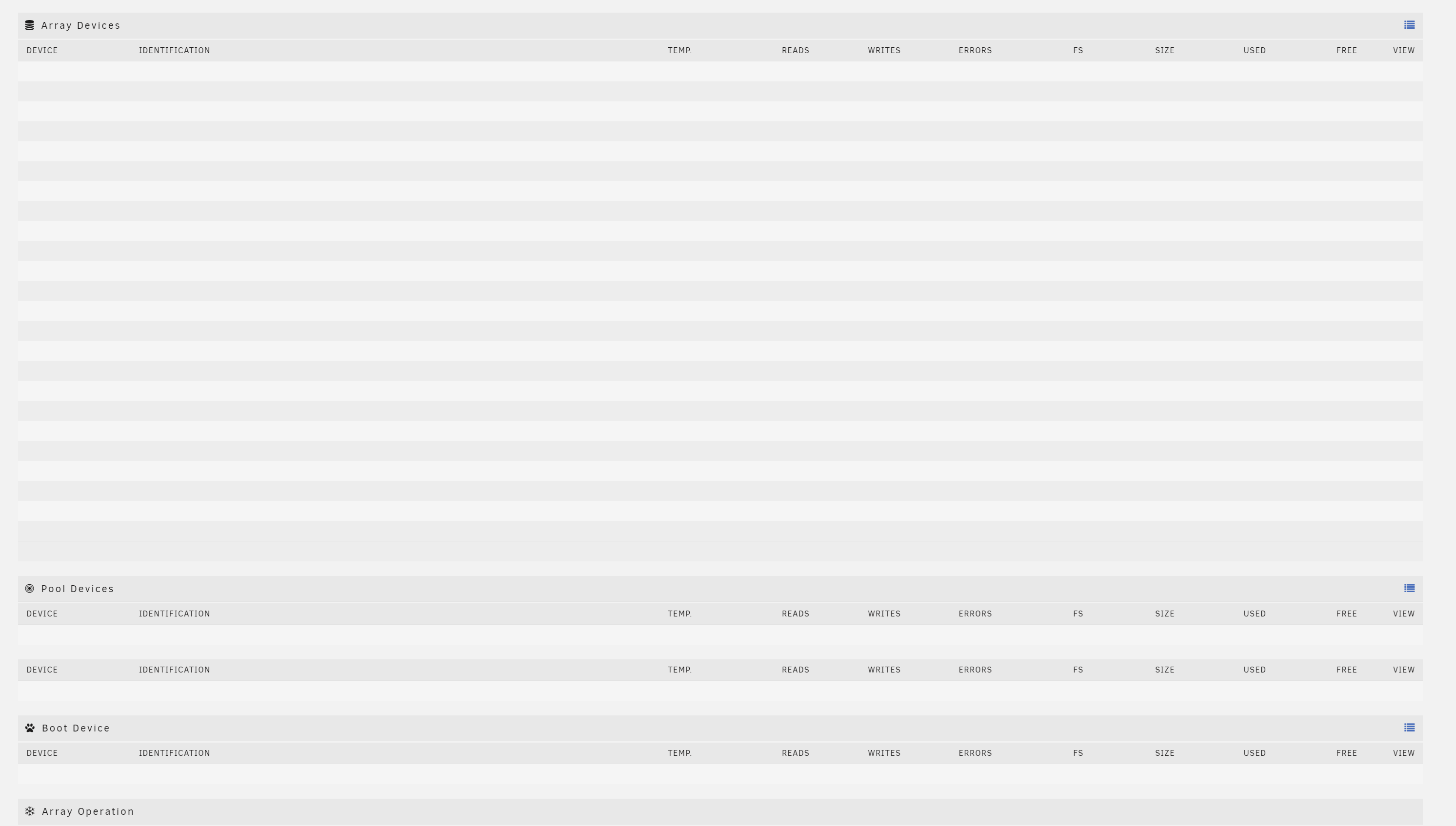

March 7, 20233 yr I'm having endless problems as well with GUI things not showing. New user/new installation here. I was tinkering last night and everything was working perfectly. I went back in today and all the GUI elements were not formatting correctly, or unresponsive. I learned that clearing firefox cache fixed it. I'll report back if/when it happens again.

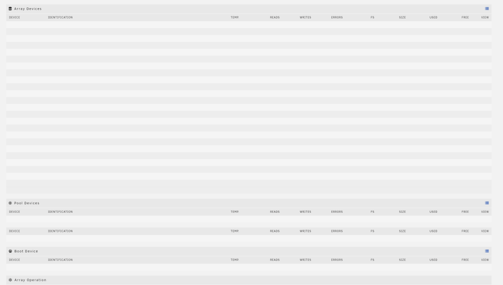

March 7, 20233 yr I'm having the same issue which also just started. I've tried it in Firefox, Edge and Chrome and they all have similar behaviors. I can't see anything in the "Main" tab, Dashboard shows incomplete information and plugin's and docker never load. EDIT: Using 6.11.5 Unraid Edited March 7, 20233 yr by severanced

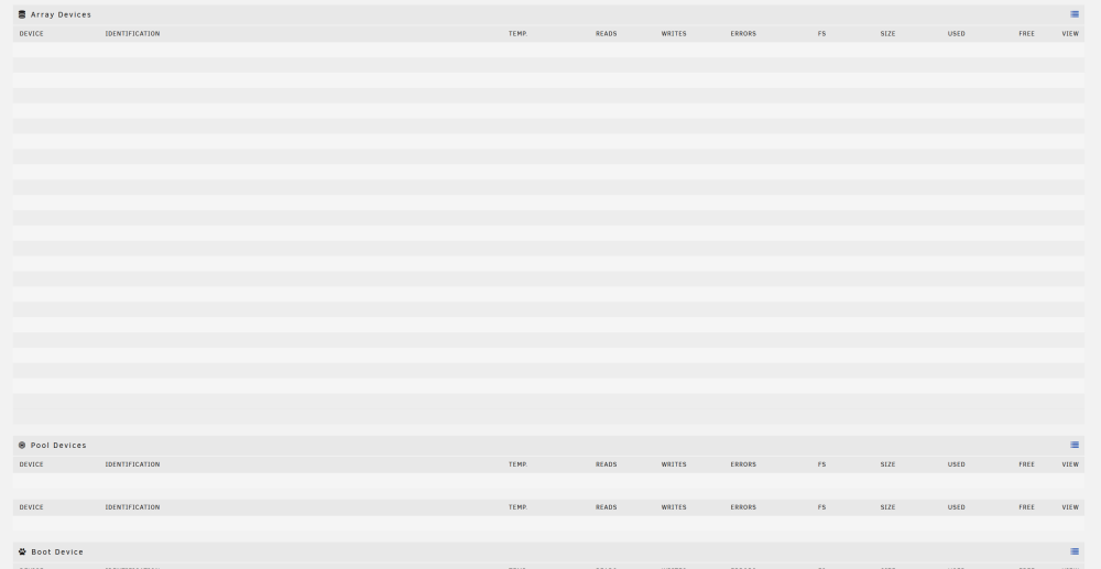

March 8, 20233 yr So I found a laptop that has not had their browsers updated and I was able to uninstall the My Server's app, this has fixed a few problems, the Docker and Plugins tab now appear to populate, but the Main tab is not populating at all still and the Dashboard is also not populating. This is total speculation on my part but maybe some update to Chronimum broke some of the elements of the GUI?
March 8, 20233 yr 1 hour ago, severanced said: This is total speculation on my part but maybe some update to Chronimum broke some of the elements of the GUI? No, I'm using firefox and it happens here too. Try clearing the browser cache. I noticed that I had over 1GB of cached elements last time this happened, and after clearing, the problem immediately cleared up. I'm still waiting to see if it happens again.
March 8, 20233 yr 1 hour ago, House Of Cards said: No, I'm using firefox and it happens here too. Try clearing the browser cache. I noticed that I had over 1GB of cached elements last time this happened, and after clearing, the problem immediately cleared up. I'm still waiting to see if it happens again. I just tried that and unfortunately that didn't work, those pages are still blank. I tried it in an incognito window too to see if it was a plugin and also didn't work. This seems to be a bigger problem.

March 11, 20233 yr Has anyone found anything more about this? My dashboard and Main page are still non-functional.
March 11, 20233 yr 14 minutes ago, severanced said: Has anyone found anything more about this? My dashboard and Main page are still non-functional. Is this with MyServers installed? What browser? Is it up to date? Do things work if addons / extensions are disabled? Are you trying to use a VPN to your server?

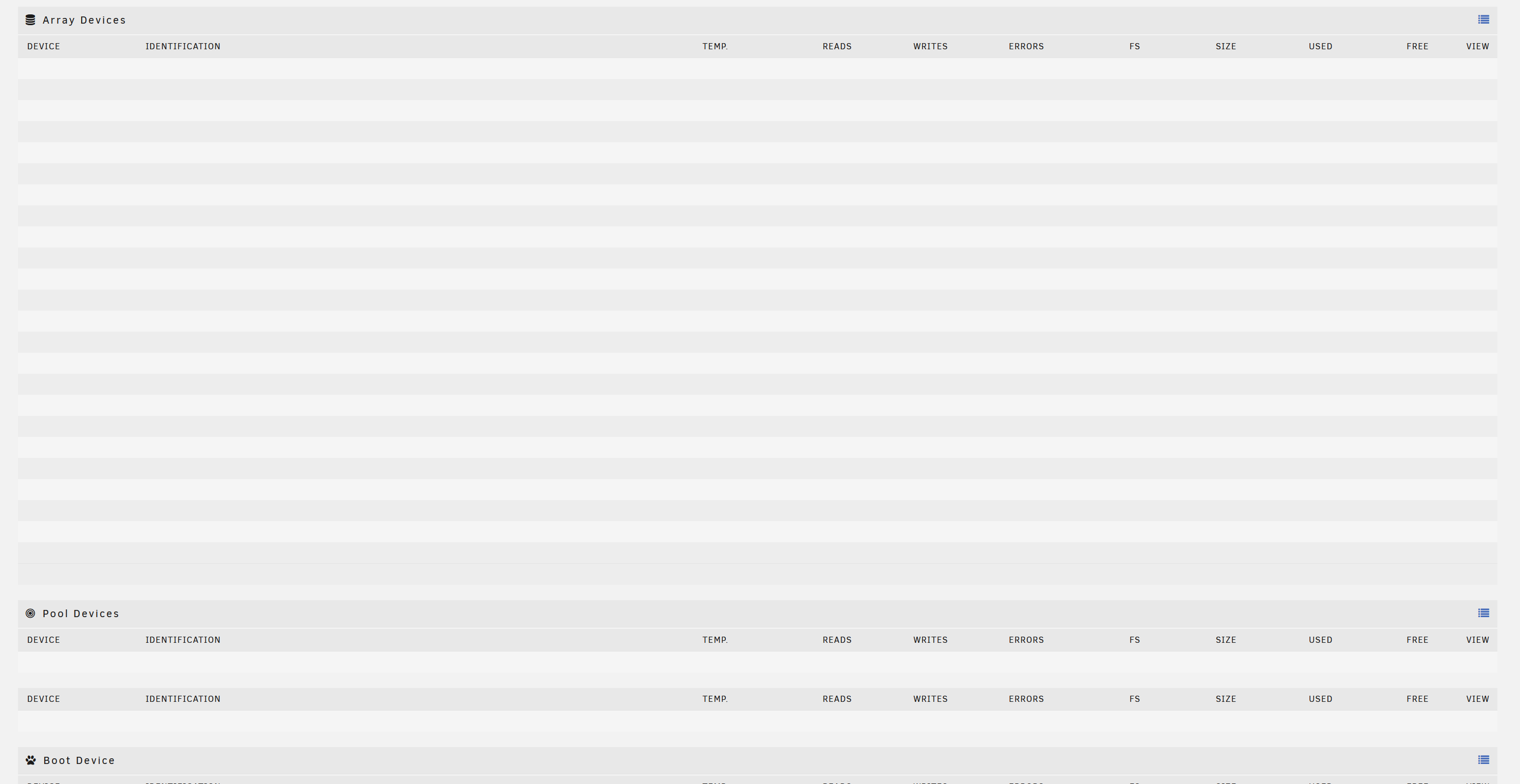

March 11, 20233 yr 5 minutes ago, Squid said: Is this with MyServers installed? What browser? Is it up to date? Do things work if addons / extensions are disabled? Are you trying to use a VPN to your server? This is with MyServers uninstalled. Browser is Firefox latest version. This happens in both regular firefox and in incognito window with nothing enabled also Chrome and Edge which I have no addons/extensions installed I get the same results. Main is just a bunch of blank lines and Dashboard does not fully populate.
March 14, 20233 yr On 3/11/2023 at 4:07 PM, severanced said: This is with MyServers uninstalled. Browser is Firefox latest version. This happens in both regular firefox and in incognito window with nothing enabled also Chrome and Edge which I have no addons/extensions installed I get the same results. Main is just a bunch of blank lines and Dashboard does not fully populate. So I shut down my system, took out my drive, ran a scandisk on it and restarted my server and it looks like my GUI is back to normal. It looks like it my have needed a reboot of some sort.
