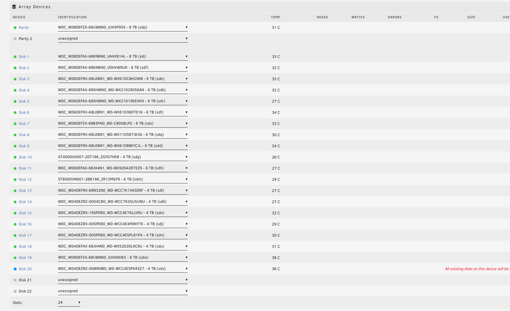

I just realized that the disks are all mixed up... Originally disk12 was WCC4E5PX4XZ7 (with 3.79TB used and 211GB free) - 4TB, then ZR12MGFR - 6 TB (3.88 TB with 2.12 TB free) and now ZR12MGFR is still in the same position but appears it has 5.94 TB of free space...
I am afraid I messed up with the array and I cannot sort out things now!!!
If I try to mount WCC4E5PX4XZ7 now says that is a NEW DEVICE and if I start the array all the data will be overritten....
Already lost 6TB of data apparently (I do not know how I manage to format a full disk...) would like to avoid to loose also other 4TB...
Any suggestion (a part DO NOT FORMAT FULL DISKS)?
736709158_ScreenShot2022-12-10at14_41_05.thumb.png.fe982626e20bd28ab1dc995311b1f6dd.png
If you add a new disk to a parity protected array it will be cleared (wiped) first, you can mount the disk with UD first to see if there's any data there.
I tried to mount with UD but the mountpb is grayed and does not let me do it....
