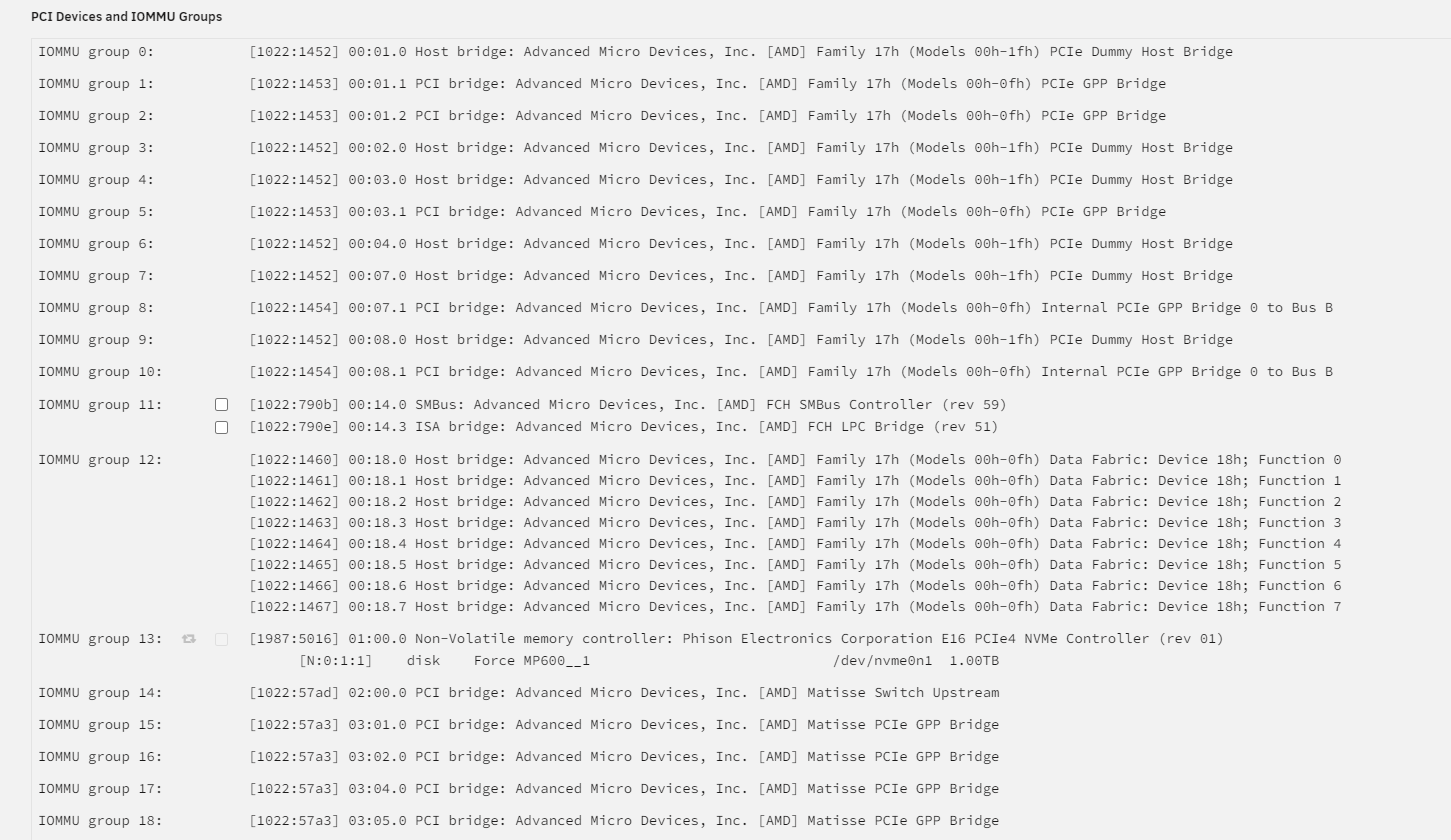

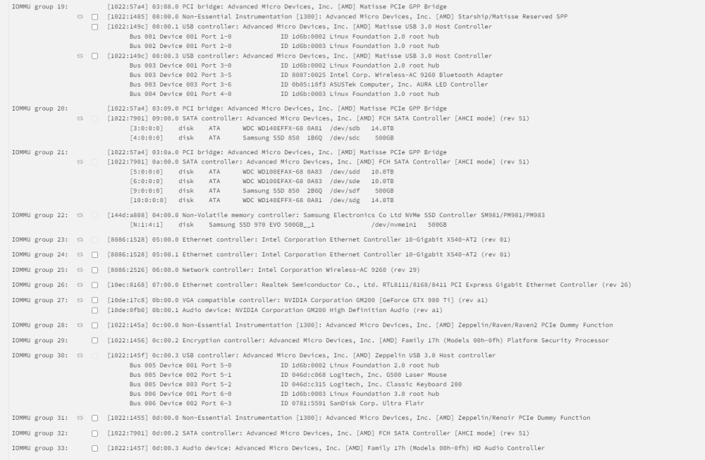

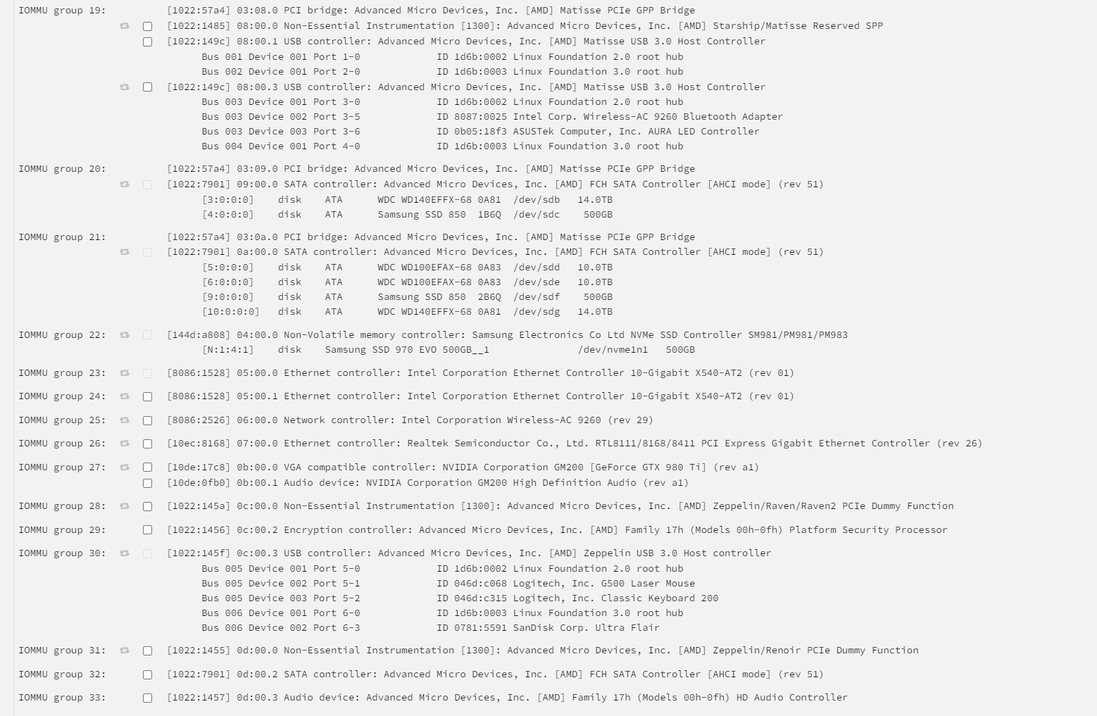

Tools - System Devices
Post screenshot
I am currently in maintenance mode, rebuilding a drive, and I have disabled the AMD-V flag. Should I reenable it before I post the screenshot of System Devices or is it OK to post it now with the flag disabled?
In case it does not matter, here is the current list:
image.thumb.png.01cae99ed9955224a5ddf654cbae1e65.pngimage.thumb.png.97720b34aae574b91ac7e80563a64a36.png
