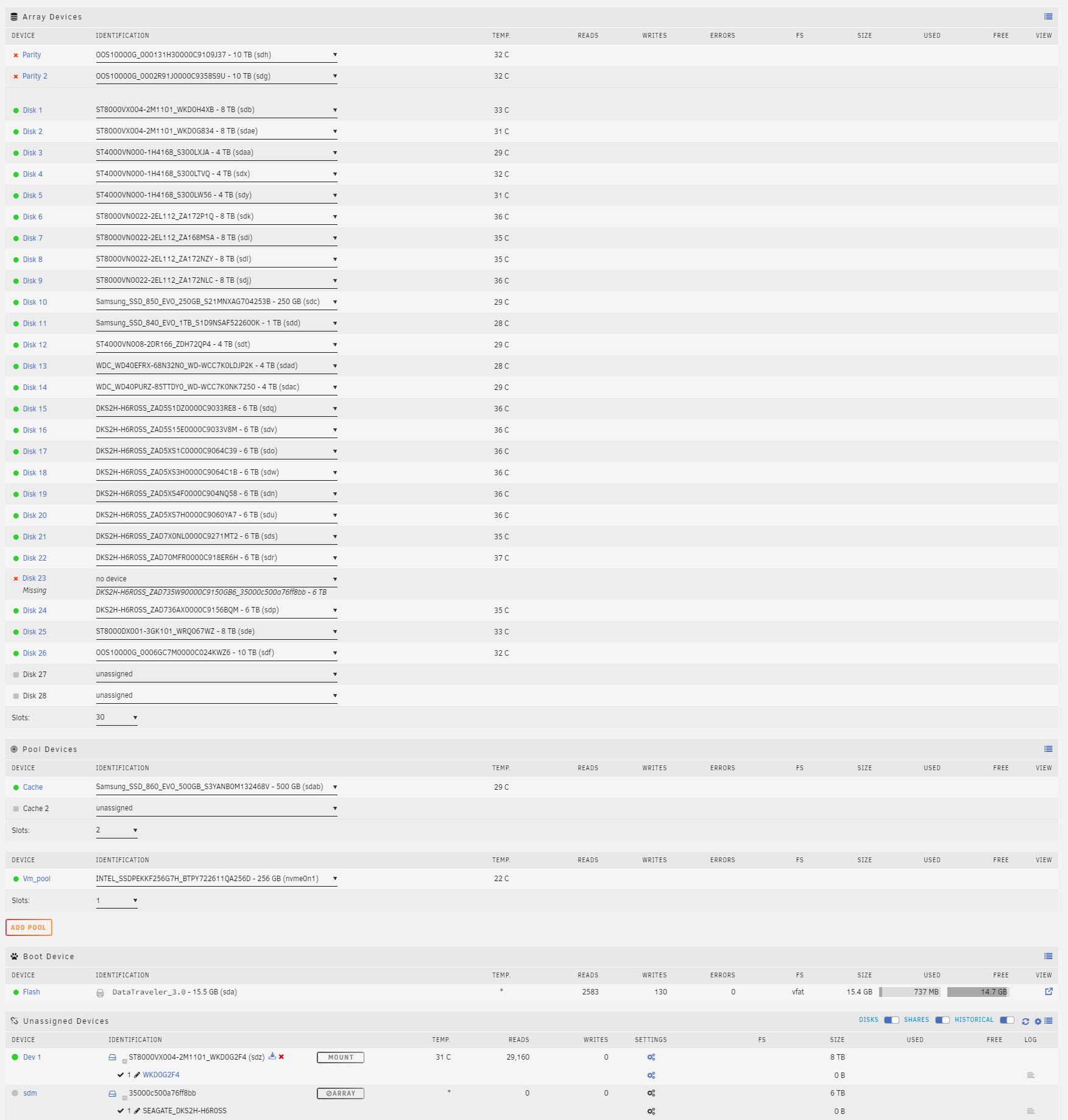

TheIronAngel Posted December 27, 2022 Share Posted December 27, 2022 (edited) Hi Guys, as in the title, this is my first multi-drive failure with UNRAID. Contrary to what I would have expected from waking up to multiple dead drives I'm actually somewhat excited to learn the process of recovering from a situation like this. I have an array of 26+2 and 3 drives have spat the dummy - one of the main reasons I picked UNRAID was for this exact situation, if more drives than parity can restore detonate then you only lose the data on the drives that turned themselves into paper weights. At this point in time I have 2 failed Parity disks and 1 data disk that decided to grenade itself after parity went bye-bye. Timeline: Midnight - Routine Parity check starts ~2am - Parity disk 1 starts throwing errors and gets marked bad ~3am - Parity disk 2 starts throwing errors and gets marked bad ~3:30am - Disk 23 starts throwing 'Sector 1 unreadable' ~3:50am - I notice issues with server and start troubleshooting ~4am Drive goes from 'Unmountable' to 'Missing' after restarting server 4:30 - Here we are at time of writing Troubleshooting: So, for troubleshooting of all disks I've done the basics: Restart the server Power Cycle the disk shelf For Parity 1 and 2 - Both are SAS (PD1 and PD2) SMART DST - Pass - I suspect they are still functional and contain valid parity data as everything that gets written to the array gets written to Cache first and transferred to disk at 6am logs show IO errors on at least PD1, I'm revising my opinion here, both have probably taken an arrow to the knee. For Disk 23 - SAS (D23) Reconnect the drive in the same bay slot - Still not detected Swap the drive to another bay in the chassis (on a different backplane) - No detect Conclusion: Here is my conclusion, Please do tell me if you think there is something else I can/should do before moving on: D23 going Dodo would have been recoverable in addition to PD1 so long as PD2 hadn't also decided to fall flat on its face. Unfortunately with all 3 drives marked bad by UNRAID this means that the array is 'unrecoverable' in a traditional sense. I have a hot spare disk that I could use to replace D23 literally installed and waiting, and can get a couple of disks for the Parity drives later today to build a new array but I want to keep the data on all other disks. Boiled down, I have to replace the failed drives and create a new array config with new drives maintaining disk order to keep data on the drives that aren't dead but... Questions: 1: I have 23 other disks from this array all with information on them and I would like to keep the information on these disks - I understand that this should be possible when creating a new config with the drives but I would like someone with experience to point me to the right resource or 'hold my hand' while doing this for the first time to make sure I don't do something dumb. Things like letting me know of any risks/things to be aware of when doing this would also be very much appreciated! 2: Why did I say 23 and not 25 'other disks'? I added 2 disks within the last 30 days and, as of ~6 hours prior to the failure, neither of them had anything stored on them yet. My question is: One of these drives happens to be the right size to become a parity disk, would it be possible to remove this disk and assign it as parity instead of buying a replacement or would doing this be a case of 'don't know what could happen, just be safe and don't do it' recommendation? 3: Is it possible that the 2 Parity drives are A-OK (they pass SMART etc.) and could be forced to resume opteration in an attempt to restore the data on failed D23 to the hot spare before getting the parity drives replaced just in case? 4: If option 3 were tried what possible issues could occur if the parity drives aren't 'dead' but just not reading correctly? Would D23's content be mangled and unusable or worse - like, rest of the array data takes a grenade? - AKA, is this something reasonably low risk and worth trying or something high risk and I should just write off D23 and count my blessings that the other disks aren't FUBAR too? Things to note: Not all data on this array is backed up but all critical files are - any data stored on this array that isn't backed up, primarily - lets say for argument sake - ISOs, is replaceable and only classed as 'nice to have.' If push comes to shove I'm more than capable of manually verifying what ones are missing and re-acquiring anything lost. I'm not in a huge rush to fix this problem so if there are options that take time to try thats fine. Its now 5:55am and I'm going back to bed and will check back in a little while, I can post any information that you would like when I get back up in a couple of hours Earlier in the day I had updated UNRAID 6.11.0 --> 6.11.5 and the unit was awaiting a restart which I was planning on doing after parity check had completed today but had to restart the server during troubleshooting which completed the update - not sure if this is an issue for logs or something. Edited December 28, 2022 by TheIronAngel Quote Link to comment

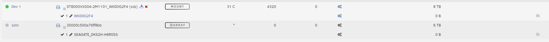

trurl Posted December 28, 2022 Share Posted December 28, 2022 Both parity disabled, not clear there is anything wrong with either. Disk23 isn't disabled since you already have 2 disabled disks, but Unraid thinks it is missing. However, there is an Unassigned Device sdm in the SMART reports that seems like it might be the missing disk23. Unfortunately, sdm is showing critical medium errors in syslog. Can you see that disk in Unassigned Devices? Is that disk23? Quote Link to comment

TheIronAngel Posted December 28, 2022 Author Share Posted December 28, 2022 SDM is in UD section however it looks like it's spun down and can't be spun up: Also when investigating the disk by clicking on sdm none of the typical data is shown. It's also not able to be added to the D23 slot in the array. Seems like the disk is badly in-op Quote Link to comment

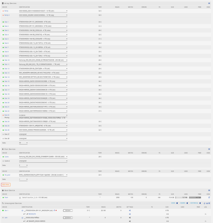

TheIronAngel Posted December 29, 2022 Author Share Posted December 29, 2022 15 hours ago, JorgeB said: If parity is not 100% in sync only the bad part on the rebuilt disk would also be bad. Yes, it might be better to re-enable only parity2, since if both are re-enabled only parity1 will be used to emulated the missing disk, assuming no read errors on a different disk. The procedure would be the following (you need a new disk to replace disk23): -Tools -> New Config -> Retain current configuration: All -> Apply -Unassign parity1 and then check all assignments, parity2 must remain assigned as parity2, they are not interchangeable, assign any missing disk(s) if needed, including the new disk23, replacement disk should be same size or larger than the old one -IMPORTANT - Check both "parity is already valid" and "maintenance mode" and start the array (note that the GUI will still show that data on parity disk(s) will be overwritten, this is normal as it doesn't account for the checkbox, but it won't be as long as it's checked) -Stop array -Unassign disk23 -Start array (in normal mode now), ideally the emulated disk will now mount and contents look correct, if it doesn't post new diags Both Parity disks completed the extended SMART test and I've followed your instructions, unfortunately disk23 does not emulate and just comes up as 'Unmountable: Wrong or no filesystem' I also had a swathe of UDMA CRC errors on restarting the array however its not confined to one backplane or expander as only some disks on Row 2, 3 and 5 in the diskshelf got them as well as a couple of disks in that were on internal headers on the master controller (not in the disk shelf at all) - I'm not really sure what to make of that other than 'meh, UDMA CRC error, not a major issue' Diags attached for checking and I've stopped the array diskstation2-diagnostics-20221229-1558.zip Quote Link to comment
trurl Posted December 29, 2022 Share Posted December 29, 2022 29 minutes ago, TheIronAngel said: unfortunately disk23 does not emulate and just comes up as 'Unmountable: Wrong or no filesystem' It is emulated, but unmountable. Check filesystem on emulated disk23 Quote Link to comment
