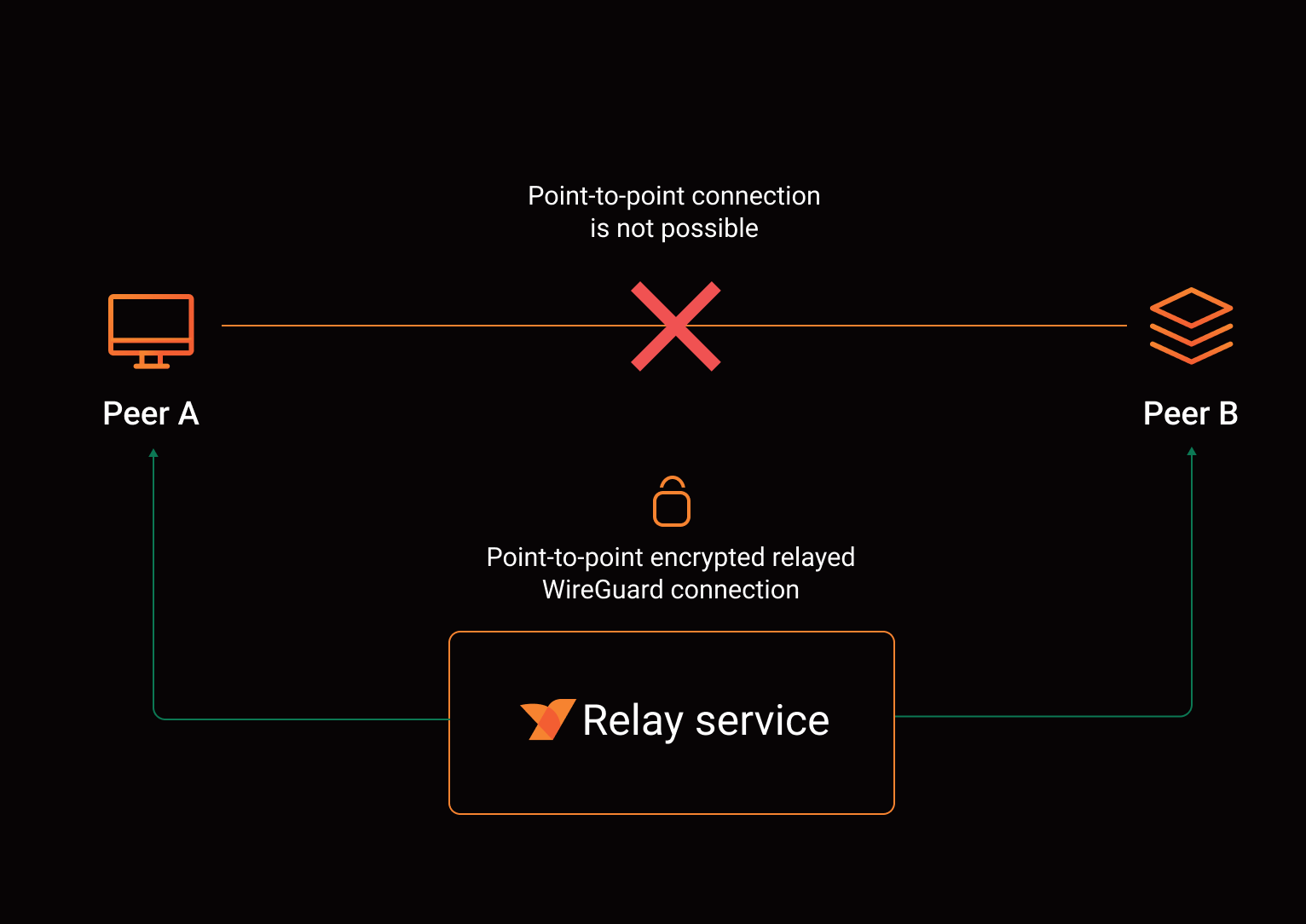

Netbird have explanations in their docs. Check out the "How Netbird Works" page, specifically the "Relay Service" section. To quote:
"The Relay service is a TURN server in WebRTC terminology. In fact, we use an open-source implementation called Coturn. The purpose of this service is to be a "plan B" and relay traffic between peers in case a point-to-point connection isn't possible."
I personally self-host Coturn. I originally set it up for "Matrix Synapse" and repurposed it for Netbird. I basically did the bare minimum configuration from stock in the config. The config is one of those 500 line variable things that your eyes glaze over looking at. I'll take a look around and see what I can find in terms of security practices.

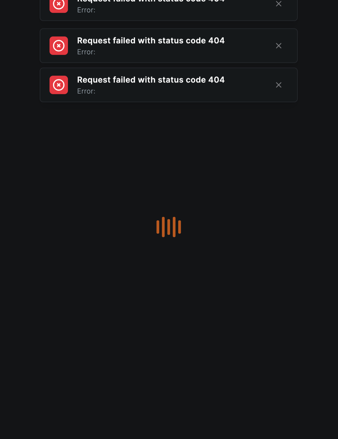

Hi @jimrummy101
Thank you for the guide.
I have everything working but when I access Netbird, after redirecting Keycloack, it accesses https//netbird.mydomain.com/peers and shows this error.
In my case I use Nginx Proxy Manager, I don't know if I have to add something.

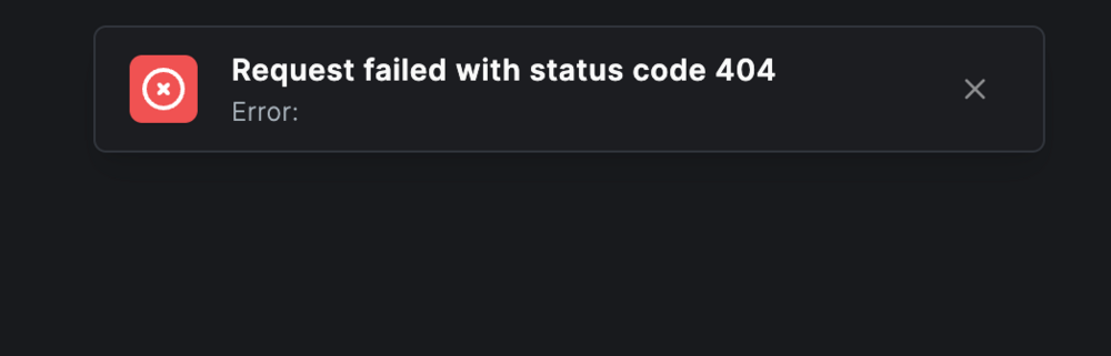

2 hours ago, Juani said:
Hi @jimrummy101
I have not run this , it does not recognize the command inside the Netbird Dashboard Terminal.
netbird up --managementurl https: netbird.mydomain.net:443 --admin-url ""
So my understanding is that you're unable to access your dashboard. From the picture it seems you can physically access it but there's possibly a configuration issue due to receiving those 404 errors.
I would double check you've set all the URLs correctly. I would also check the logs for each of the parts of Netbird and see if there's any obvious errors. If Keycloak is redirecting alright then that's probably not the issue. I would check your proxy config as well as just double checking any configured variables and domains for spelling mistakes etc.
Post the logs in here (you can censor any urls) if you need more help.
That last command should use "--management-url" not "--managementurl". The domain is also missing the "//" after the "https:". The domain you use as an example uses ".net" instead of ".com" as was mentioned in the previous url you gave. If you don't want to have an --admin-url you can just omit that part of the command.. The command is also only for netbird clients whether that's the container or PC client etc.
netbird up --management-url https://netbird.mydomain.net:443
Should work.
Should work.

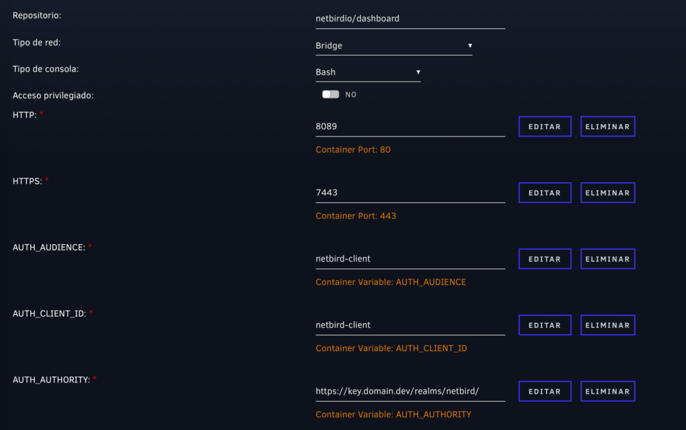

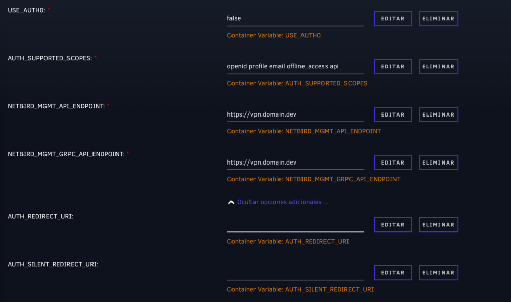

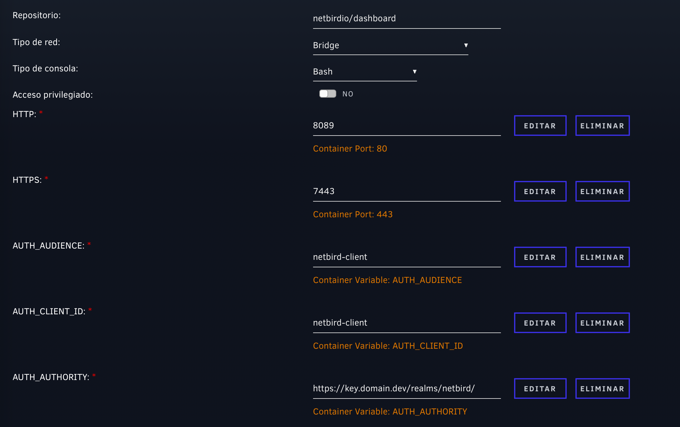

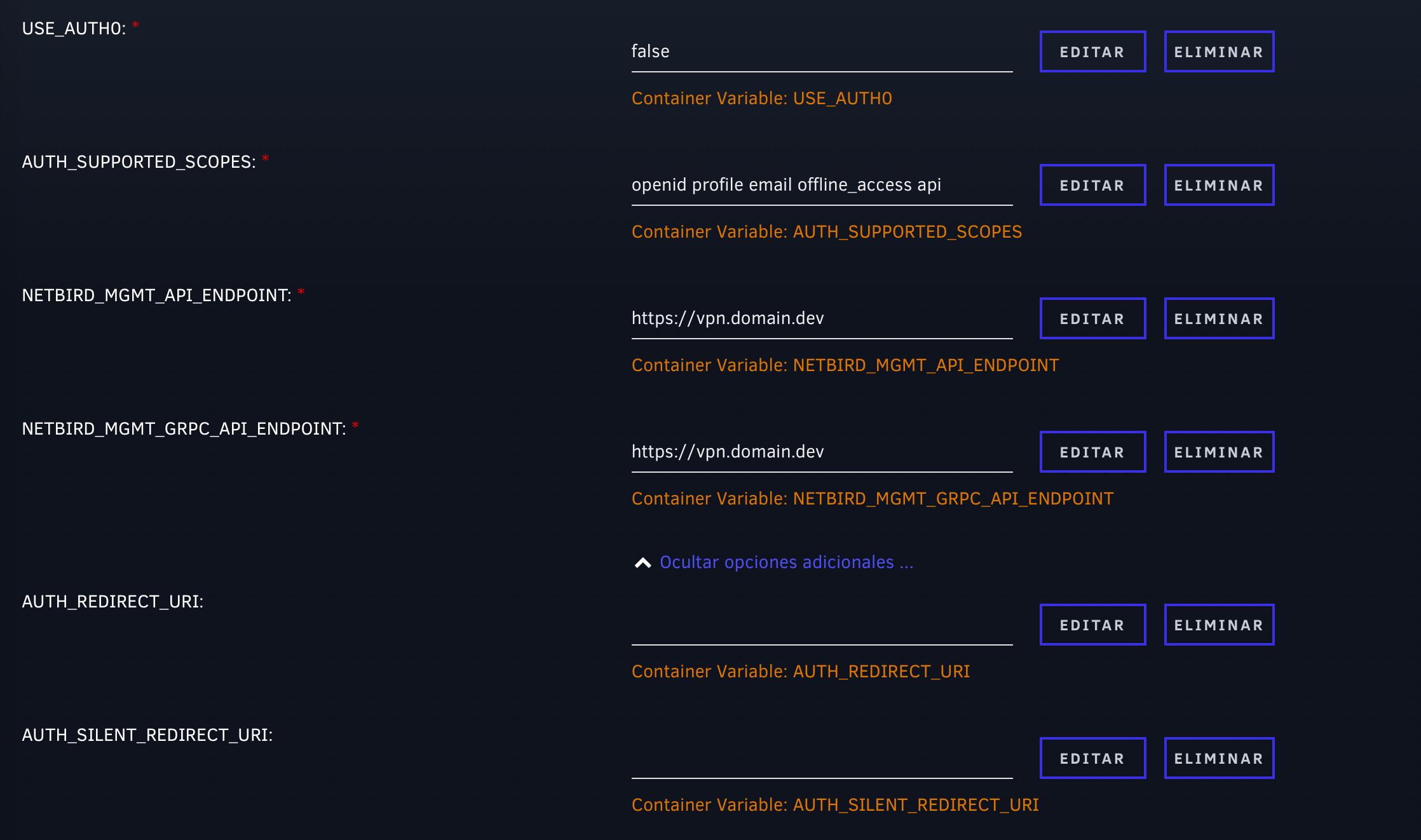

Hi!
I continue with the 404 error problem when accessing the Dashboard.
I attach my "management.json" and screenshots of the templates. management.json
https://vpn.domain.dev refers to my NetBird instance.
https://key.domain.dev refers to my KeyCloack instance.
Keycloack must be all right, since it redirects me correctly to the NetBird Dashboard.
NETBIRD MANAGEMENT TEMPLATE
Aditionals arguments:
--port 443 --log-file console --disable-anonymous-metrics=false --single-account-mode-domain=vpn.domain.dev --dns-domain=netbird.selfhosted
NETBIRD DASHBOARD TEMPLATE
Capturadepantalla2024-05-14alas12_24_15.thumb.png.6fed65578e961c177a0095b5ab73d961.pngCapturadepantalla2024-05-14alas12_24_31.thumb.png.fe1937877526054f84c73ba99a57cfcf.png

4 hours ago, Juani said:
Hi!
Your templates look fine to me. My management.json was configured before some of the options in the example provided by netbird were available.
I have attached my management.jsonwith domains and secrets stripped. Your config will look slightly different to mine but it should be useful as a known working example. As a note any "" values are actually empty strings. Anything with a value that I censored has been replaced with a different string.
The management.json file is one of my blindspots in terms of knowledge as it was mostly generated for me following steps 1, 2 & 5 from the Advanced Guide page, with some modifications.
Let me know if you get it working or if you need anything. I may need to change the management.json I provided in my github repo if it's ended up out of date.
Now yes! NGINX PROXY MANAGER is the problem. "custom locations" must be configured. Thanks!

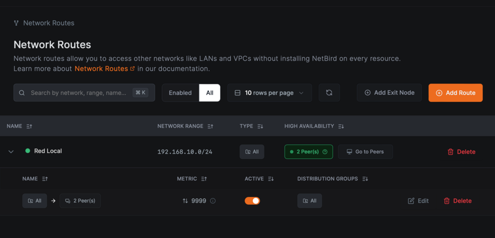

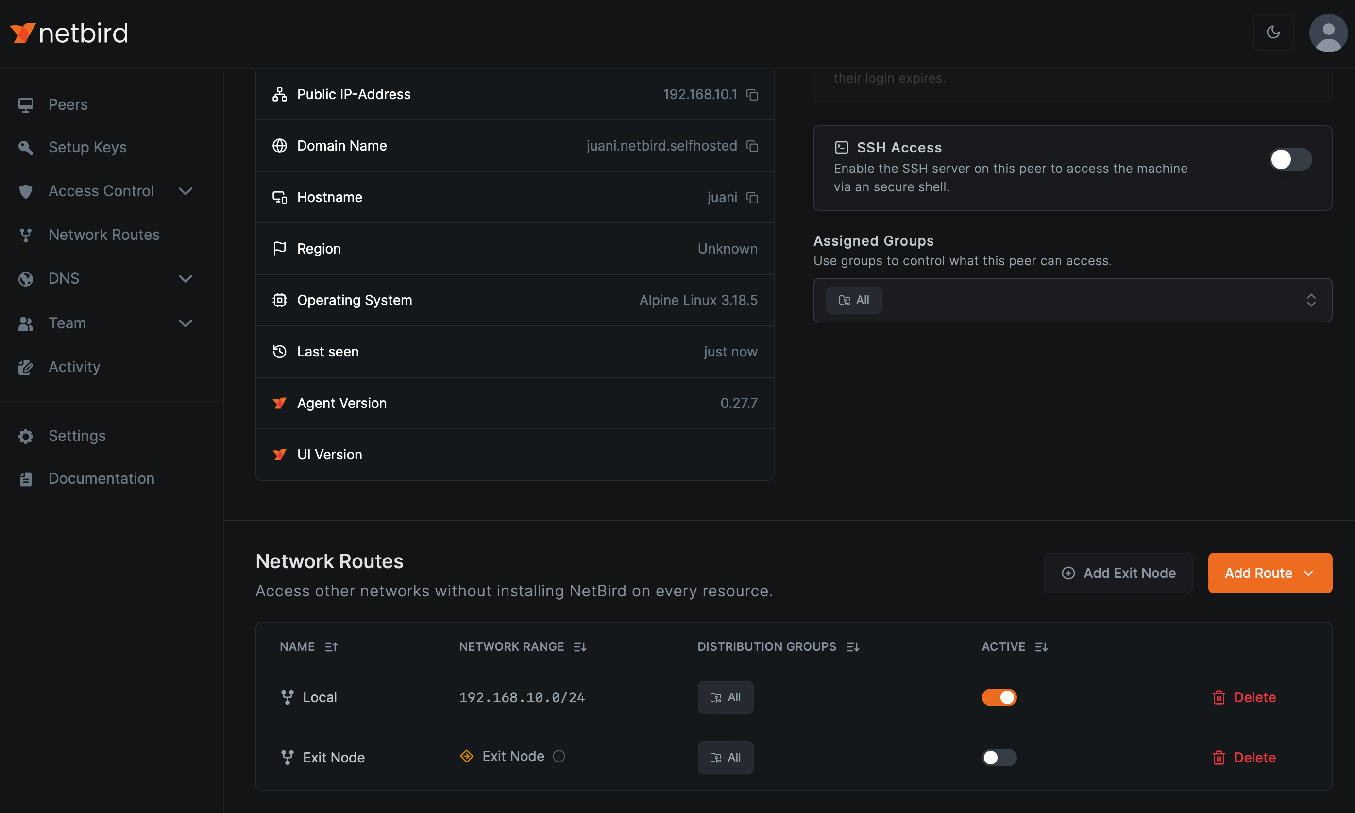

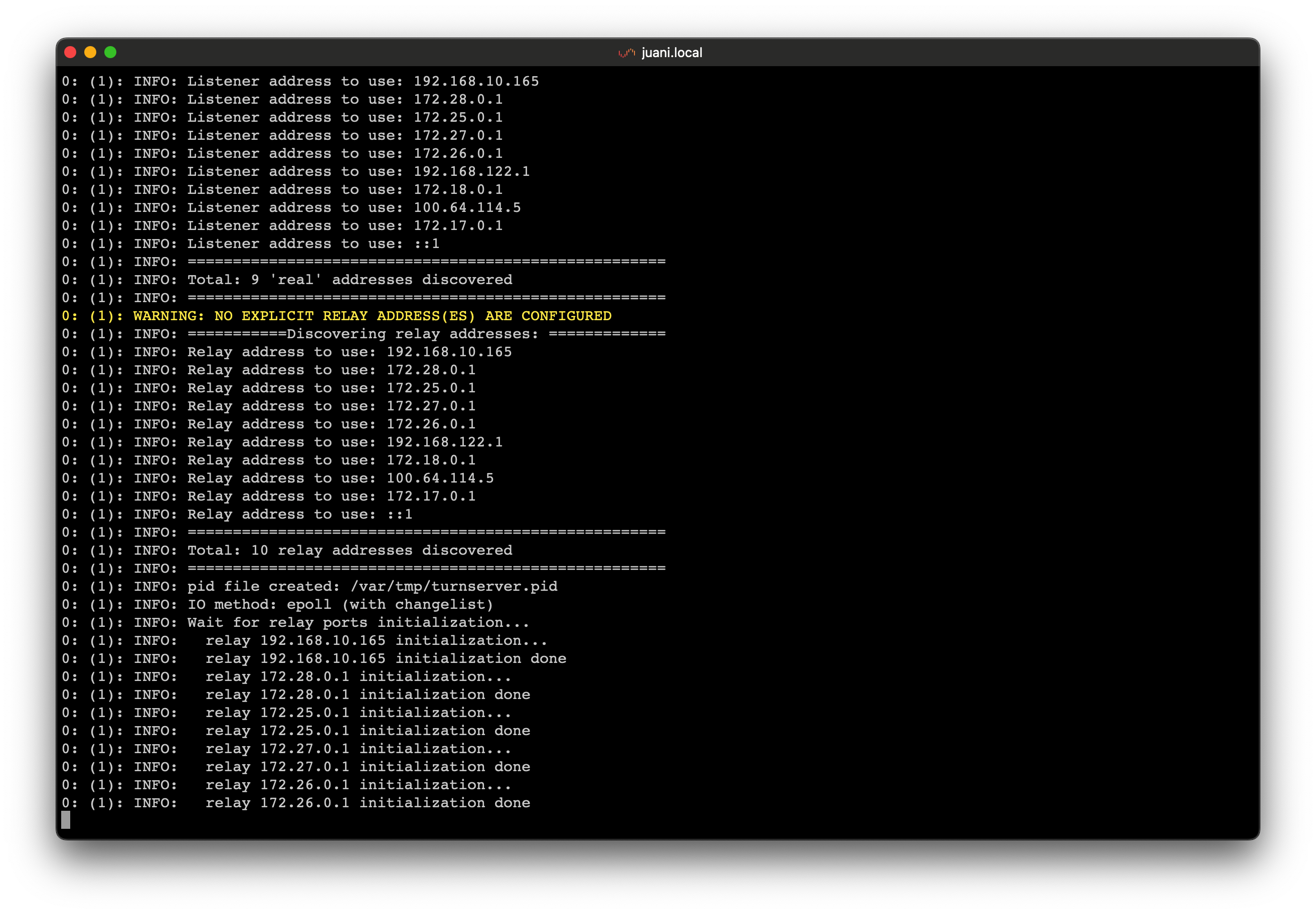

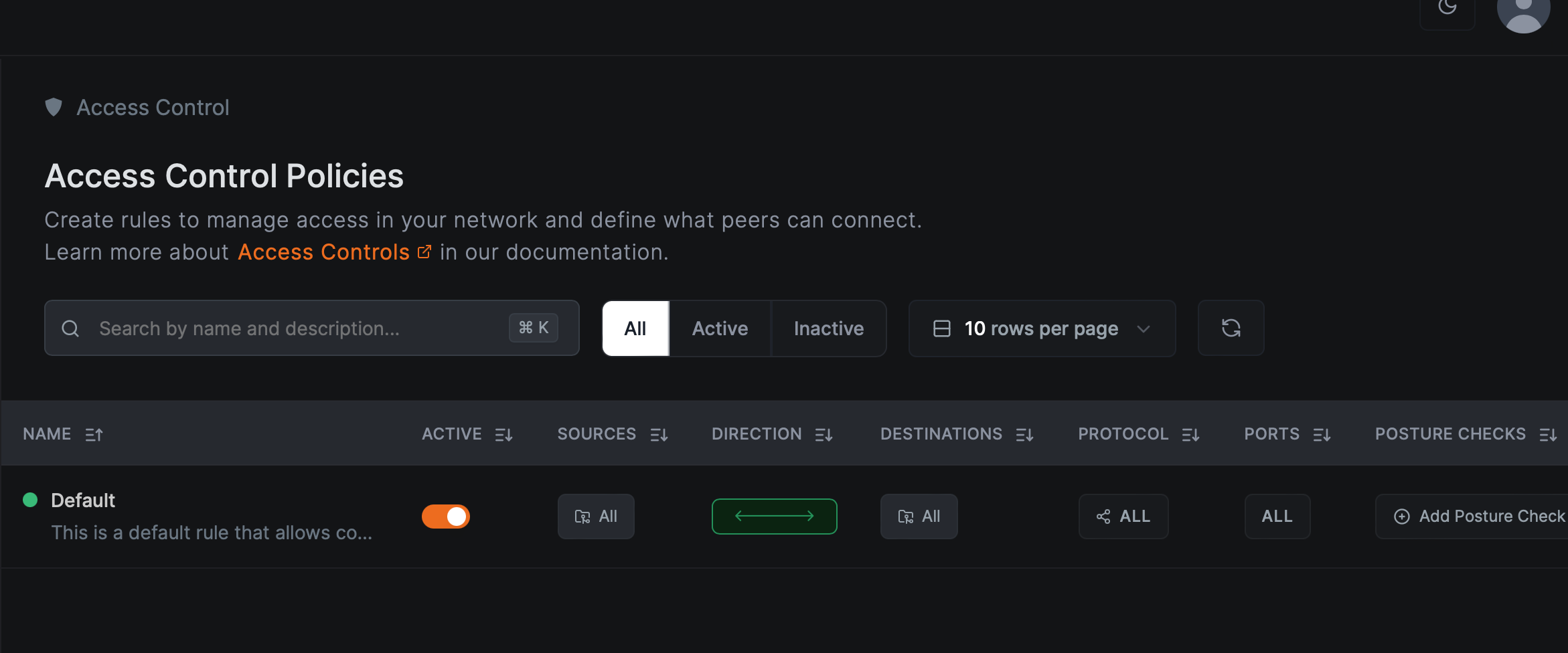

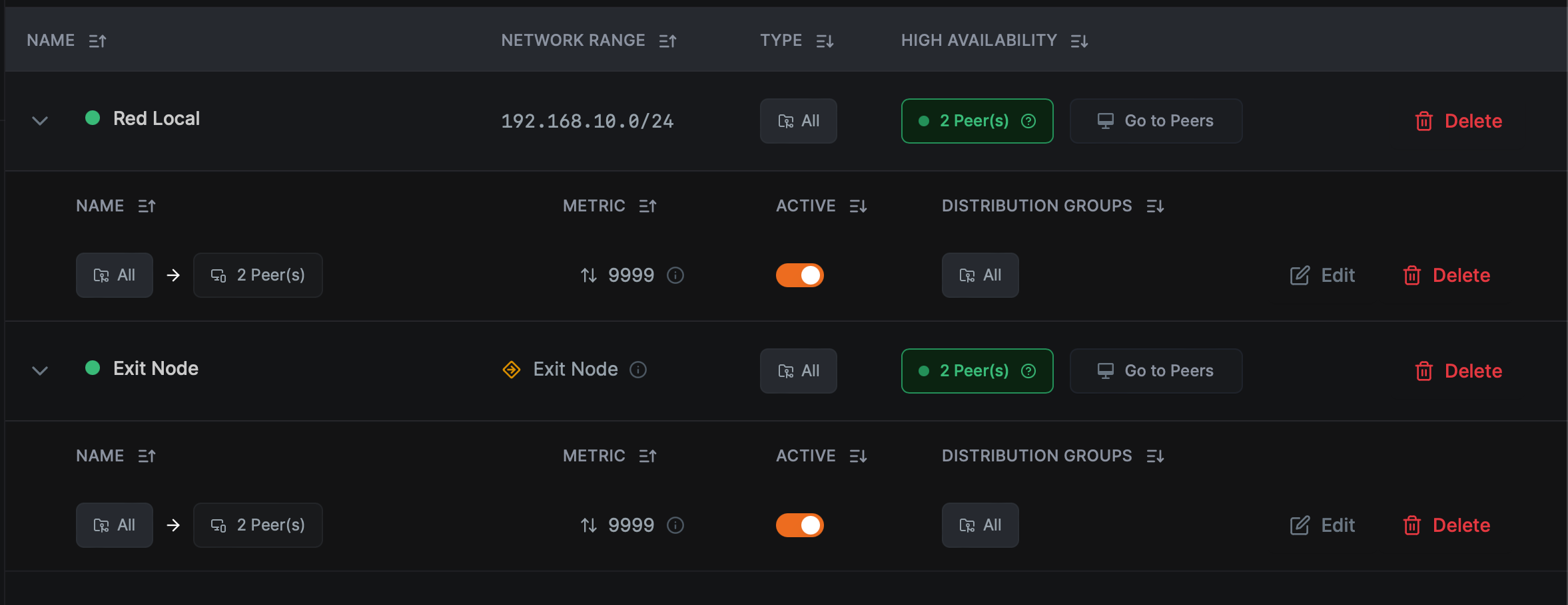

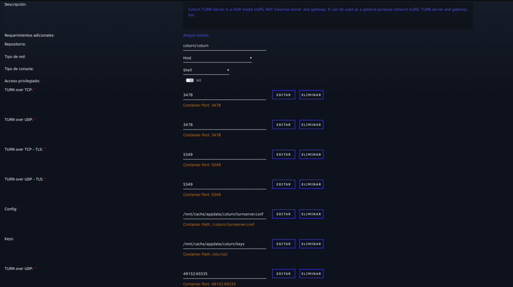

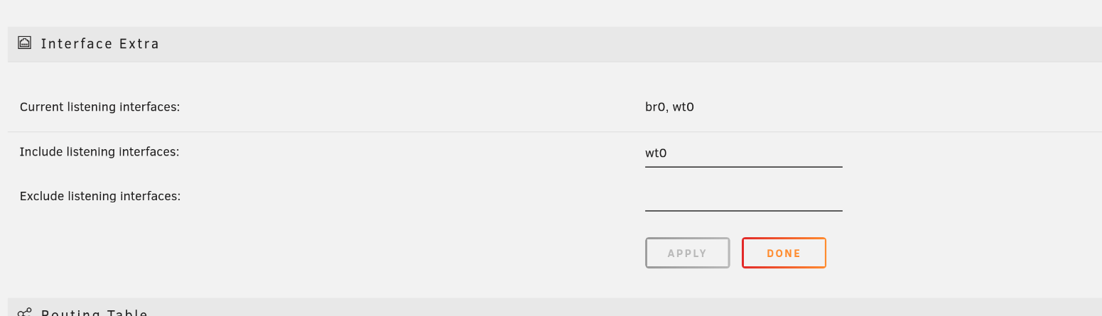

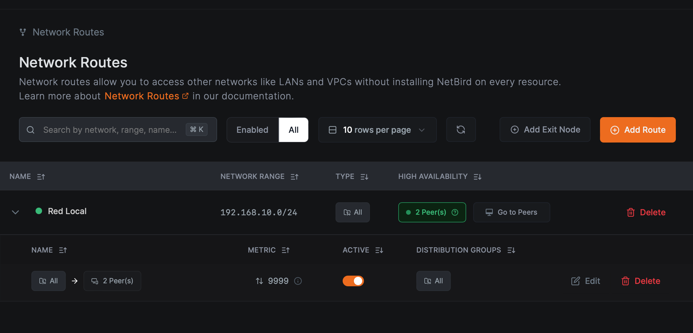

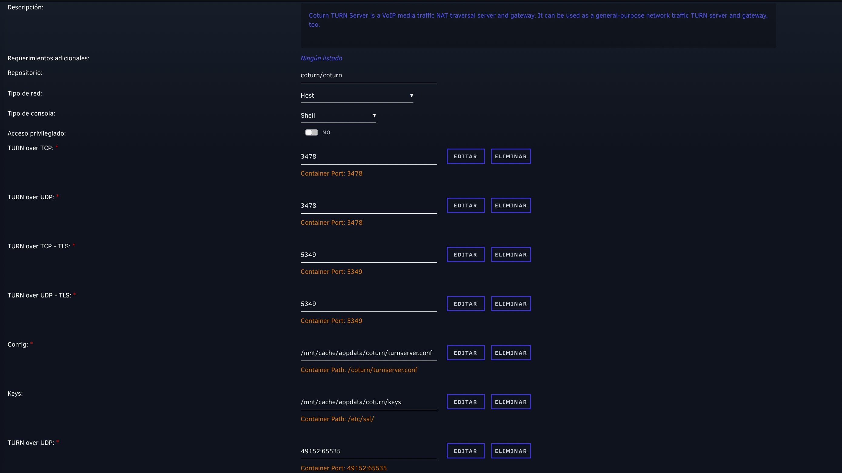

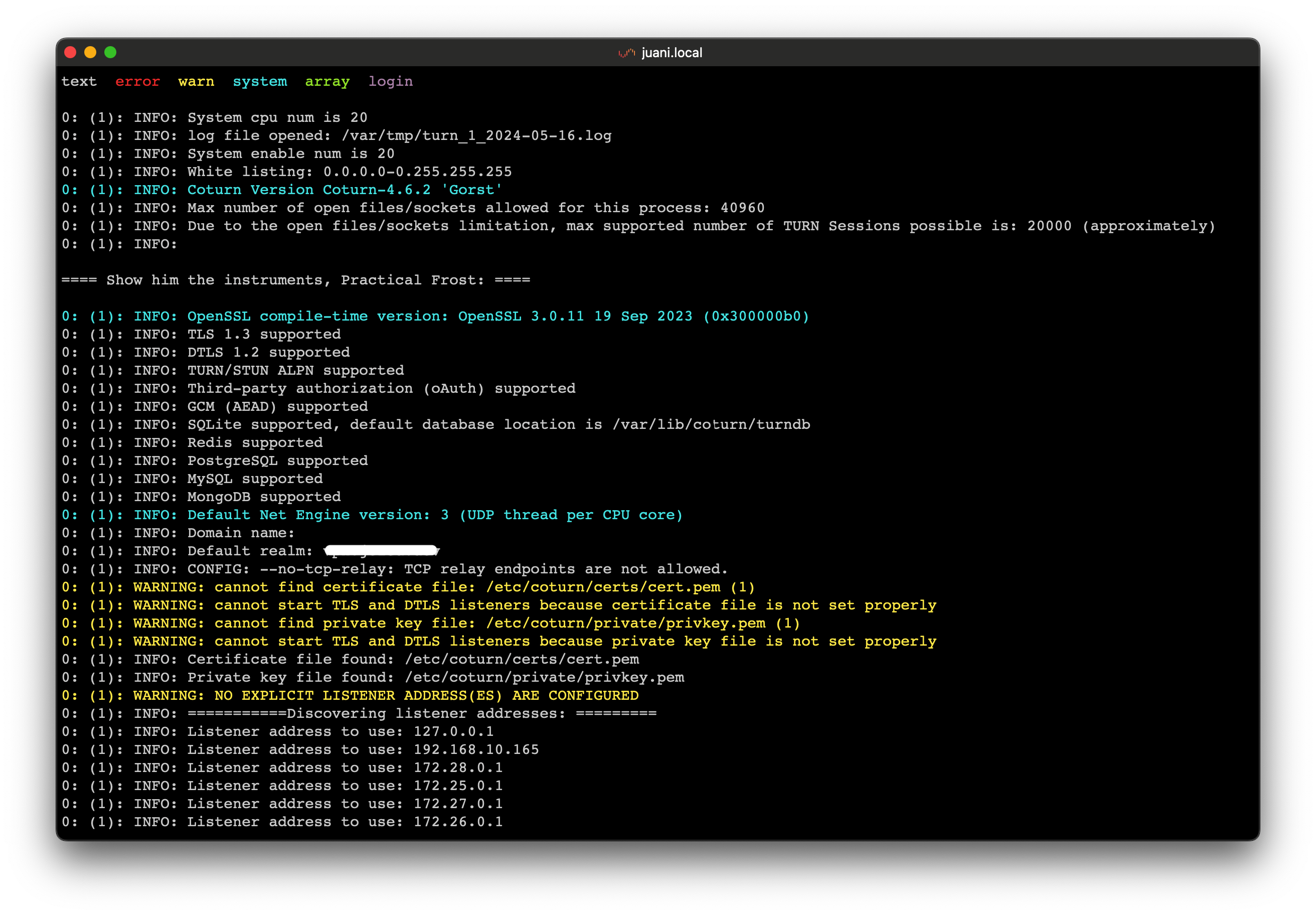

Another things, can you share your turnserver.conf please? mine gives error.
And.. Can you access to your Local Network? I can't. Can you try?
Capturadepantalla2024-05-15alas1_49_39.thumb.png.d13de87876a0bb4948978ef9e9f964bf.png
Capturadepantalla2024-05-15alas1_50_02.thumb.png.e2fab6806ad3285ca2dfd7bbe1550e96.png
Thanks for all!!
Edited by Juani
Thanks for all!!
You can see my example turnserver.conf here: https://github.com/dannymate/unraid-templates/blob/master/Conf Samples/Coturn/turnserver.conf.sample (line 252?). I think I mention it in my guide too.
I can access my local network using an exit node. In fact I've done it for two different networks. You may need to enable "masquerade". Edit: I would fix your turnserver first if it isn't working because it's also kinda used for routing. I vaguely remember having issues when my coturn server wasn't configured properly.
I'm not sure if this affects it but as of unraid 6.12 there's a little bit of extra config (Settings > NetworkSettings):
You need this to access the Unraid WebGUI through netbird dns (unraid.netbird.com for example). I don't include it because you technically need to do it every time you reboot and it's not great. But I'll put this here for posterity.
Edited by jimrummy101
I have added wt0 to Unraid. OK
I downloaded your turn.conf file, activated line 252 and generated a password, OK.
Then in line 625 I put: allowed-peer-ip=192.168.10.0/24
Coturn container does not start. It gives error.
I have masquerade enabled but I cannot access my LAN with NetBird.
Maybe it's because of Coturn giving me error.
I don't know if in this picture everything is configured correctly.
When I first set up Coturn I followed this guide for Matrix Synapse server: https://element-hq.github.io/synapse/latest/setup/turn/coturn.html#configuration
I recommend following that, getting Coturn booting then making the Netbird modifications.
Your dashboard config looks fine. I would focus on getting Coturn working.

I got the Coturn docker to start. Attached is the Docker template and the Logs.
In whitelist I have added 0.0.0.0.0-255.255.255.255 to test that it approves all IP's.
It shows several errors in yellow.
I have tried to access to my LAN with NetBird and I can NOT access...
I have configured the turnserver.conf with your option 2 (user:test // password:test123).

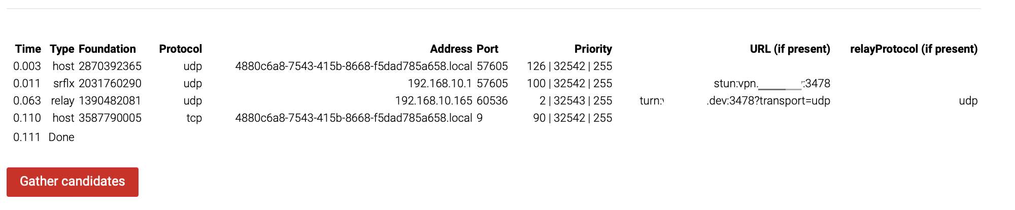

I have checked the TURN server on this site https://webrtc.github.io/samples/src/content/peerconnection/trickle-ice/ and it SEEMS to be working fine.

My NETBIRD conf.
I have added Netbird Client in Unraid. Inside my management panel I add it to have access to my Local Network 192.168.10.0/24 and to act as exit node.
With Exit Node enabled, I can NOT access the Internet or LAN.
With Exit Node off, I CAN access the Internet but NOT LAN.
In the "All" group there is the Peer Netbird Client and my iPhone. In no case can I access the rest of the LAN. From the iPhone I try to access my UNRAID (192.168.10.165) and it does not access.
Capturadepantalla2024-05-16alas1_52_33.thumb.png.91727a17baeffa38bb045043043f0271.png

20 hours ago, Juani said:
Ok!
I attach my current "management.json" with the data entered from my TURN.
"Secret": "secret", is as it is in the file. I don't know if anything needs to be specified in Secret.
I think you can probably get rid of the Secret line if you're not using it. Otherwise I'm honestly not sure. I'm not a Coturn expert sadly, I got mine working as I mentioned in the guide and in a previous comment. I wouldn't recommend using the Unraid WebGUI as a test as it can be finicky. Though if you're not getting internet at all that's not a great sign. It does seem to me that it's a Coturn configuration/management.json issue though. It may be worth checking the logs of the NetBird-Management container in case there's anything obvious that can give you an idea of what's causing the issue or possibly following a guide for Coturn configuration instead.
The NetBird docs are pretty good but they don't go in on explaining what each variable does in the management.json so it's hard to figure that all out.
It works now! The problem was the turnserver.conf.
I can access my LAN and the Internet. Without the need to use an EXIT NODE 👌
