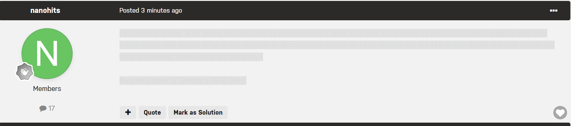

Your post is completely unreadable in light mode. Please don't color background or fonts. Try again.
I have never colored or or used any different fonts. THis is how it looks for me:
https://d.pr/i/TgdqYy
I have edited it in non dark mode. Should be ok now?
Edited by nanohits
Just now, trurl said:
This is how it looks to me
I have corrected it in light mode. This must be a bug in their forum software as I just added the post and hit the post button without making any changes to color.
