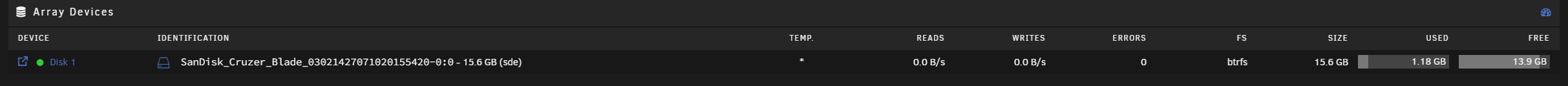

You need some storage for dockers/VMs, and you can create pools as needed for this purpose. A single data disk in the array is required to start, but it doesn't have to be used at all and a USB flash drive could be used for that.

As trurl said just use a small USB for disk1. I do this for one of my dev machines

You can assign disks to the array without any parity or other pools.

What would you remove from Unraid? You have to have storage for the things you want to do. An array without parity can be that storage, and you have the webUI with container and VM support.
You don't even have to look at the Main page with the disks if you don't need to. Management Settings lets you specify a Start page. I always start at the Dashboard.
