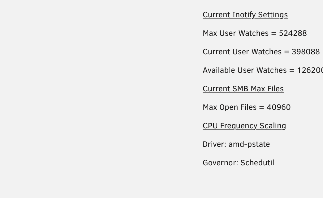

February 27, 20242 yr On 2/5/2023 at 5:13 PM, lory995 said: Actually i did already enable all of that at the time you wrote here, but i wanted really go through and try this driver so i stopped and started looking around to try and understand really what i was doing. I read a lot of guides on linux kernel modules and how did they work. And of course, as usually happens when you have some resemblance of understanding of what you are doing, i succeded. What i did instead is injecting them at boot. To do that i modified /boot/config/go adding *before everything* except for #!/bin/bash ( so right under it ) modprobe amd_pstate [....]/emhttp was after the line written above, for example. Then i created 2 .conf files in /etc/modprobe.d one for blacklisting acpi_cpufreq(1) and one for enabling pstate(2): (1) i created it with " nano /etc/modprobe.d/acpifreqdisable.conf " blacklist acpi_cpufreq (2) i created it with "nano /etc/modprobe.d/enableamdpstate.conf" options amd_pstate shared_mem=1 and left /boot/syslinux/syslinux.cfg as link in my first post. Now it works. P.S: @Iker i've got it up an running the 26 or 27th of january and have yet to note any instability whatsoever fortunately. Maybe since you tried them the drivers got updated? Awesome you got it working. Apart from what you did, do we have to actually install anything beforehand? Also, are you still running your build this way? How has it fared?
February 27, 20242 yr Author No, from what i remember nothing is necessary except for what it's written in this guide ( and in the iker one ). I'd suggest you to start with the method used by Iker first since it should work ( as i've written above i've replicated the exact same steps but sort of manually ). As for the second question, unfortunately no. As i've written in my previous posts my server now has expanded in functionalities, it's central to lots of services i regularly use and, most importantly, i have not time to tinker with it like i had before so i'm much more conservative. I turned back to acpi because i had a problem with updating the unraidOS and since i didn't have much time at my disposal then i simply decided to reverse most of my previous tinkering and experiments trying to solve the issue ( i didn't in the end and i had to use a workaround, but it means that it wasn't amd-pstate fault ). Since then i never ended up setting it up again for the reason above. Anyway when i used it i had no problems at all and was actually using like 10% less power than before. ( i don't remember the exact figure, could be 15% ). Other factors to consider are that i have a 3900X which it's quite old and i remember that while was looking for answers at the time i discovered that -not surprisingly- the 5xxx and even more the 7xxx are much better both in idle and in power saving function unlocked by the pstate ( 'cause infinity fabric optimization which is the main culprit for high idle consumption ). Moreover the pstate module itself received quite a lot of updates in the kernel so it'll surely be better than when i tried it. To sum this up: i advice you to try it, it's quite easy after all and you may be in for some nice surprises. If you do please find some time to report back in this post, if you have nice results maybe i'll set it up again! Edited February 27, 20242 yr by lory995
