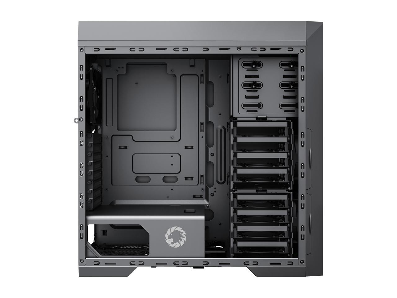

So...I'm moving my build, to a Gamemax Silent Titan. I don't know shizz, about power-supplies. My old case (Norco RPC-2212), was easy: just a 1u Server unit. But I'm not sure what do here; given the size limitation of the PSU area
I need power, for (10) SATA. Obviously, that's not a tall order https://pangoly.com/en/hardware/psu/sata-connectors/10
Those just don't look like they fit?

Why do you think that ?
The PSU shroud seem quite long. More than enough to fit with all the cables.
I think that most PSUs would fit in the cut-out section of the shroud.

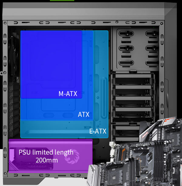

According to the product page on the Gamemax website, the case will accommodate ATX PSU up to 200mm length so as long as the PSU you get is shorter than that, it should fit.
"Why do you think that?"
Because I don't shizz, about PSUs 😁😔
"According to the product page on the Gamemax website, the case will accommodate ATX PSU up to 200mm length so as long as the PSU you get is shorter than that, it should fit."
Yeah; I looked at that exact pic. While the length is outlined...and easy enough to check specs, and make sure you don't exceed; it was the width that concerned me. Those PSUs, just look so "square", and bulky; and "bigger" than what would fir in that "shroud". Glad to know it should be easy enough.

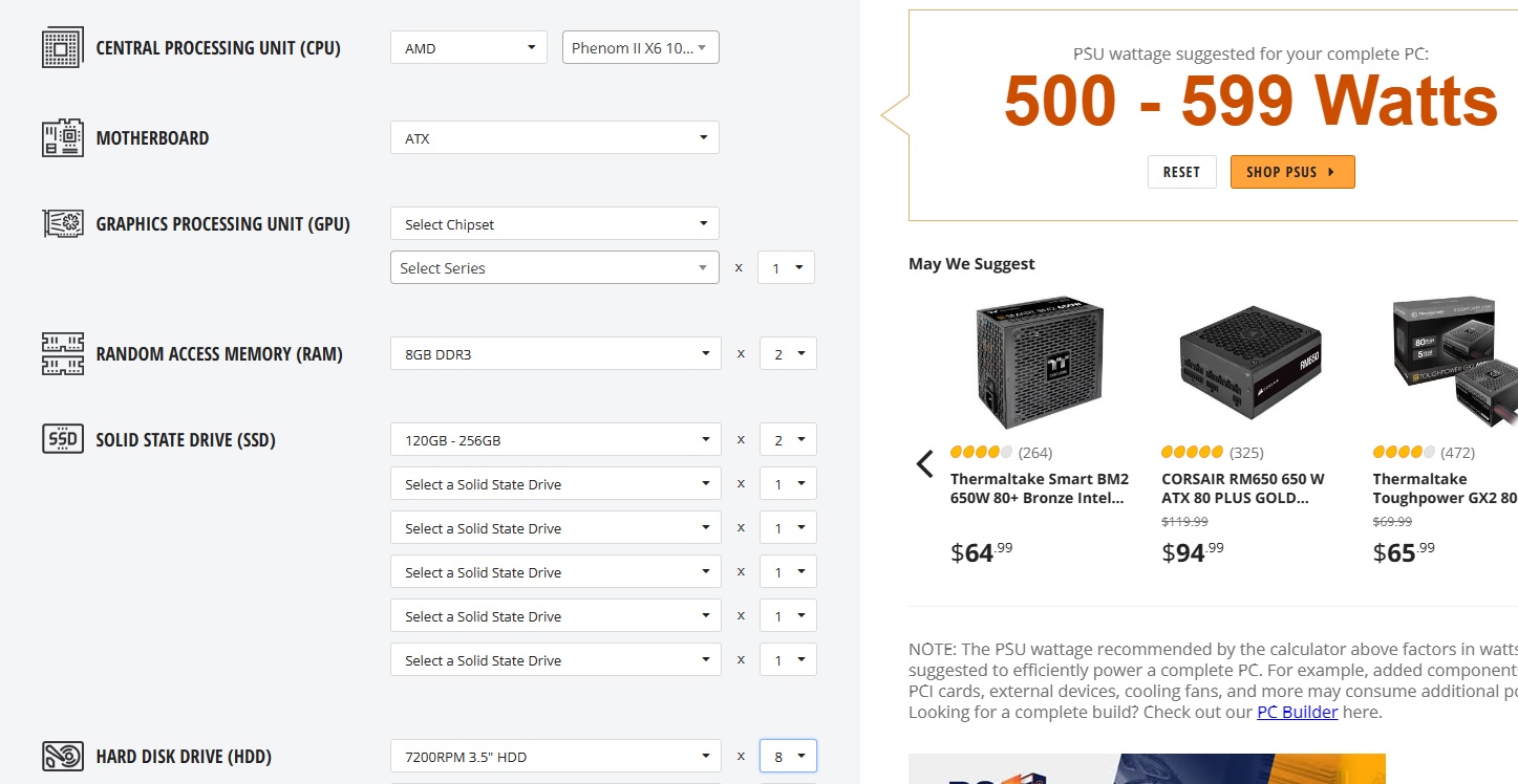

So...NewEgg PSU calculator, says I only "need"...around 600W

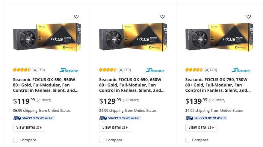

I guess I'm looking at these (3) SeaSonic. 750 is only ~$18 more, than the 550. No brainer?

ATX PSU's have a standard width and height (150mm x 86mm), it's only the depth/length of them that varies. Historically, most ATX PSU's are around 140mm in length, but in recent years longer PSU's have become more common with higher power demands.

Do you have any other hardware other than what is listed in your screenshot above (Phenom II, 2 x 8GB, 2 x SSD and 8 x HDD)? I've plugged that info into the OuterVision PSU calculator (https://outervision.com/power-supply-calculator) and that doesn't suggest anywhere near 600W. If you use that calculator, I'd recommend the Expert tab as it gives you plenty of options for all your devices.

^ Thank you gents. FTR...anyone have issue, with the SeaSonic FOCUS GX-750??
Edited by CDLehner
Solid model from a solid brand.
Seems to be no major issues and listed in the high-end A tier list.
Should be good.
