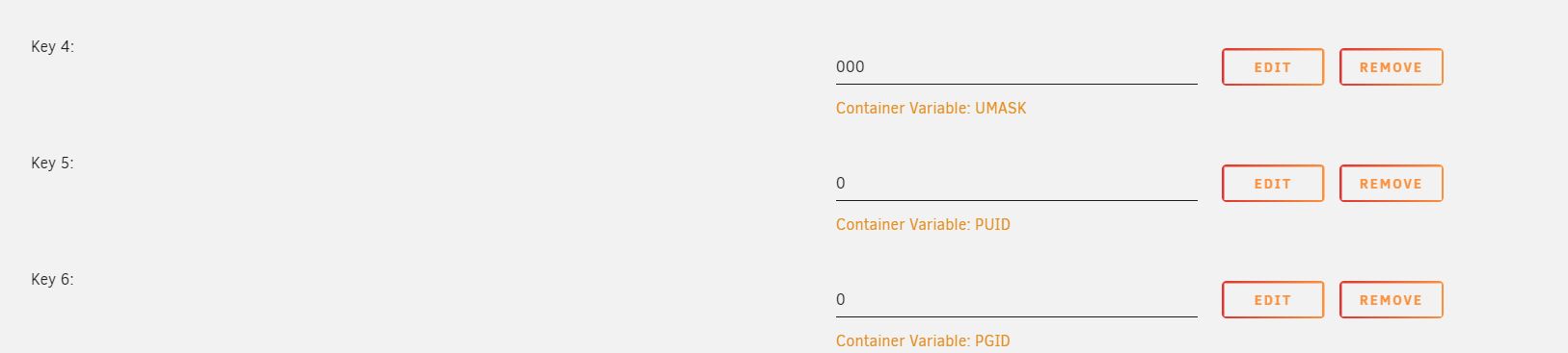

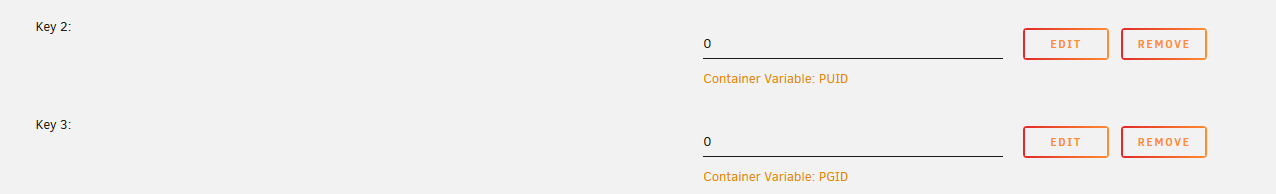

i did find the settings for PUID and PGID and changed to 0.
But it still seems like it will not go into root mode.

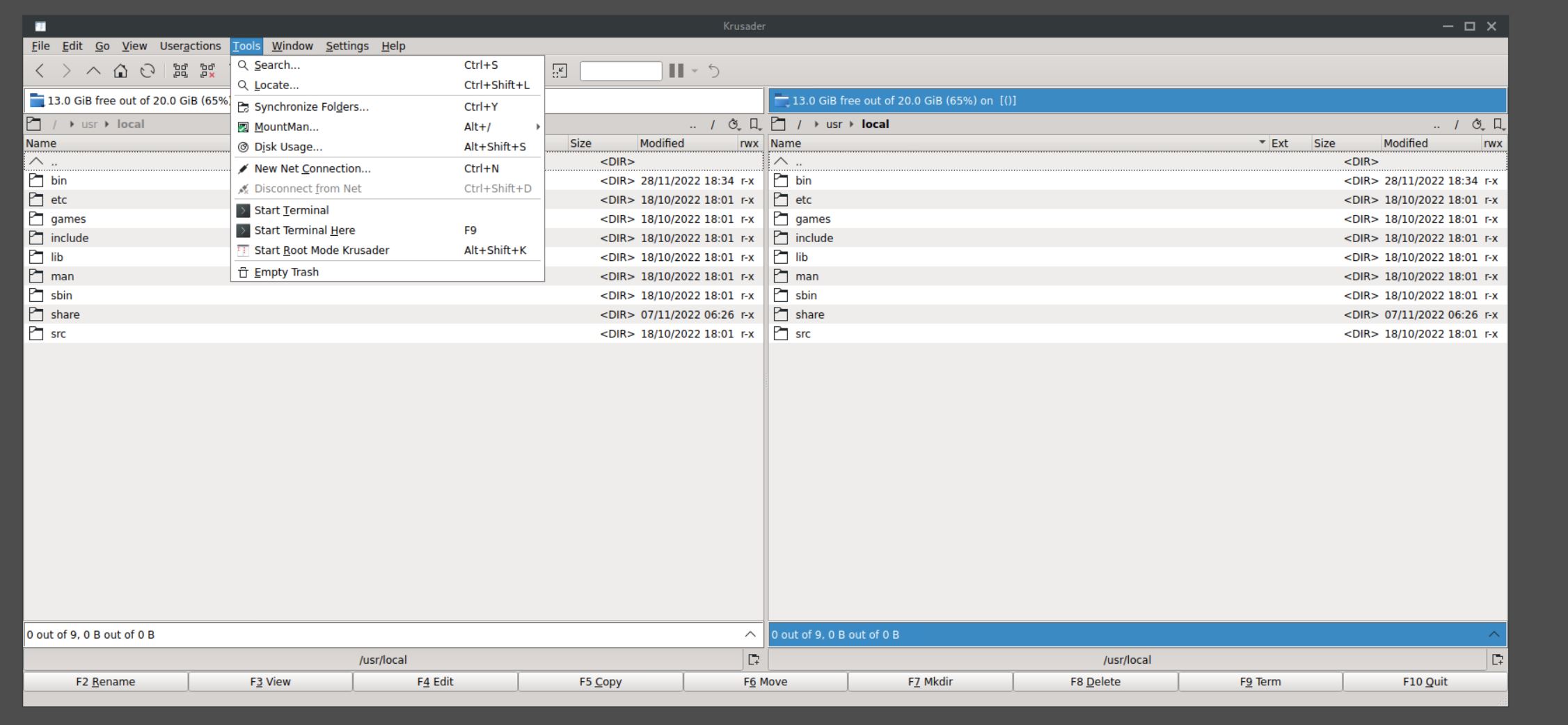

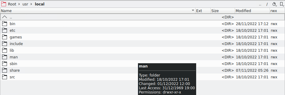

I just check using my binhex-krusader and I think I know the reason why.  When I went to in Krusader to /usr/loxal, I got this:
And when I used the GUI terminal and did a listing of the files with it, I go this:

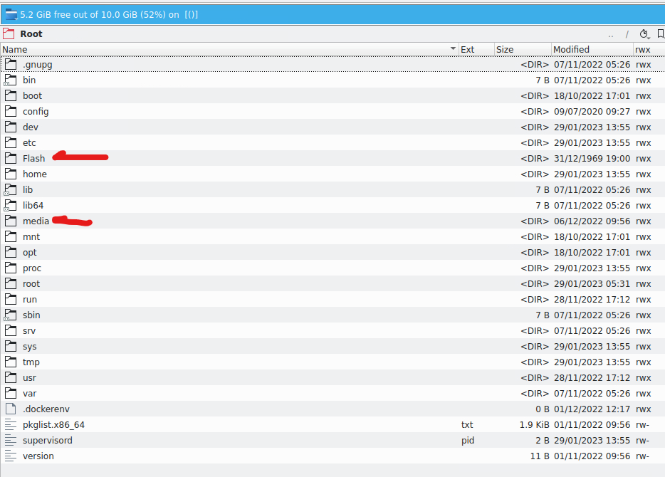

Notice that Krusader is missing   emhttp  directory and The GUI terminal is missing the  games   directory!   What krusader is showing is file structure for the Linux system that is running in the Docker container.  Here is what the root of Krusader Docker looks like:

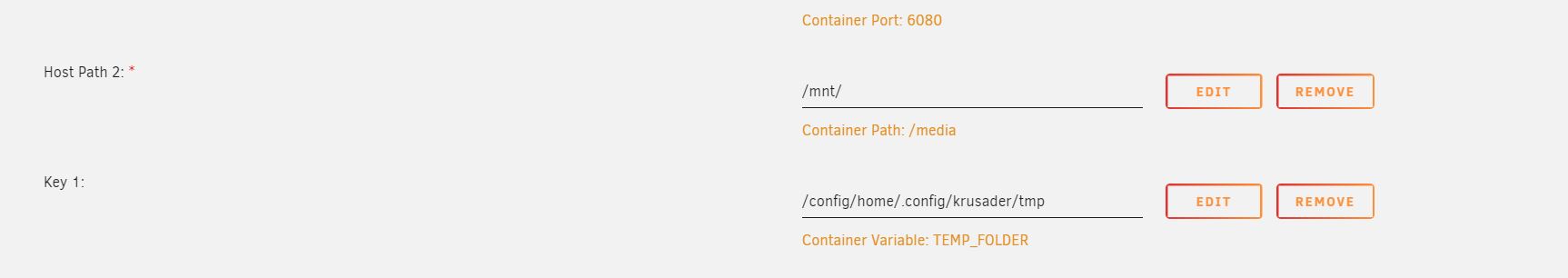

The two designated directories are actually the mount points for the file system on the Host system (Unraid OS)  that the Docker is running on.  Here is the command that mounts the  media directory (second one marked) onto the Krusader file system:
IF I remember correctly, this originally was   /mnt/user   but I also want access to the Disk Shares so I modified it.  I added the  Flash (first one marked)on because I want quick access to the Flash Drive because I often need a quick look at the boot drive contents when assisting on the forum.
You should now have enough information to mount the entire Unraid OS as a directory on the binhex-krusader by adding another Host Path.

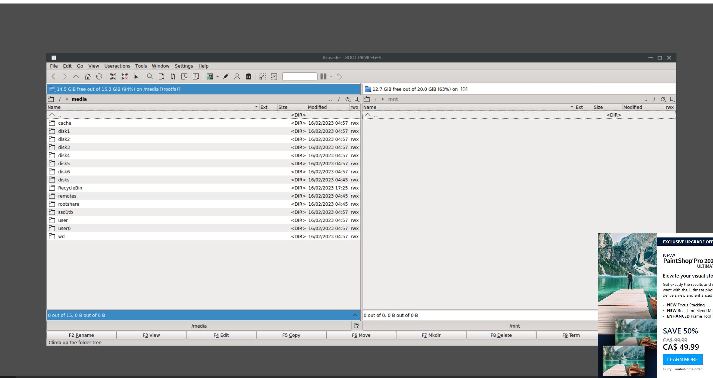

Still not working. I can now see the host folders and files, except for the Root folder.

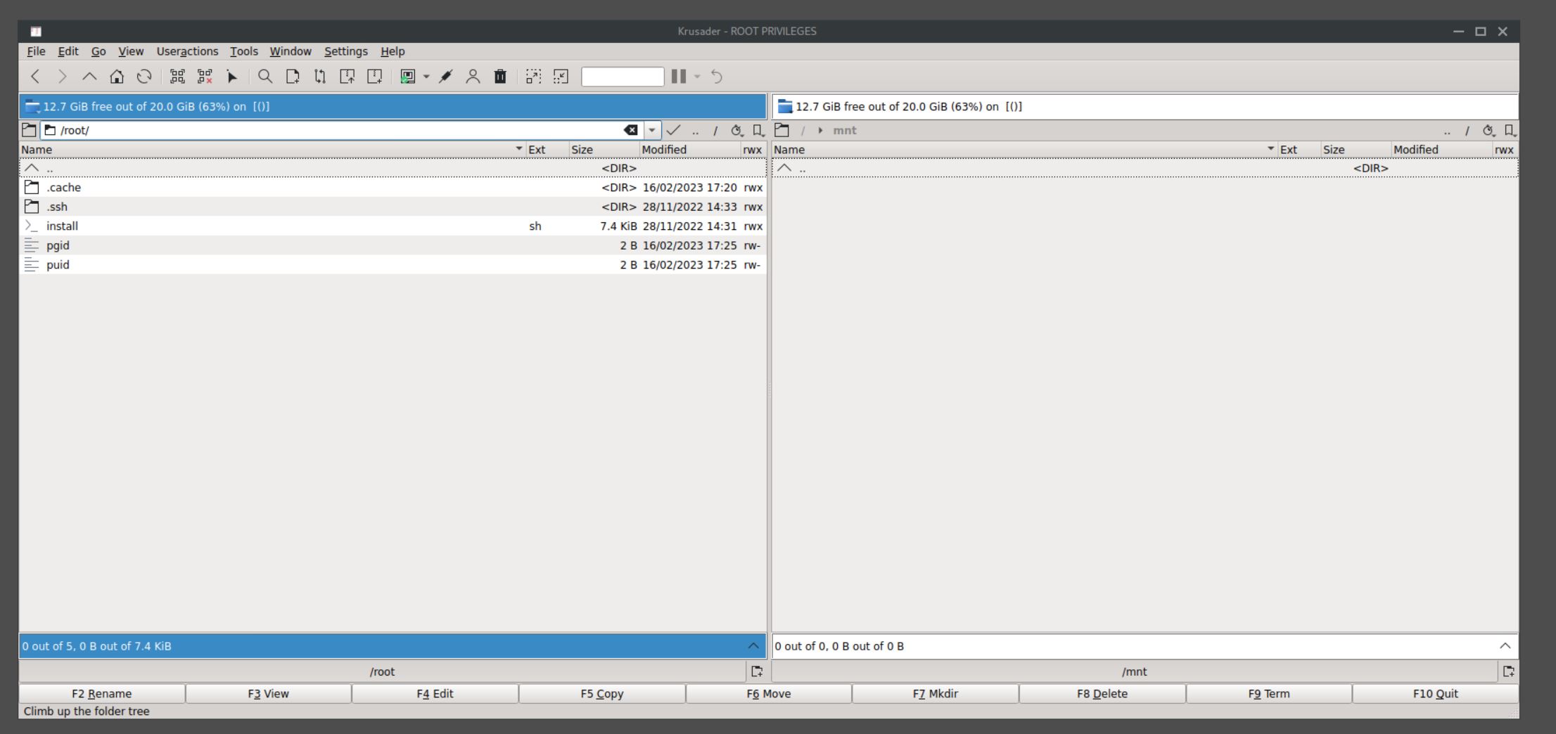

@Vetteman, What @trurl is trying to say ( and this is confusing),   the root of the file system is the    /     Directory (a single forward slash).  There is directory   /root     that is the home directory for the user 'root' (Superuser for Unraid) and this directory contains setup configuration for that user.  You appear to have map a host path to it.
1 hour ago, Vetteman said:

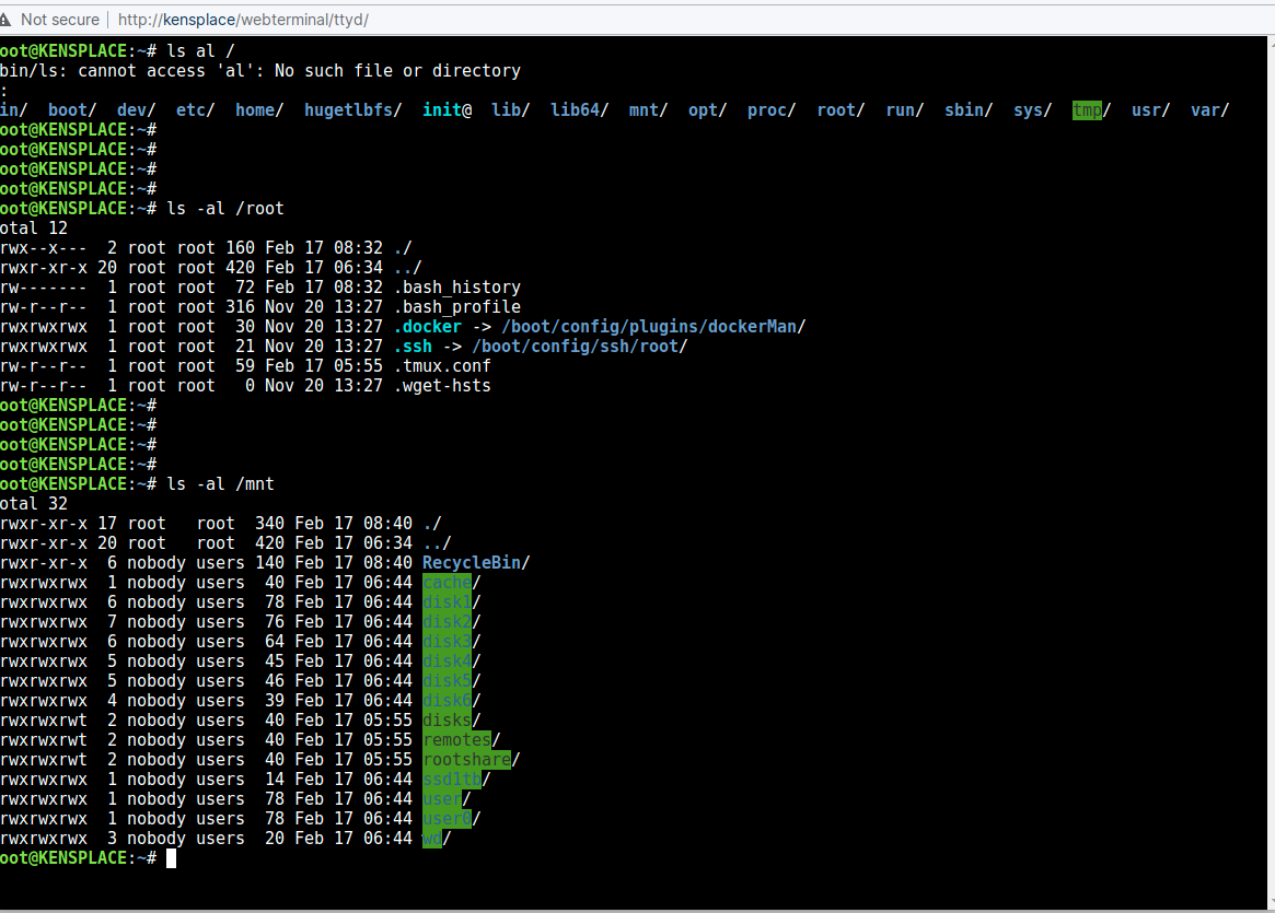

Open up a GUI Terminal [the     >_   icon on the taskbar] and enter the following three commands:
ls al /
ls -al /root
ls -al /mnt
Notice that the third one has the entries as your Host Path 2:  and the Container Path named '/Media' is mapped to   /mnt  on the Unraid file system.  Realize that the Docker container for Krusader is a Linux VM and you can map out of that VM to the Unraid OS file system.  (If you didn't map out of the Docker container, you would not be permitted to see anything on the Unraid file system!!!)
IF you want to have the root directory of Unraid available to Krusader, you  have  to setup a new Host Path XX:  that is mapped to   /  Then you will see what is displayed in the first of those three commands.  (You have just had a crash course intro to Linux.  And you are probably completely confused at this point...)    😏  🙄

Attached are the results from these three commands
ls al /
ls -al /root
ls -al /mnt
