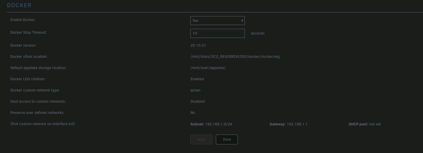

Are you still using macvlan with your dockers?

I've recently switch to ipvlan - I didn't notice a change for better or for worse after the change.
