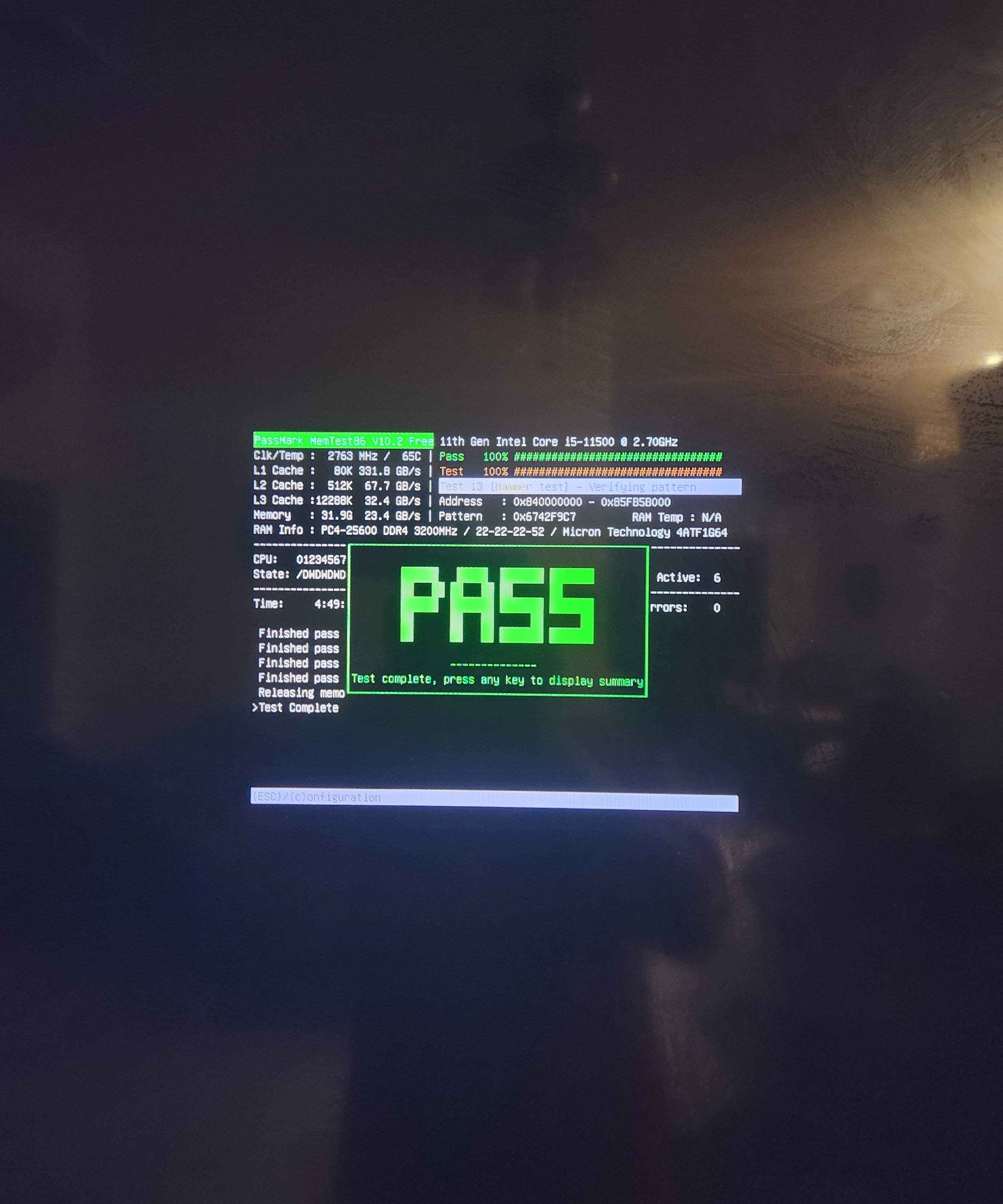

First thing would be to run memtest. Builtin memtest won't boot UEFI. Better if you download and boot into memtest86 anyway.
Thanks, doing this now.
it passed

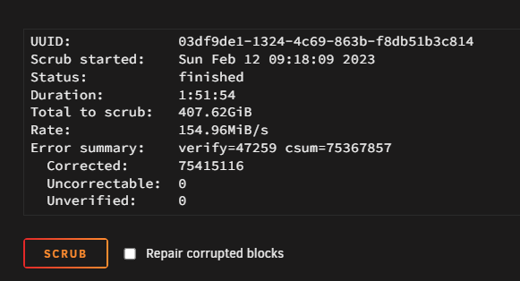

Filesystem stats show that both pool devices dropped offline in the past, possibly one at a time, it can still be a problem if the other one was not in sync from dropping before, run a correcting srub and post that output together with new diags.
You didn't post the scrub output, also log is full of errors for cache2, check/replace cables.

All errors were corrected so it should be OK for now, assuming no NOCOW shares exist, see here for more info and better pool monitoring.

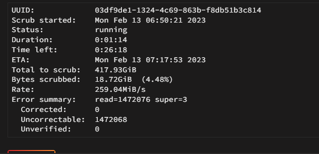

also notice that if I try and run the srub now it shows

Comparing both stats you can se the new write errors for sdg, meaning it dropped offline again between those times, if the scrub cannot correct all errors you need to backup what you can and restore the pool, but more importantly need to fix the device dropping issue, or there will be more issues in the future.
